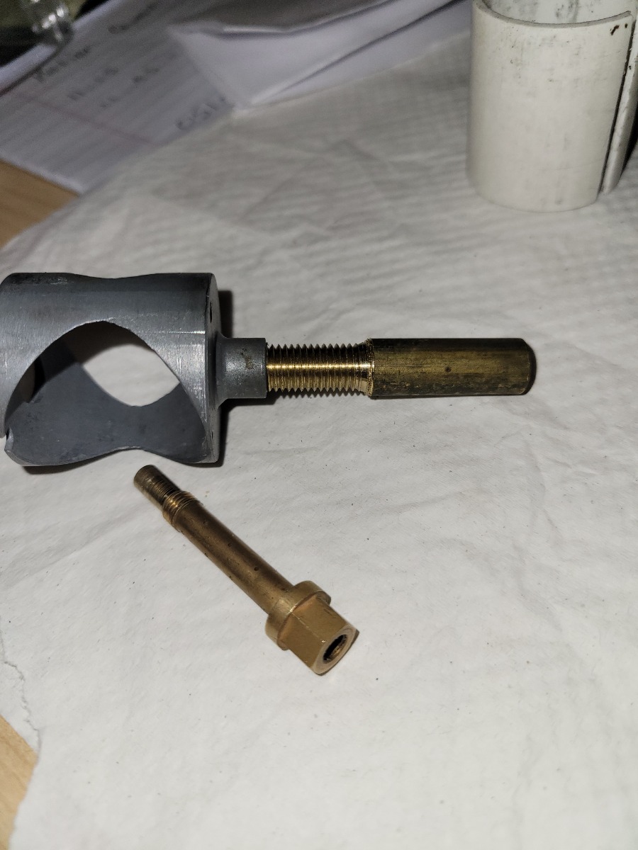

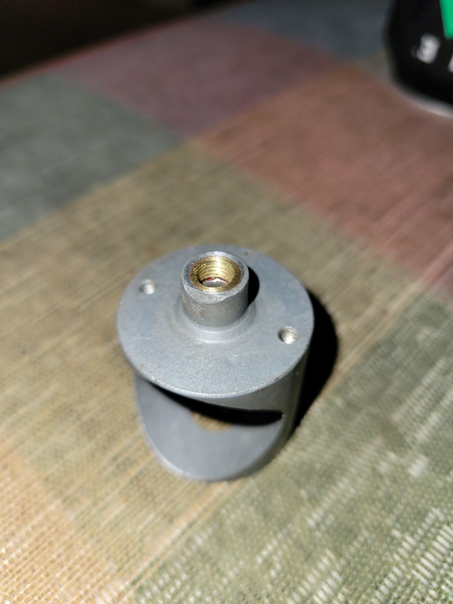

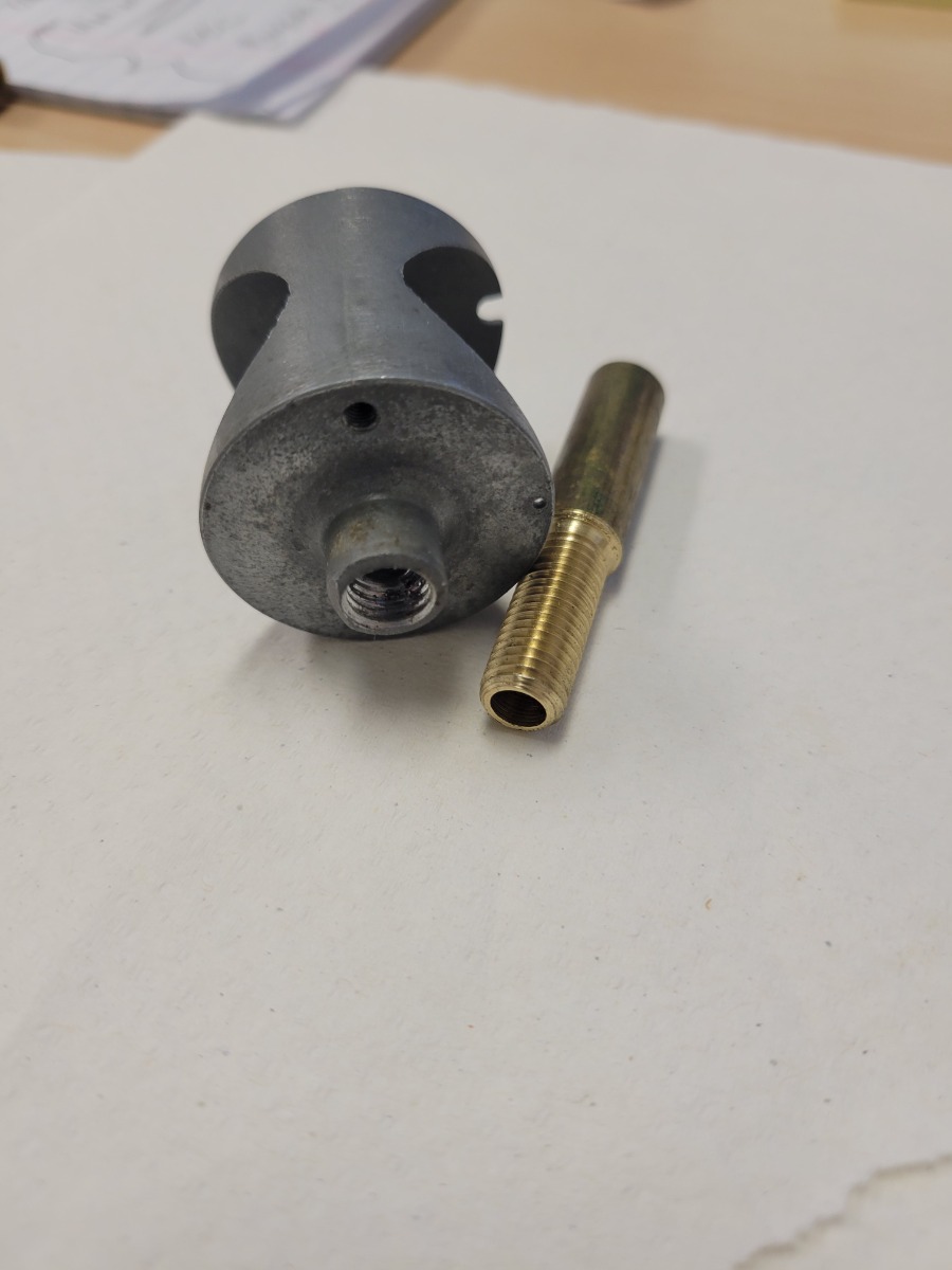

Speaking of stripped threads on a jet block. Here is a little repair I did on one...
(sorry for the sidebar)
The following user(s) said Thank You: slmjim+Z1BEBE, asphalt900, MFP-Joe, Gdizard, kimchella, HamFam

Superb ED, as always, wouldn't expect any less from Your crafty Wisdom!!
