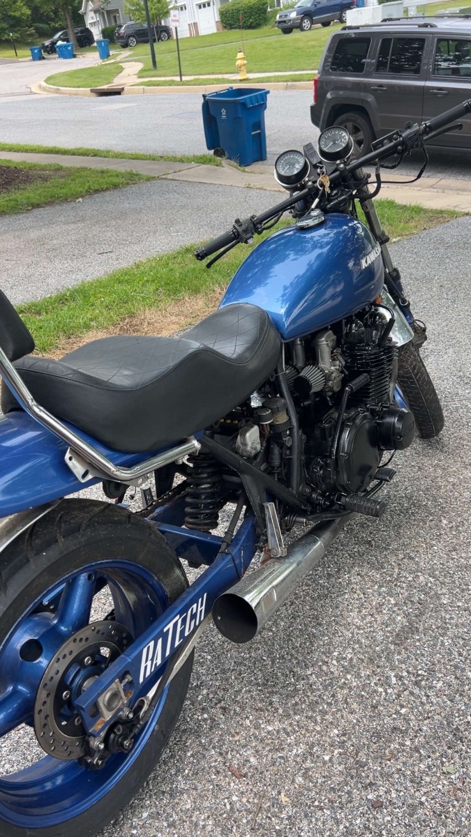

Yeah my distant father left it to me in his will and I really have zero idea what was done to it. I don’t actually have that many pictures of it put together haha

Yes...you have the worst case scenario for stock carbs. Pods AND open 4-1 header. As everyone has mentioned, pull those carbs again and record the #'s on the Main and Pilot jets and report back.

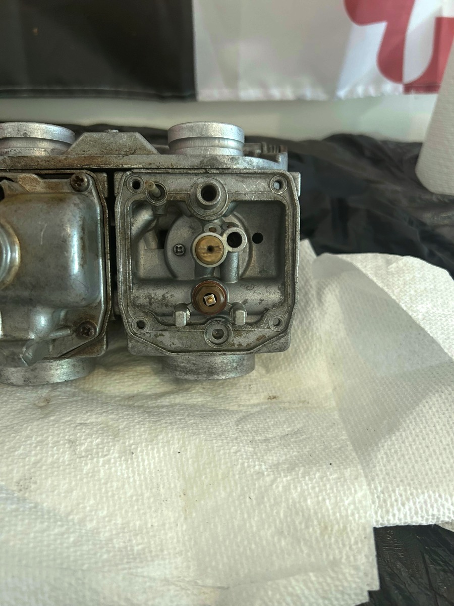

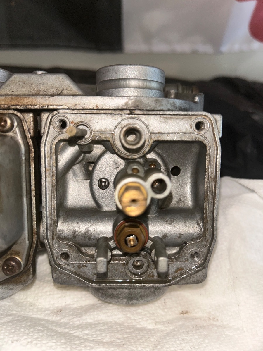

Those carbs are not stock, they are 29 Smoothbores. Note the little phillips screw on one side. The two sizes provided, 07.5 and 2.5. Probably look closer and there will be a one so 107.5 , need something like a 115-120 to begin with. The other 2.5 is the float seat, nothing needs to be altered on that. There's another jet in there too, the pilot jet. But if it starts/idles then you're ok. And don't remove that little phillips screw!! Sounds like you're not familiar with these and that little screw sets the slideblock.

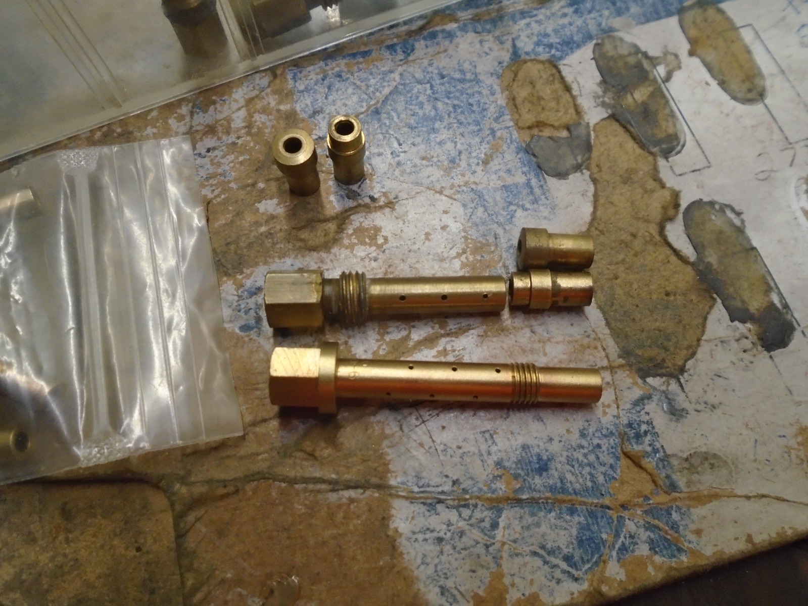

Noteworthy!! Don't over-tighten the Jet Holder or also called the emulsion tube. Its the 8mm socket brass that is holding the 107.5 main jet. Strip-out the slide/Jet block and you're screwed!! Looks like this, lower one in picture.
