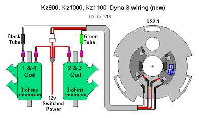

You could start by supplying a drawing of how you have it hooked up. One side of the coils are supplied with 12vdc and the other side should be hooked up to the triggers. The right side trigger should be for 1 and 4 cylinders. Not sure what you mean by grounding the surface of the coils. What coils are you using. Not familiar with the 650 but the 900 coil mounts are very close to the coil connections (Dyna coils)and can short. On Dyna coils connections can be positive or negative. How are you checking timing. Should be static with small light bulb.

You cannot have constant voltage applied to the coil primaries. The magnetic field created with alternating current does not occur with steady direct current. The field is required to induce high voltage on the secondary side of the coils. With direct current this is accomplished by switching the power on and off at the pickup. Normally the voltage at the pickup is zero but it jumps briefly as the engine rotates a tiny magnet past the pickup. Either your pickup is shorted or your connections at the coil are incorrect.
There should be a double brown spare connecter in your headlight. It's a hot wire and the one I normally use to connect the red wire from the Dyna. The other wires coming from the coils (red and yellow?) should be connected to their normal source.
