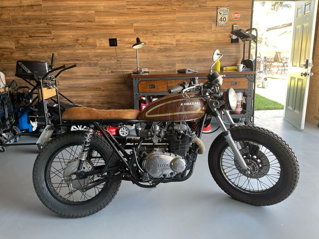

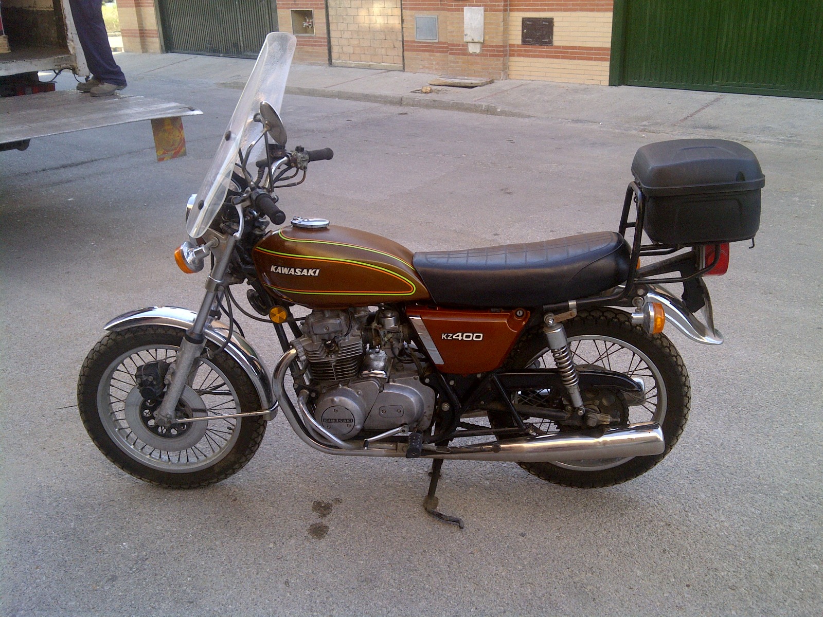

Hi Dave! Yes, you're right! My name is Mariano. I bought my KZ in Barcelona a few years ago, but we moved to California and I shipped it from BCN all the way to Los Angeles. I wasn’t able to use it due to registration issues, but now she’s ready to ride — except for this brake issue.If anyone in the forum can help me, it would be greatly appreciated.Thank you!
