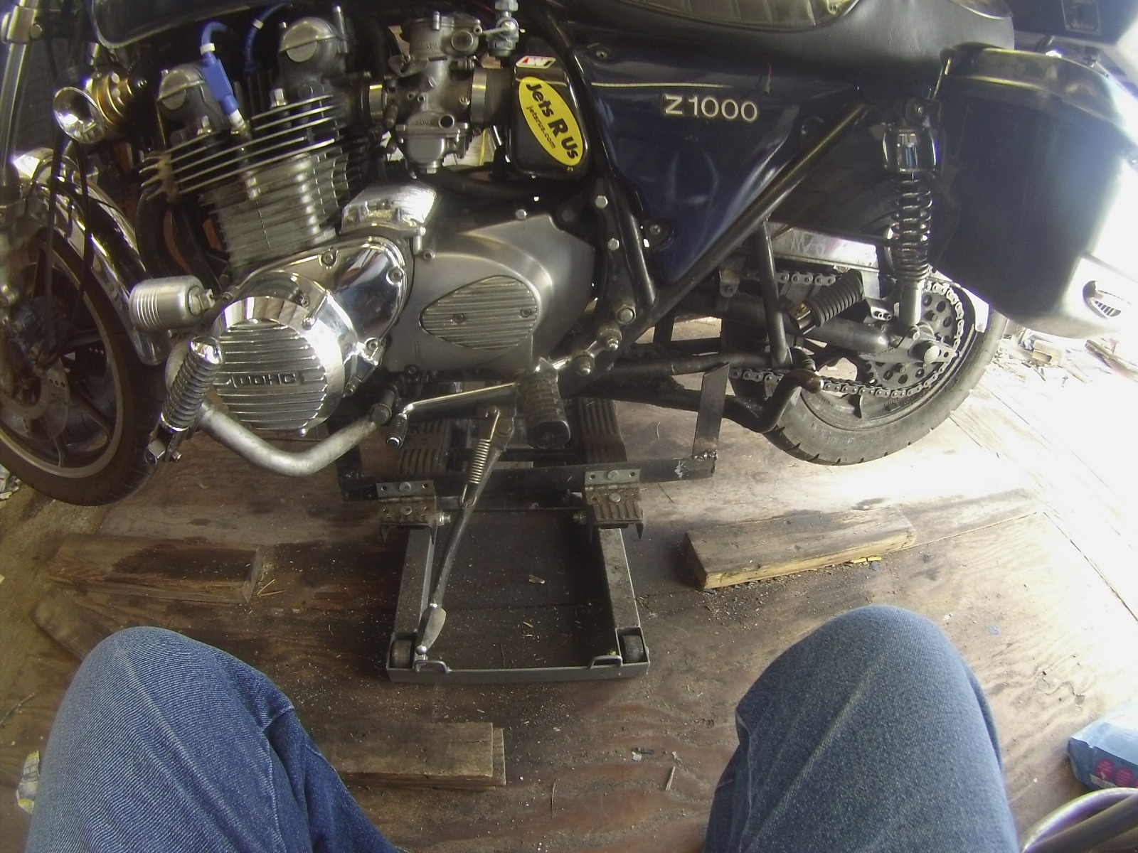

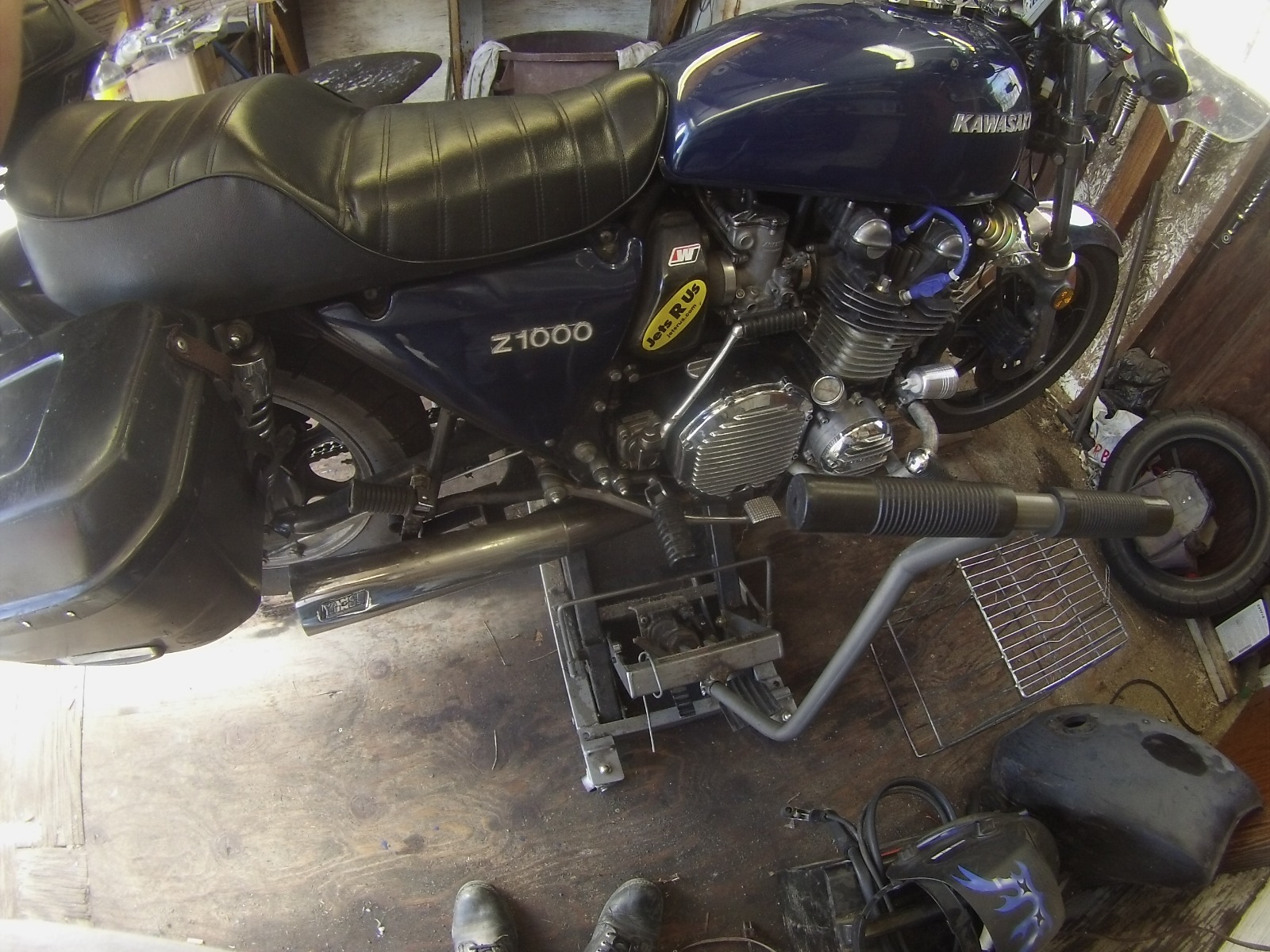

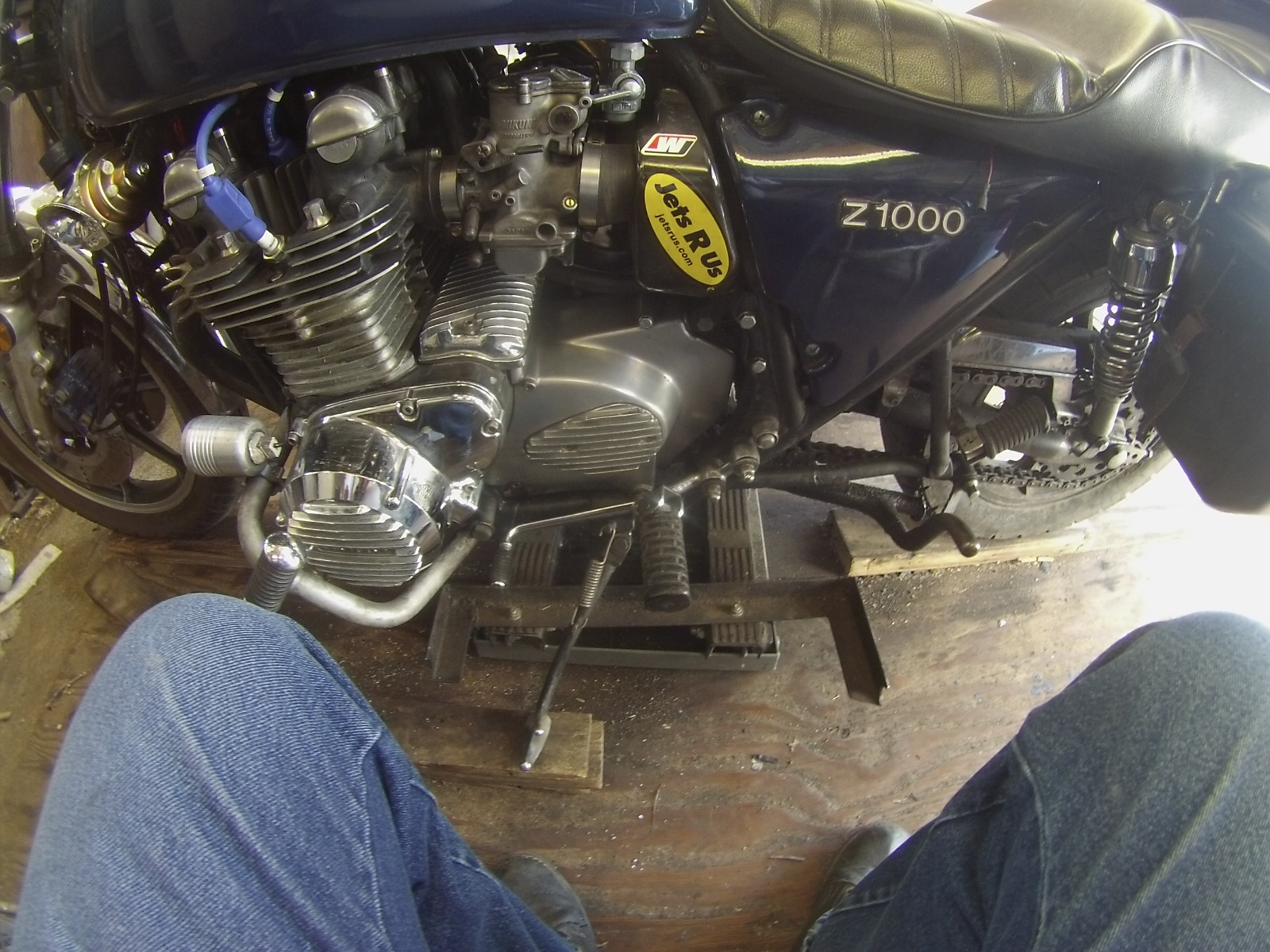

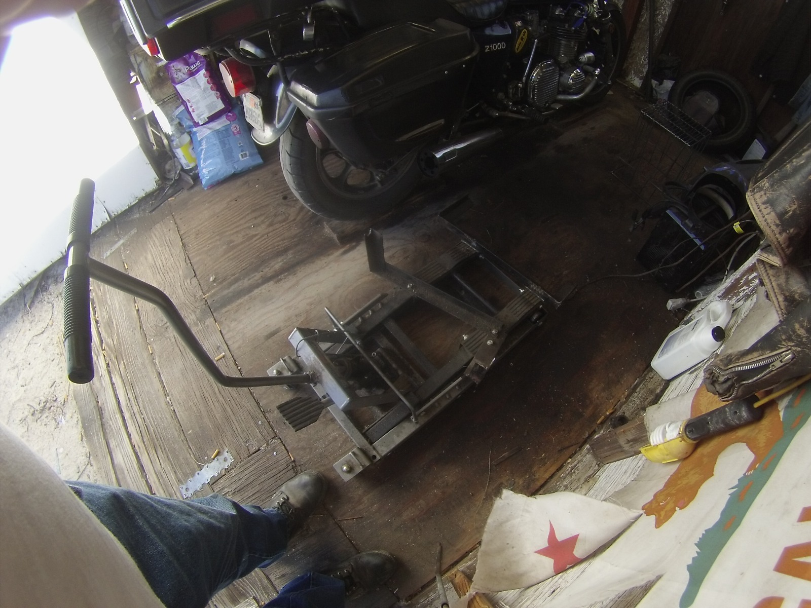

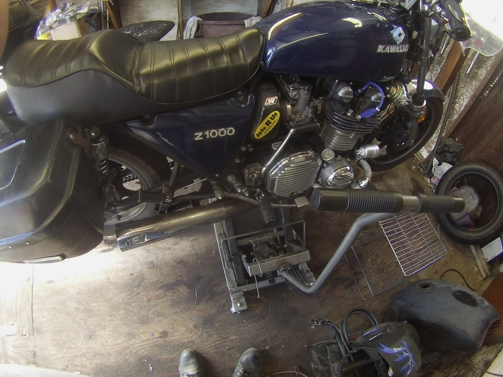

I had to make a jig to use my lift. I could have used a 4X4 block but then it would have been resting on the header and that wouldn't have worked very long. One side folds down to get under the bike then folds up to catch the frame on both sides. I jack up the lift and the left side catches it and the bike stands straight up on the lift. Only thing I can't do is take off the exhaust. It's trapped between the bike and the lift. I have to do that while it's standing free.

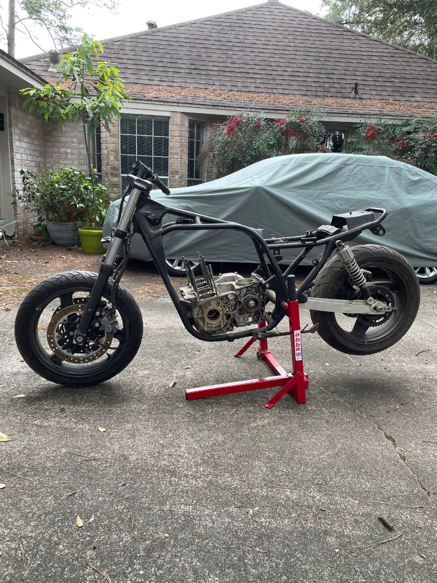

Hey Steve, does that Abba stand attach to the swing arm pivot?
Edit: looked at their web site and got my answer.

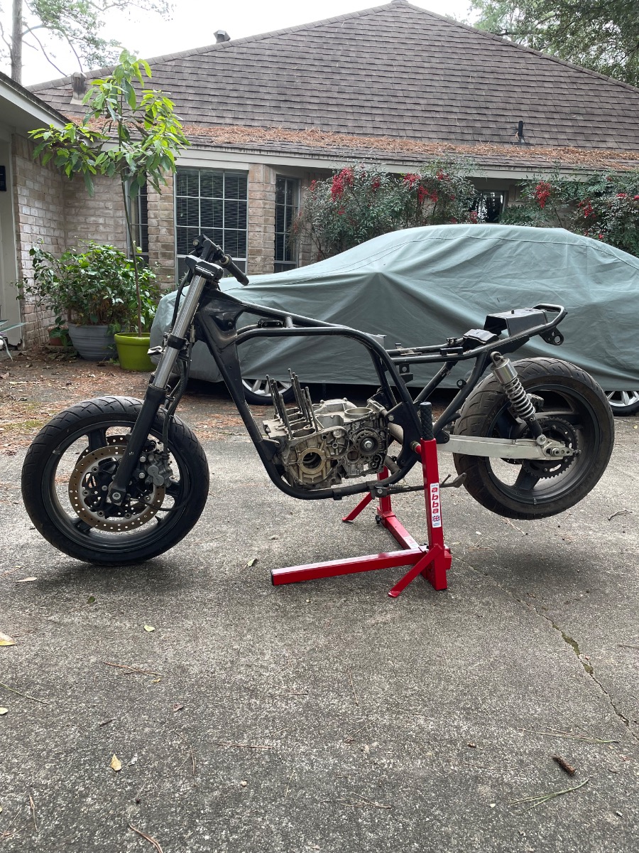

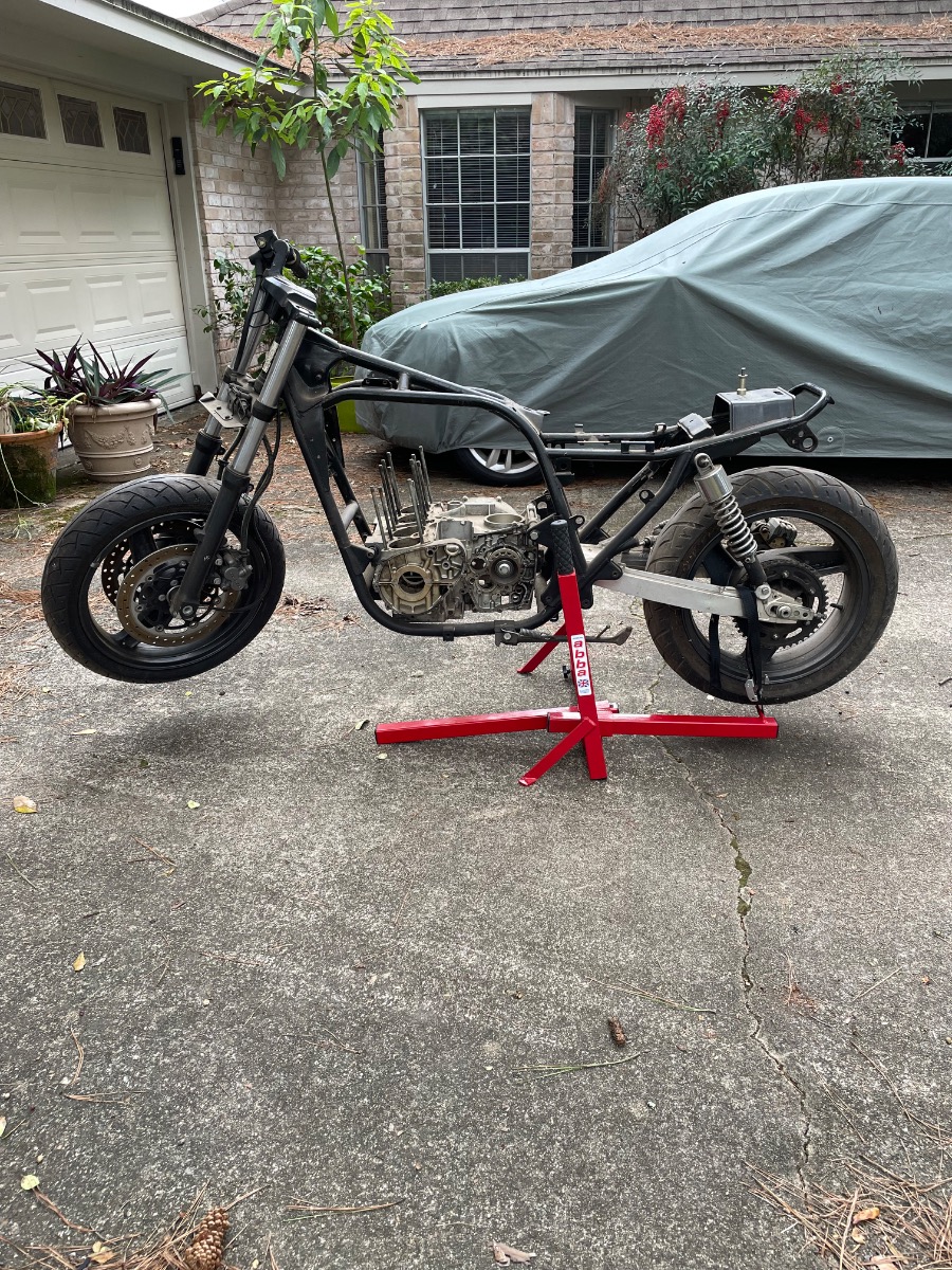

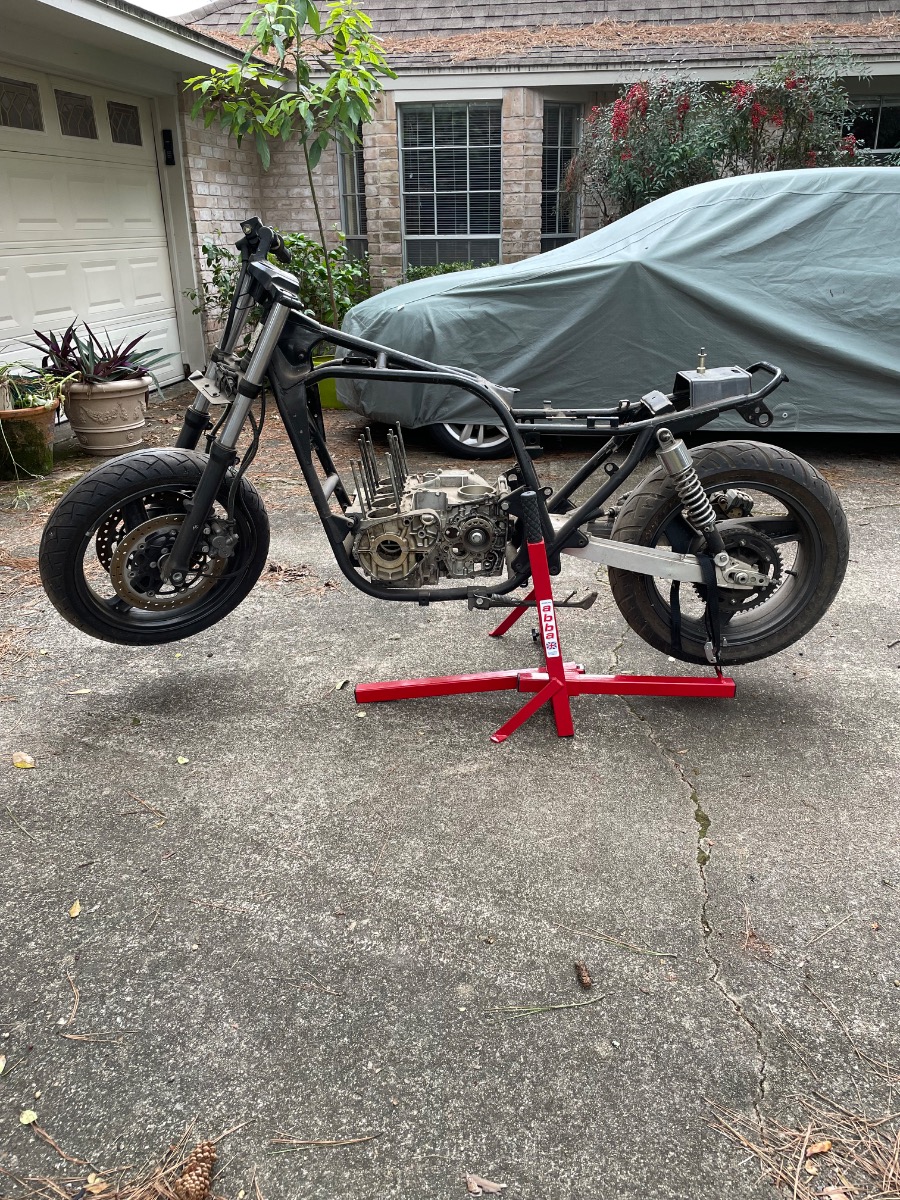

Yes. If they do not list the 1300, contact them. I bought it for my ZRX and then had them make up adaptors for the KZ. Really fast service and what I consider great pricing.
I opted for the extra kit to raise both wheels off the ground at the same time.
As you no doubt saw on their website, they also make one that will put the bike well off the ground. Higher than a lift table. You can get that one with wheels I believe so you can push it all over your shop.

That is very well planned and COOL.
I will try something similar with cradling the frame rails on the KZ1300
