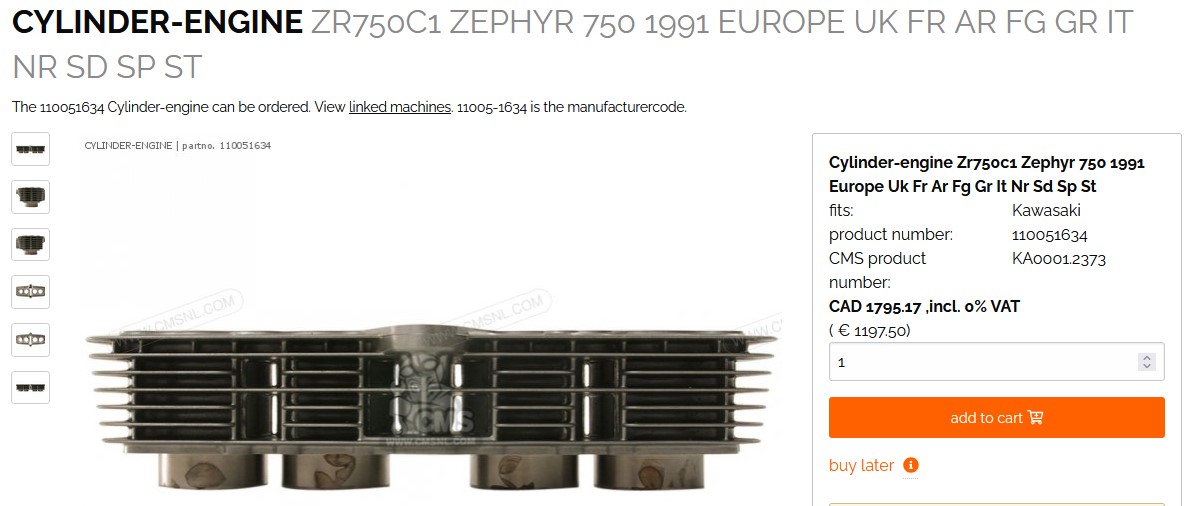

Kawasaki has never listed replacement liners, but you could by the whole cylinder. They still list that part as available but its stupid crazy money.
Not sure if the earlier 750 liners would be the exact same dimensions either. Better off to look for a good used cylinder at a parts breaker, even a damaged one will have one good liner if it comes to that.

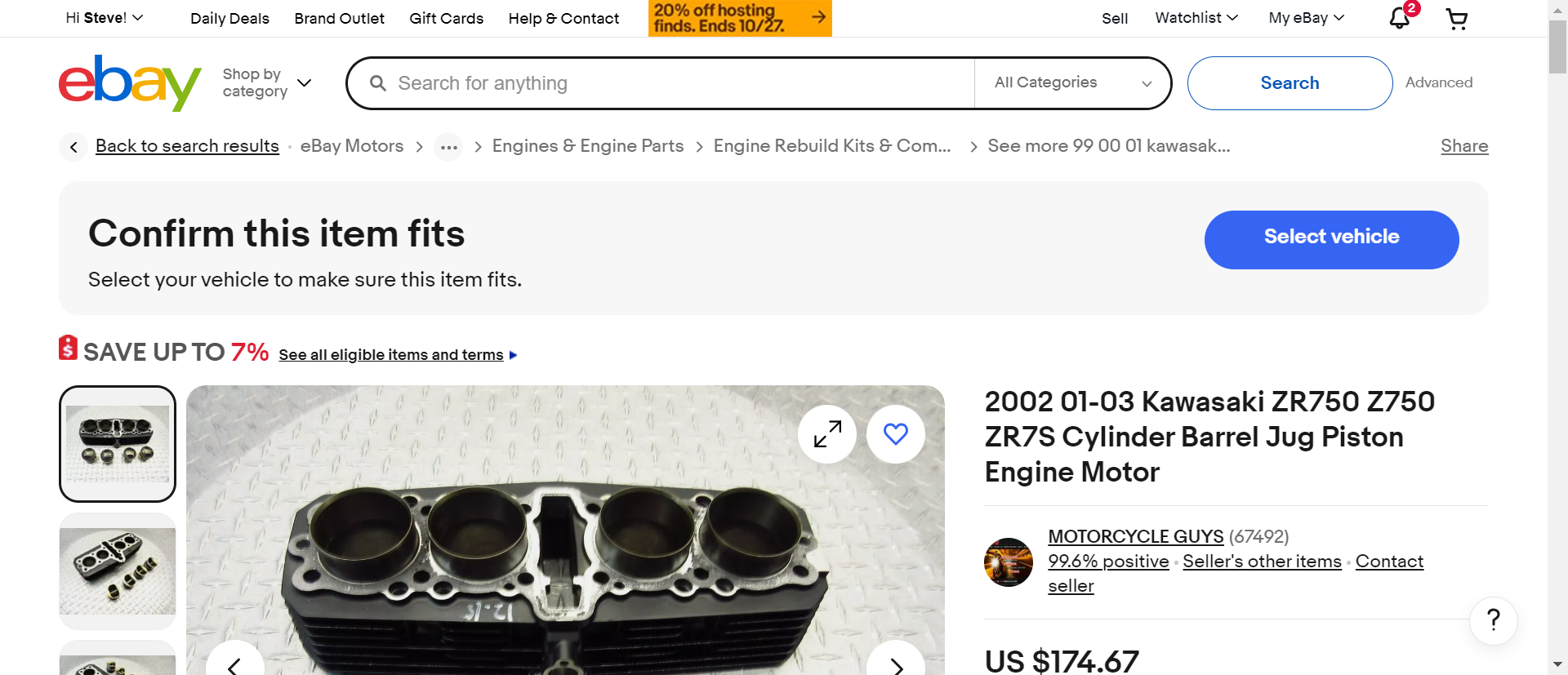

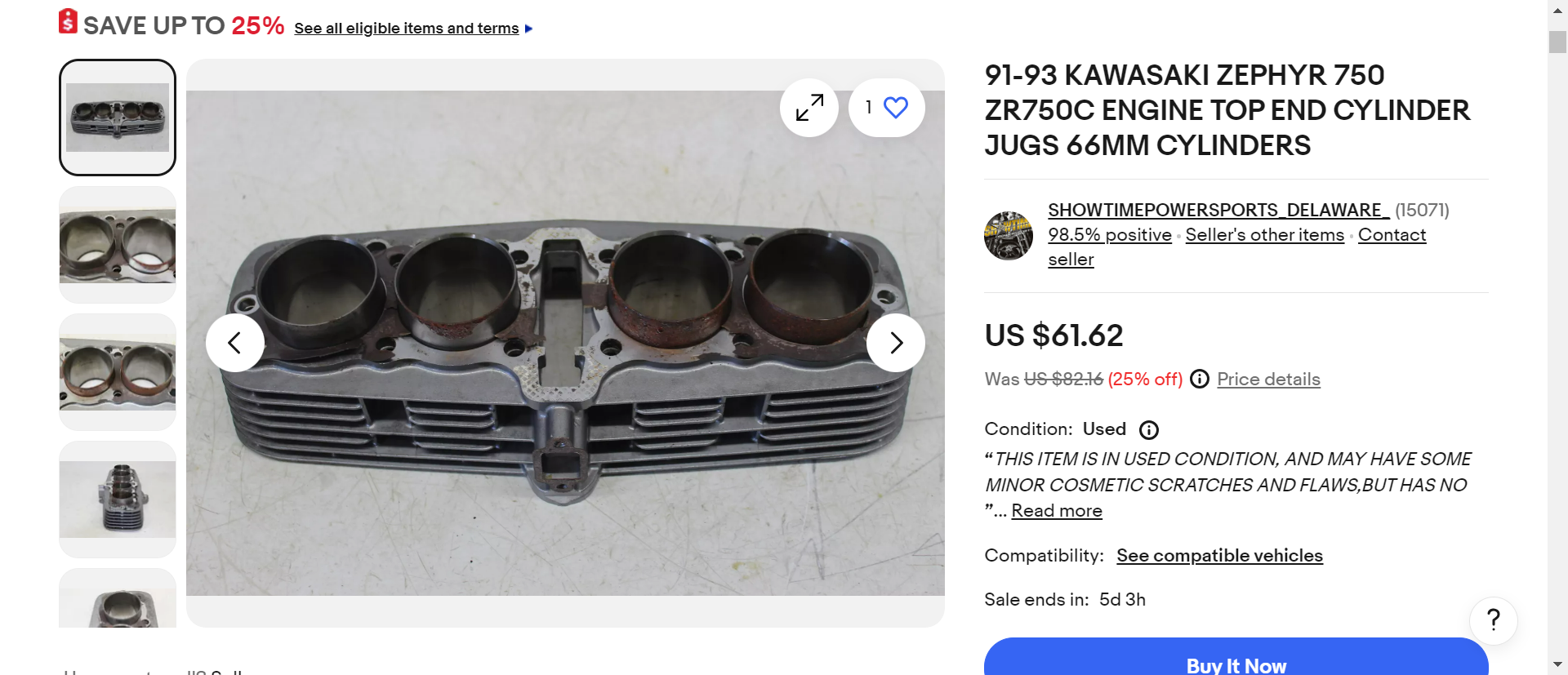

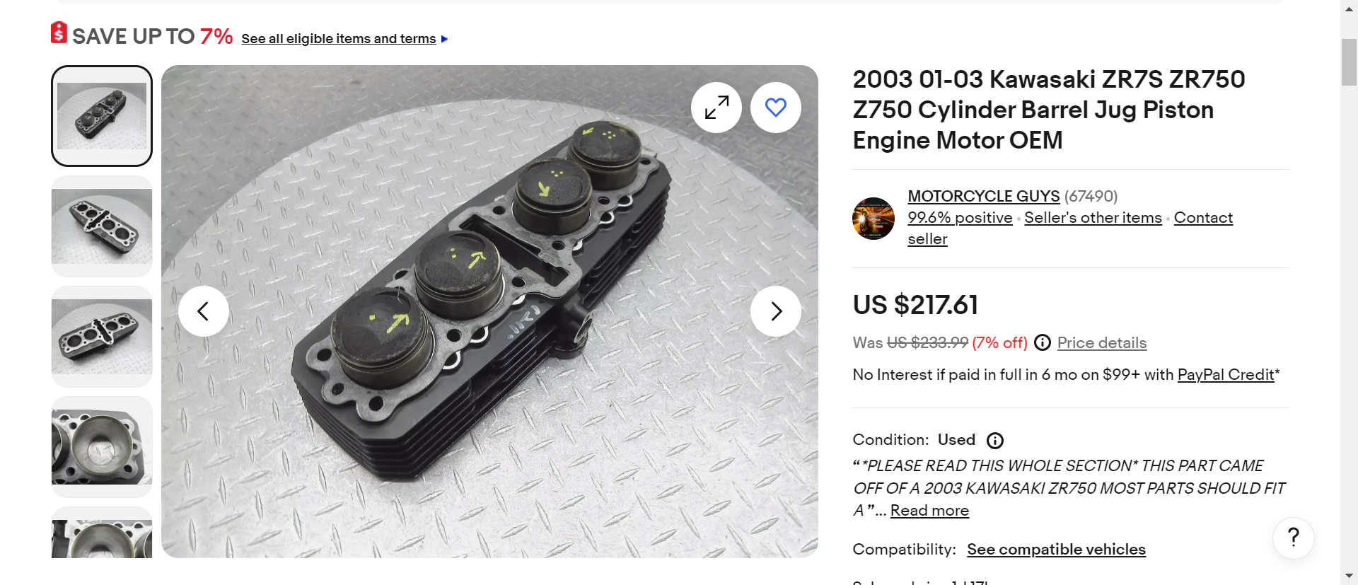

That's what I did. Had lower compression than before but the bike ran great until I was able to get the parts together to go higher compression pistons. One fin was broken so I repaired that. Sent my old barrels and had APE bore and match a 1075 kit I bought. Should have bought it from them. Would have saved $100 or more.
Quick search came up with these.
