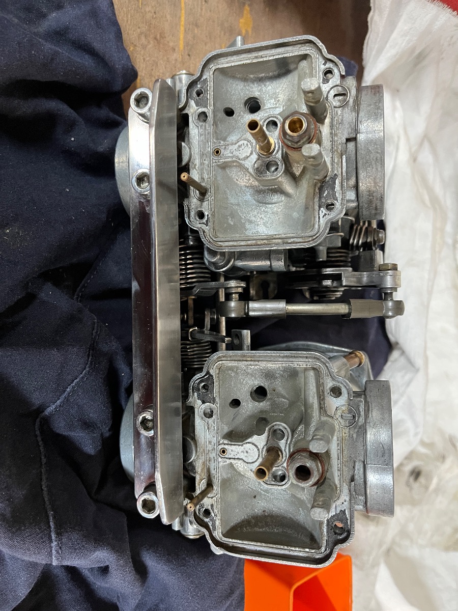

Update!

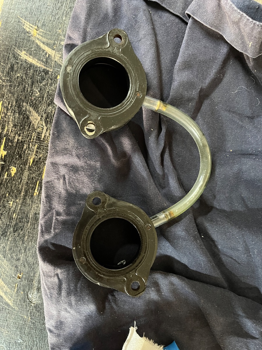

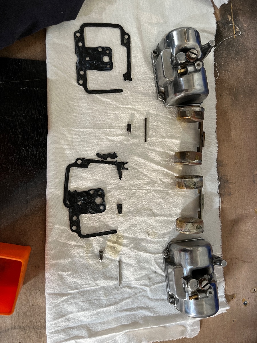

I reopened the carburettor and had a look again. And I think it is pretty good and clean. I will re-clean everything again with carb cleaner and with an ultrasonic cleaner. Im guessing that is is difficult to remove the brass valves and fittings from the carburettor and bowl. How would one clean them the best way? I will also buy new gaskets for the bowls.
I had a look at the diaphragm and pushing the carburettor cylinder up I can feel that is is "sucking" and opening up the carburettor top they are still intact.

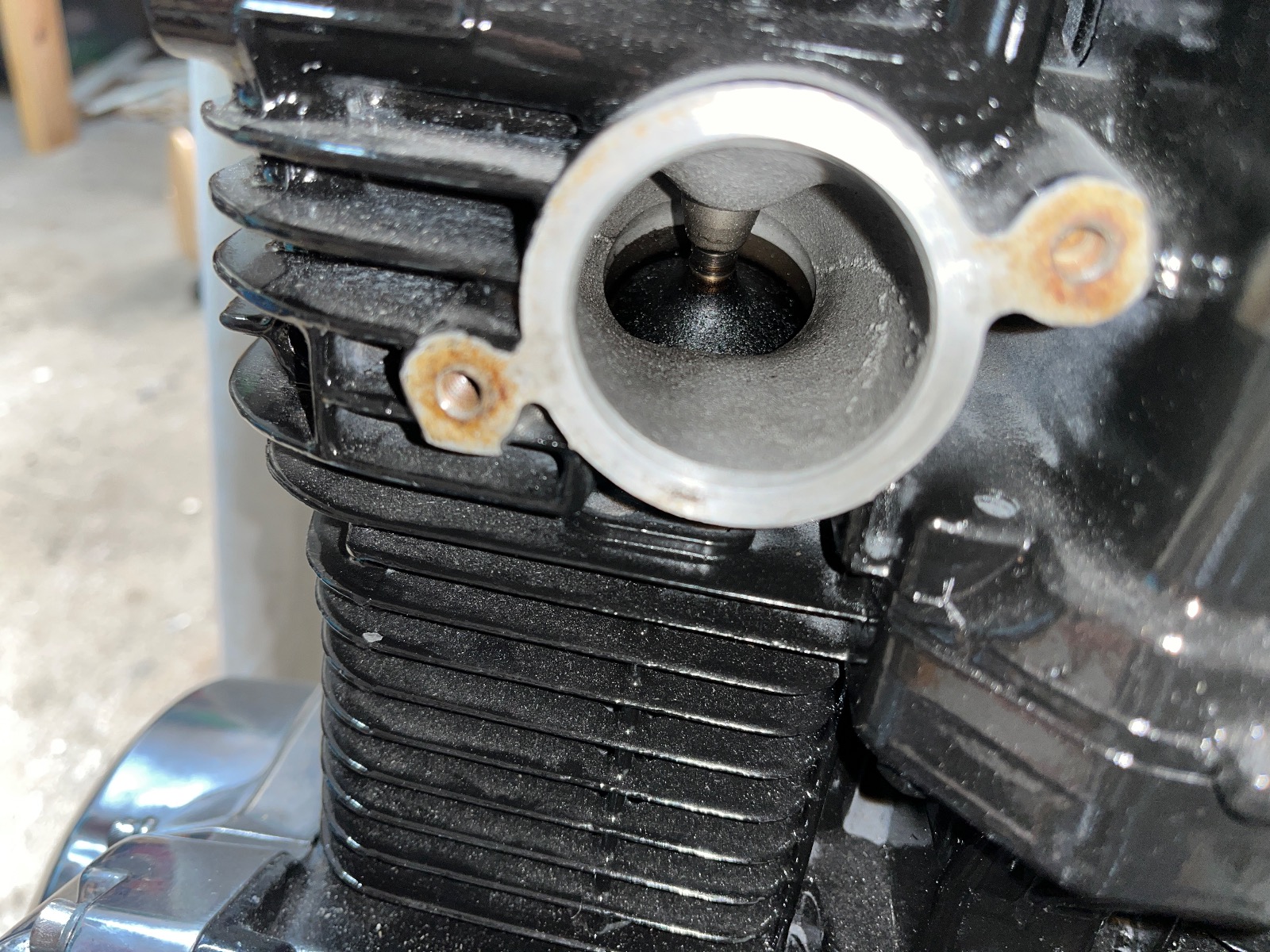

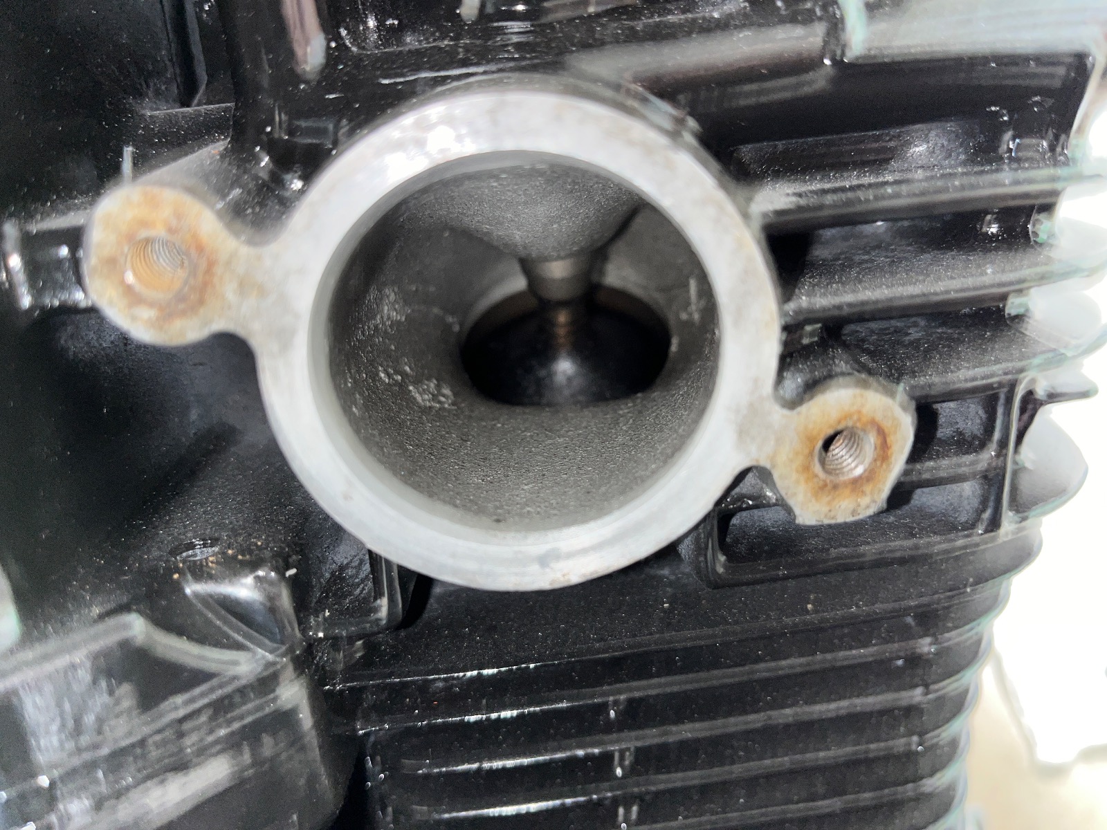

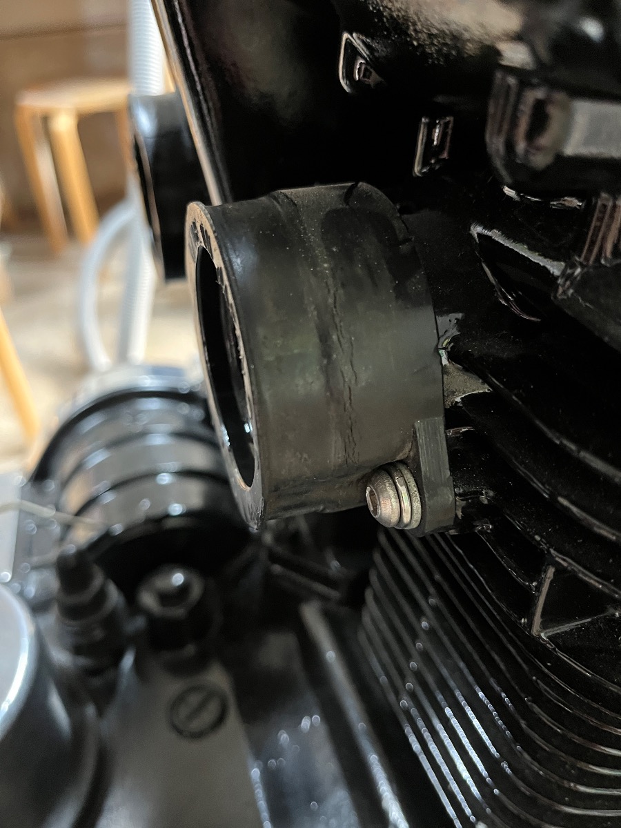

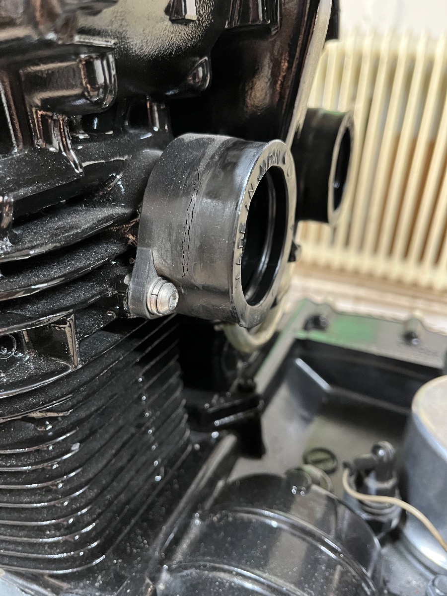

The The rubber boots as seen in the picture has seen better days but the crack are not all the way through so I do not know it that is an issue. But from what I hear from you guys it seems like the engine cannot create the vacuum needed to get fuel into the cylinders so they are most likely not sealing properly. I also took some pictures of the inlet and the cylinder valves.

The issues with the carb mounts as well as cracking is then when they harden they don't "seal" around the circumference of the carbs
