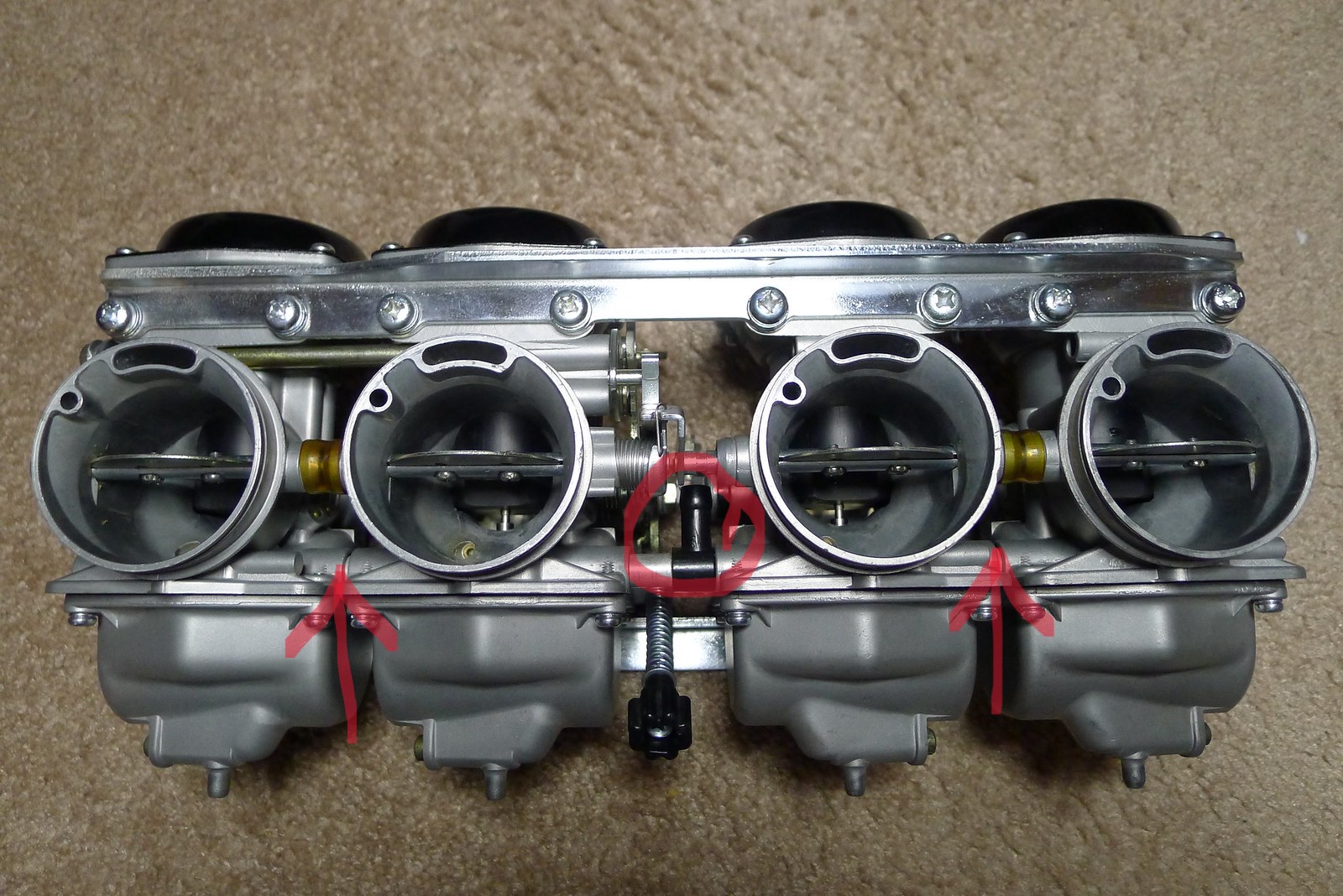

In the photo below, inside the red circle is the fuel inlet T. As you can see, it feeds carburetors two and three directly. The two red arrows point to the fuel transfer tubes. Only a tiny bit of each is visible. They transfer fuel from two to one and from three to four.
The following user(s) said Thank You: twinhcarbs

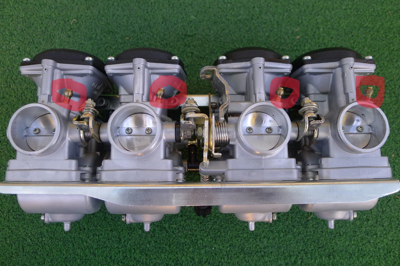

On the engine side of the carburetors are the fuel bowl vents. They are circled, sloppily, in red below. Each one of these should have a separate hose attached. Typically, they drape over the carburetors, and sometimes over the air filter box, and terminate below and between the swingarm pivot and the frame cross member in front of it. Their purpose is to supply atmospheric pressure to each fuel bowl as needed,

Actually on the Keihin CV34 carbs for the 750/4 those red circles above are around the brass vacuum nipples which if no clean air system then cap 3 and connect the 4th (usually #2 carb) to the smaller vacuum nipple on the petcock. If no petcock then cap it also.
As Tex said, only connect fuel line to the black T
The following user(s) said Thank You: Nessism, twinhcarbs

14 Aug 2024 14:14Correct.Actually on the Keihin CV34 carbs for the 750/4 those red circles above are around the brass vacuum nipples which if no clean air system then cap 3 and connect the 4th (usually #2 carb) to the smaller vacuum nipple on the petcock. If no petcock then cap it also.
On the later year CV34 carbs, Kawasaki added dedicated float bowl vents, which flowed into small plastic Tee's, one between 1&2 and the other between 3&4.
