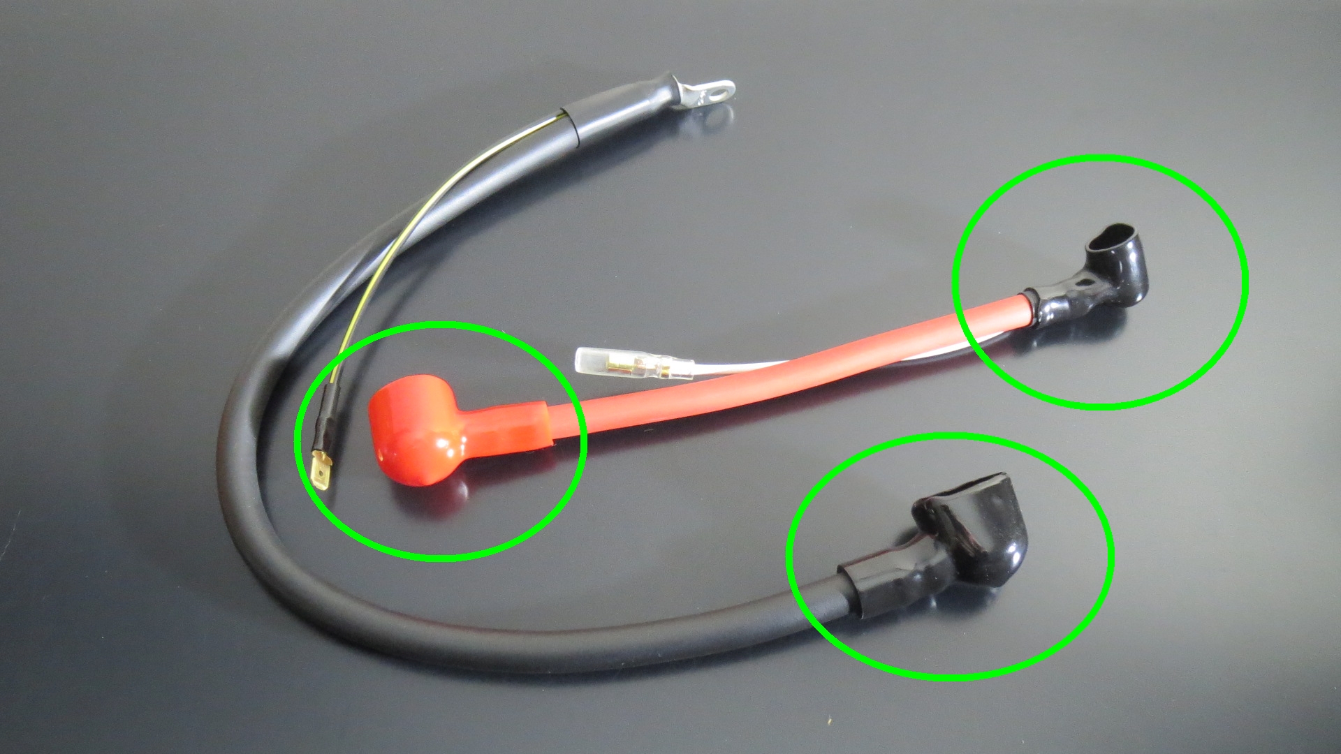

Ok, so that "open 12 volt terminal" thing had some tape over it which I presumed was to keep it isolated (obviously not ideal) so what do you suggest? Does that knob need to be covered? Like I said, didn't really know what I was looking at.

14 Jun 2024 23:18These rubber caps cover the terminals.Ok, so that "open 12 volt terminal" thing had some tape over it which I presumed was to keep it isolated (obviously not ideal) so what do you suggest? Does that knob need to be covered? Like I said, didn't really know what I was looking at.
