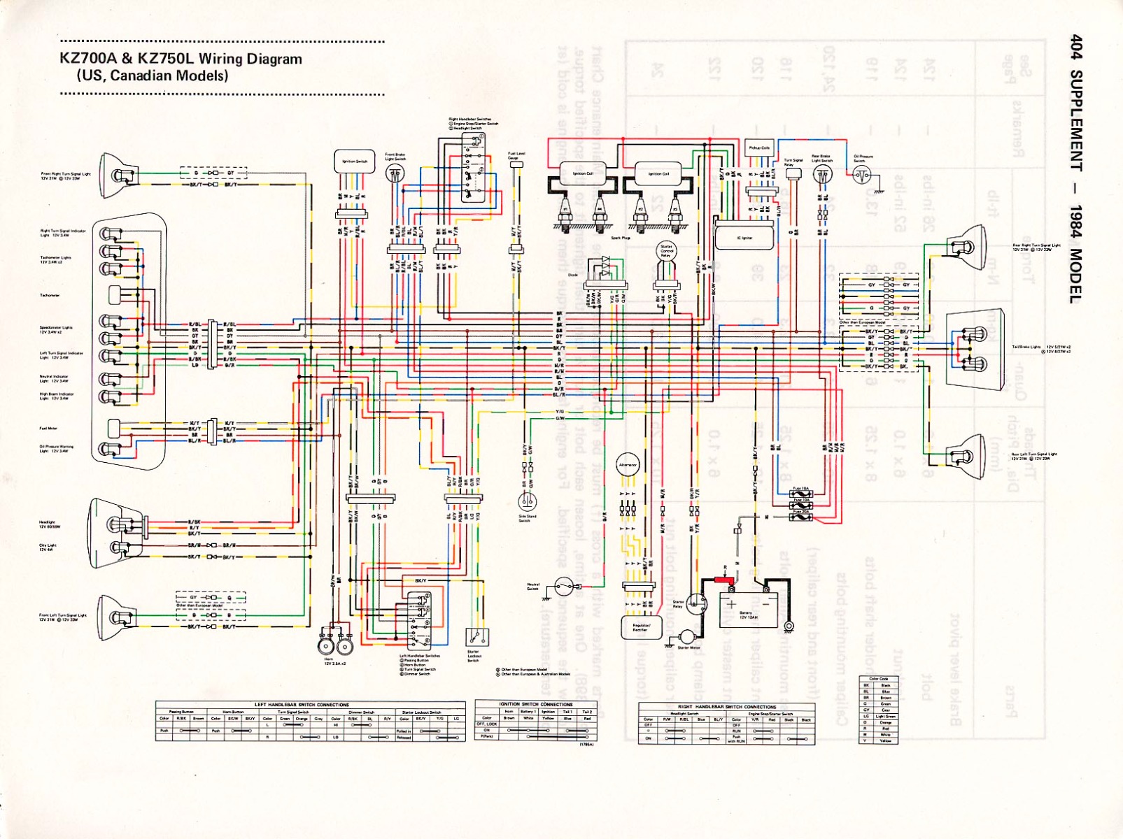

Not saying your machine is like the wiring diagram I have attached as it is for the 1984 model year and for the 700A and 750L models but it shows it as a passing light switch.

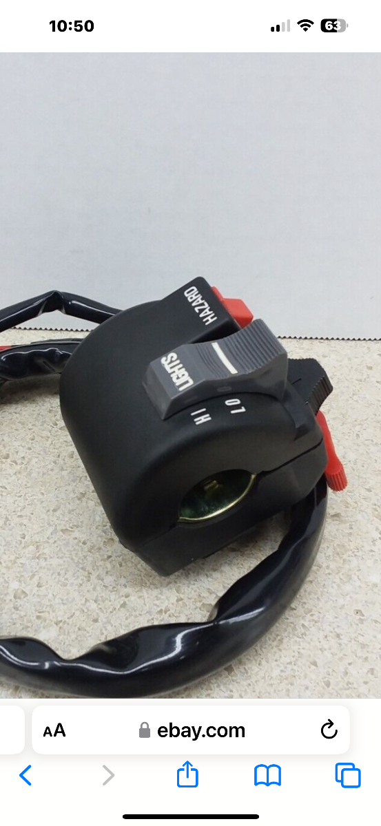

I think it’s a non-functioning hazard switch. I found this on eBay. It looks almost identical to mine, except not so UV damaged.

If its a hazard switch there will be a round 2 pin relay under the LH side cover exactly the same as the one used for the turn signals. It won't function without a relay.
