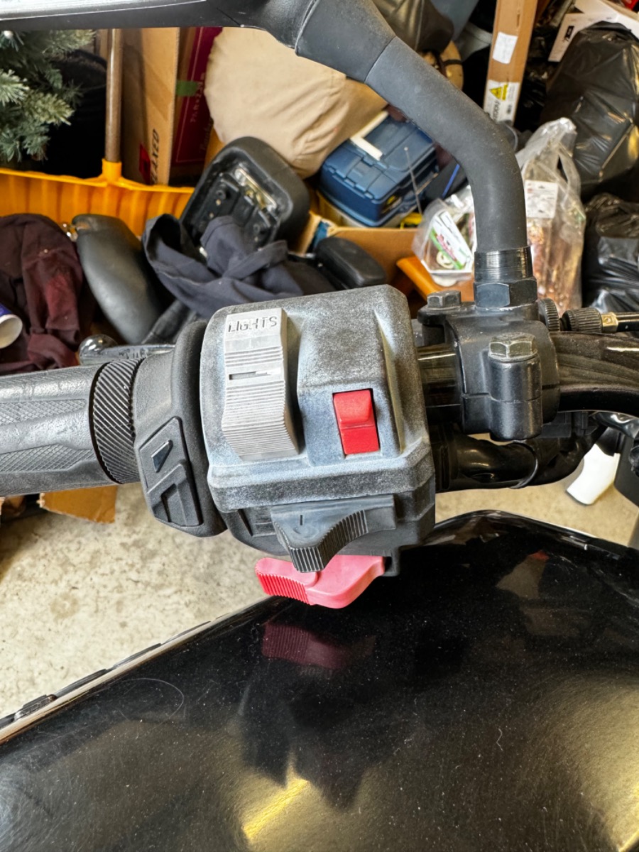

18 May 2024 19:32 - 18 May 2024 19:33If it´s not the horn switch, it should be the pass light (high beam) switch.

It’s not the horn, that’s the big red one at the bottom. High/Low beam is the big grey one on the left.
Toggling the switch while the bike was running had no apparent effect on the lights.

If it's not a spring-loaded momentary switch, next best guess would be 4-way flashers.
