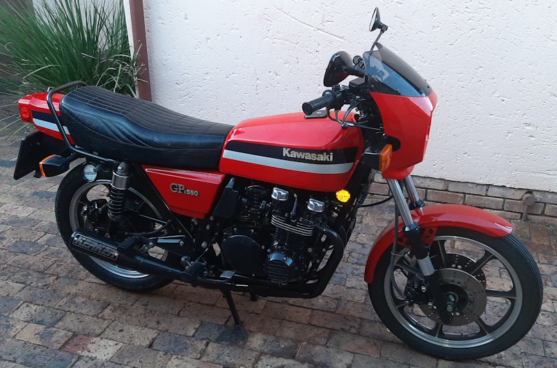

Re: 1981 KZ550 D1 GPZ550 won't start
09 Jan 2024 22:06
Ron, the stock main jets, with airbox and standard exhaust were were #94.
I managed to "tune" mine to run ok, with K&N pods and a Kerker 4 into 1.
I settled on #102 main jets, with the needle clip in the 3rd groove (standard)
Note: I used jets from a DynoJet kit, which look a little different to stock jets.
It wasn't perfect: I couldn't find a "ballance" of low-down torque and "clean" top-end.
I decided to find and fit the correct airbox.
That was the best thing I could have done! #97 mains, needle clips in the 3rd groove.
This transformed her into the sweetest little thing!
H.
H.
