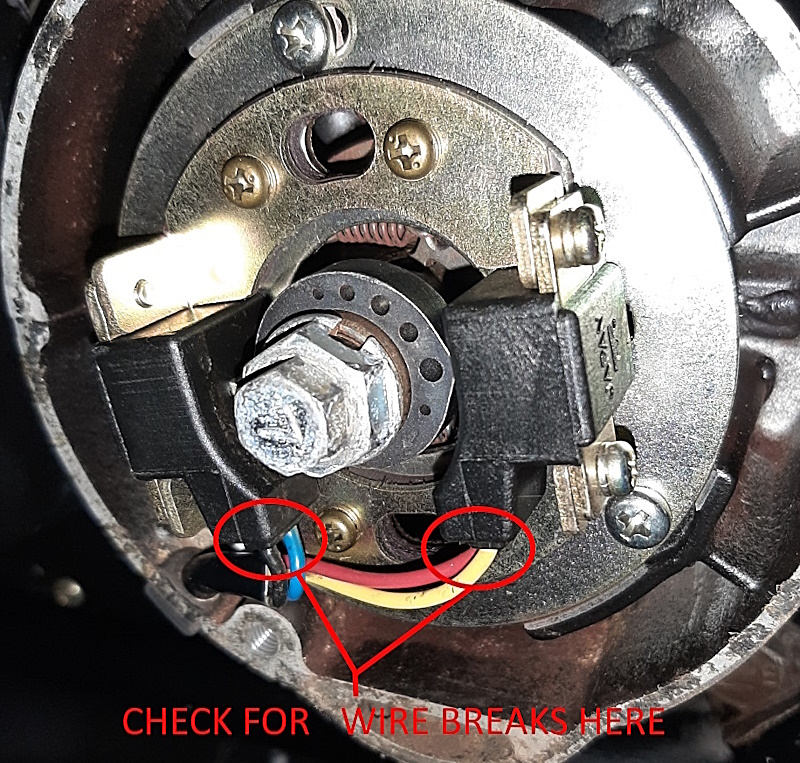

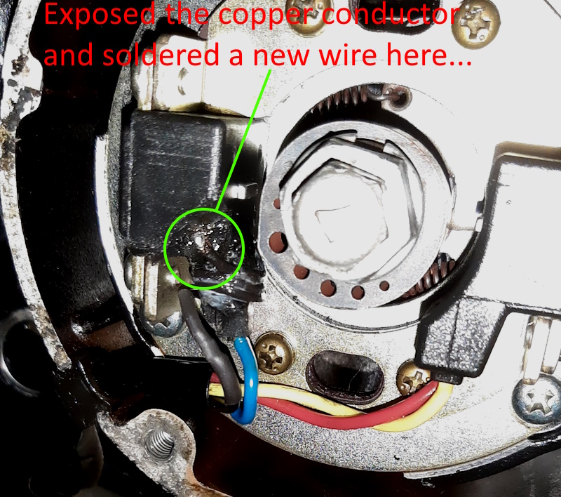

I have the same bike!
I experienced a similar problem, - not starting...
I parked it after an uneventfull ride one eveneing...
The following morning it would not start. It would crank (with clutch lever pulled in) but would not fire...
I found the problem after much head scratching and probing with my multimeter...
The ignition pickup wiring had fractured INSIDE the pick-coil...
It is quite common for those wires to fracture right there....
I'm not saying you have the same issue, but check your ignition pick-up coils...
When I pulled lightly on the black wire entering the pick-up coil, it came out in my hand!
With nothing to loose, I decided to "dig" away the insulation material, and was VERY fortunate to expose a tiny piece of the
remaining copper wire...
I carefully soldered the wire back onto that little piece of exposed copper...
I covered the joint with Epoxy adhesive (JB Weld or similar) to provide some "strain relief"
The engine fired right up after that and has run perfectly since then.
H.
