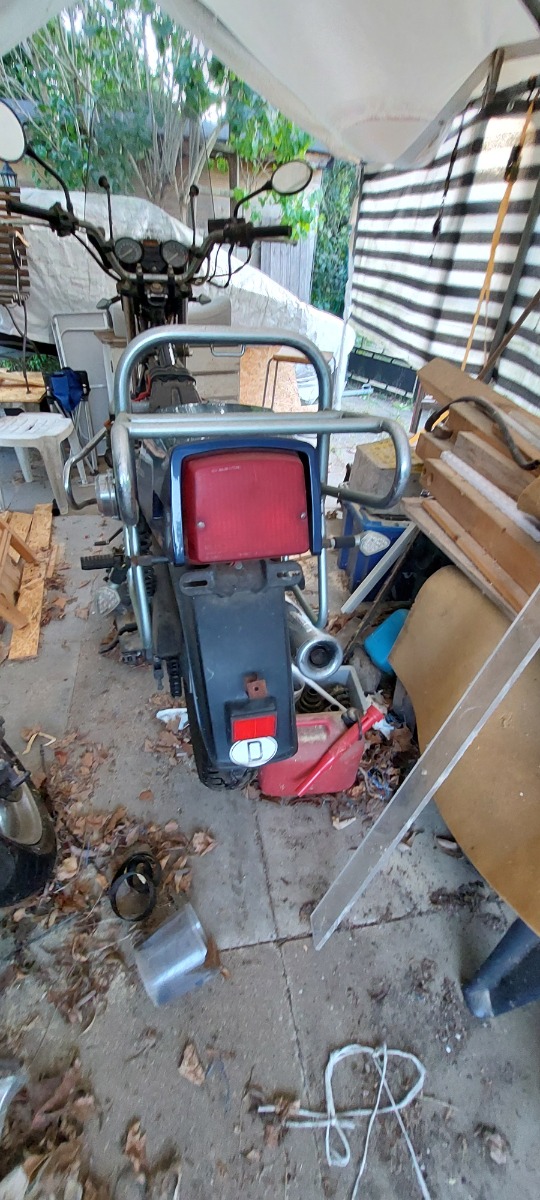

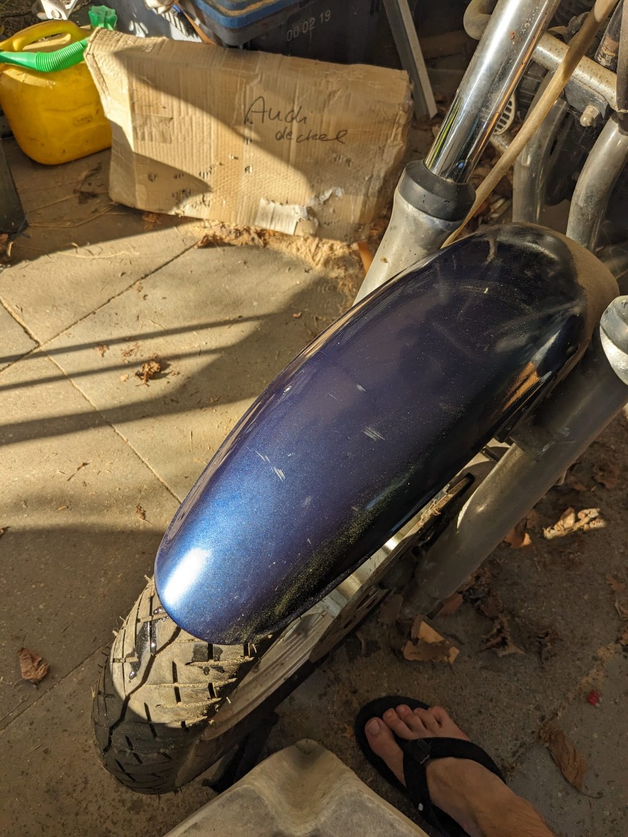

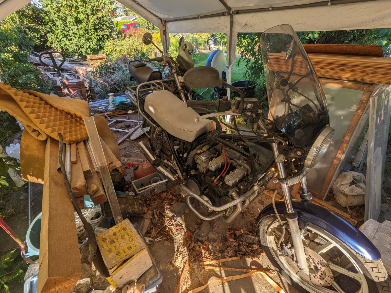

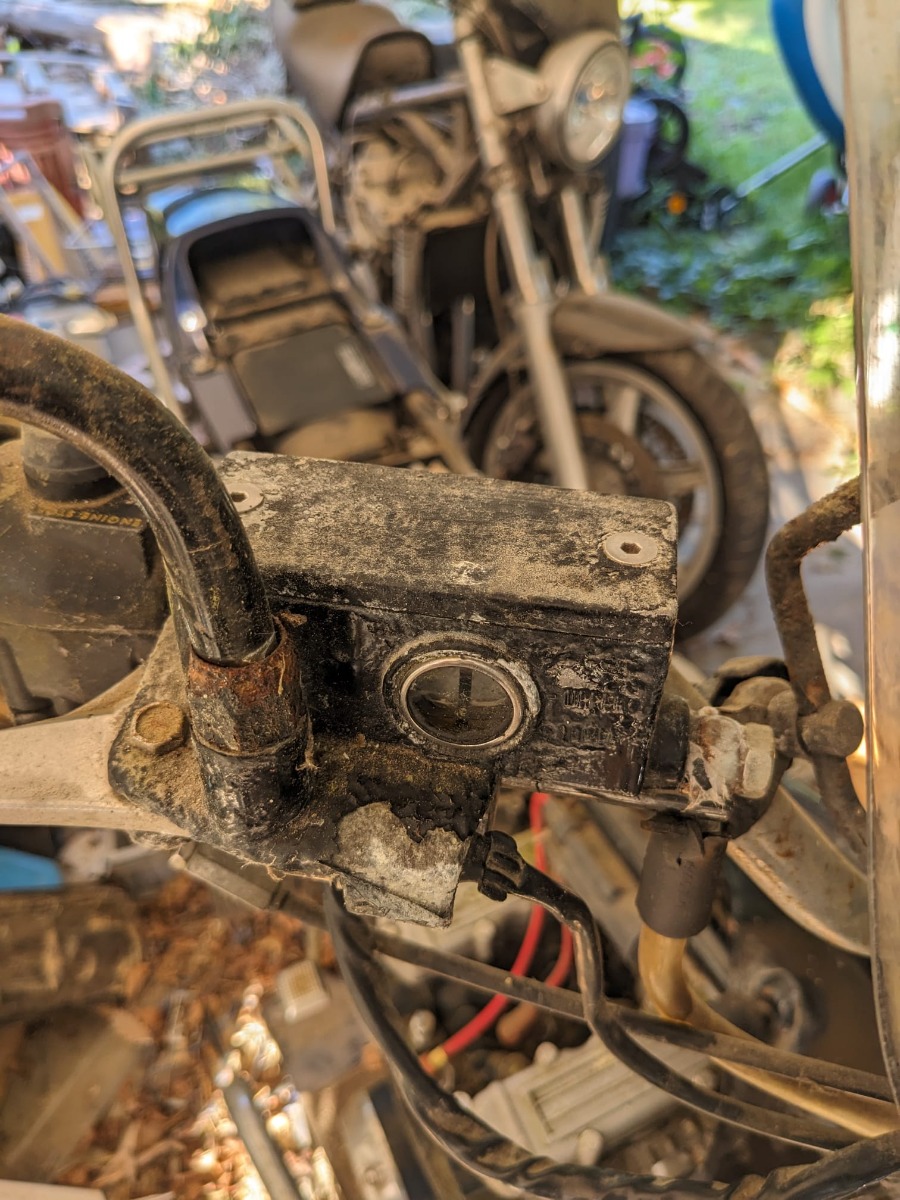

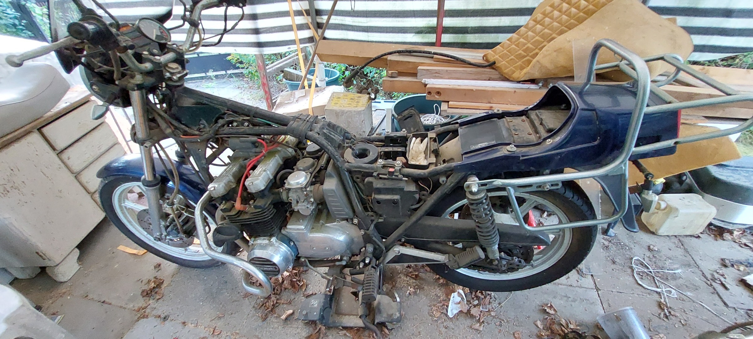

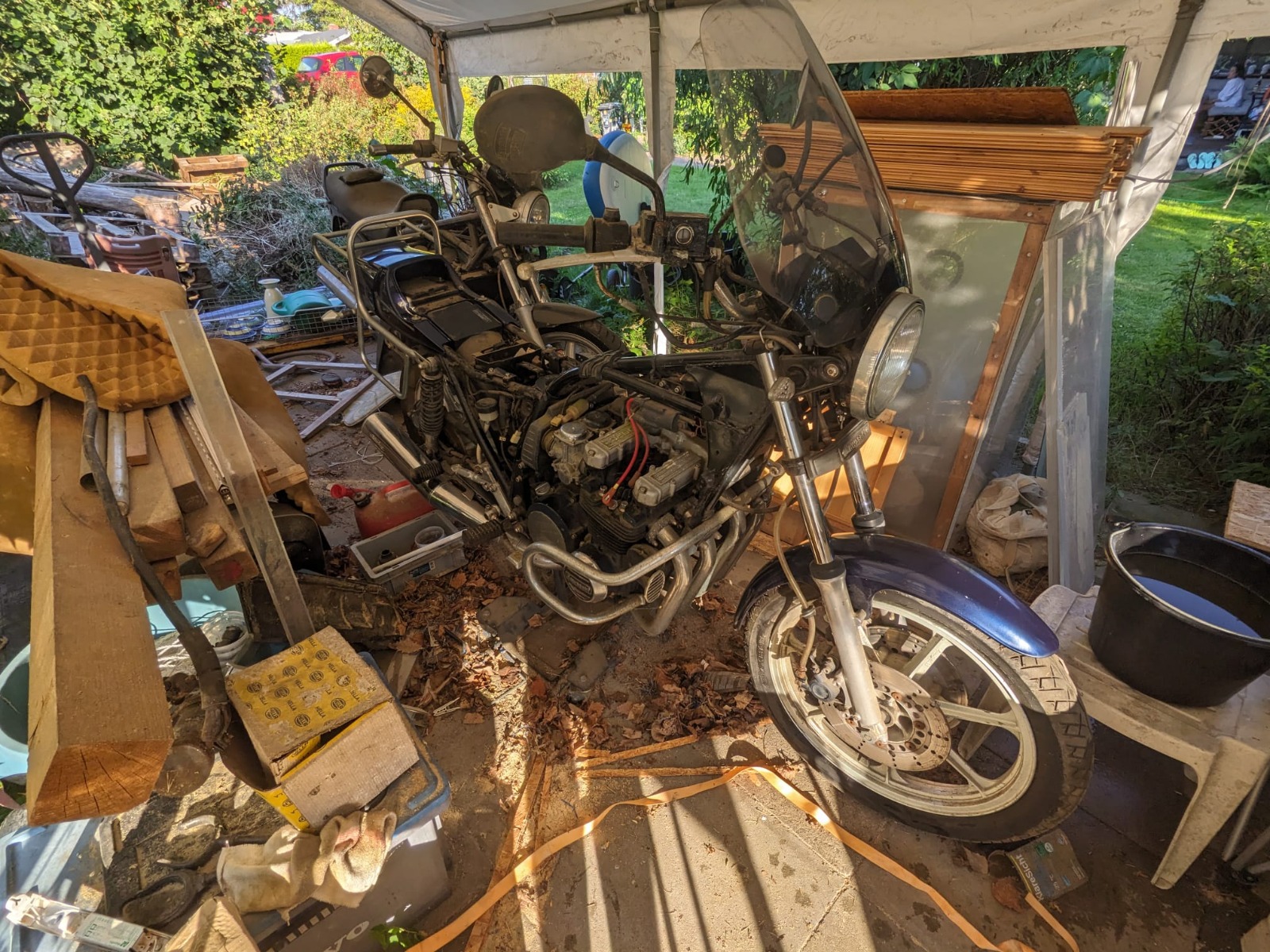

Hey so I am new to riding this hopefully will be my first bike and advice is needed hopefully I haven't wasted my money for this I do have the tank and it was stored dry but I am no mechanic .

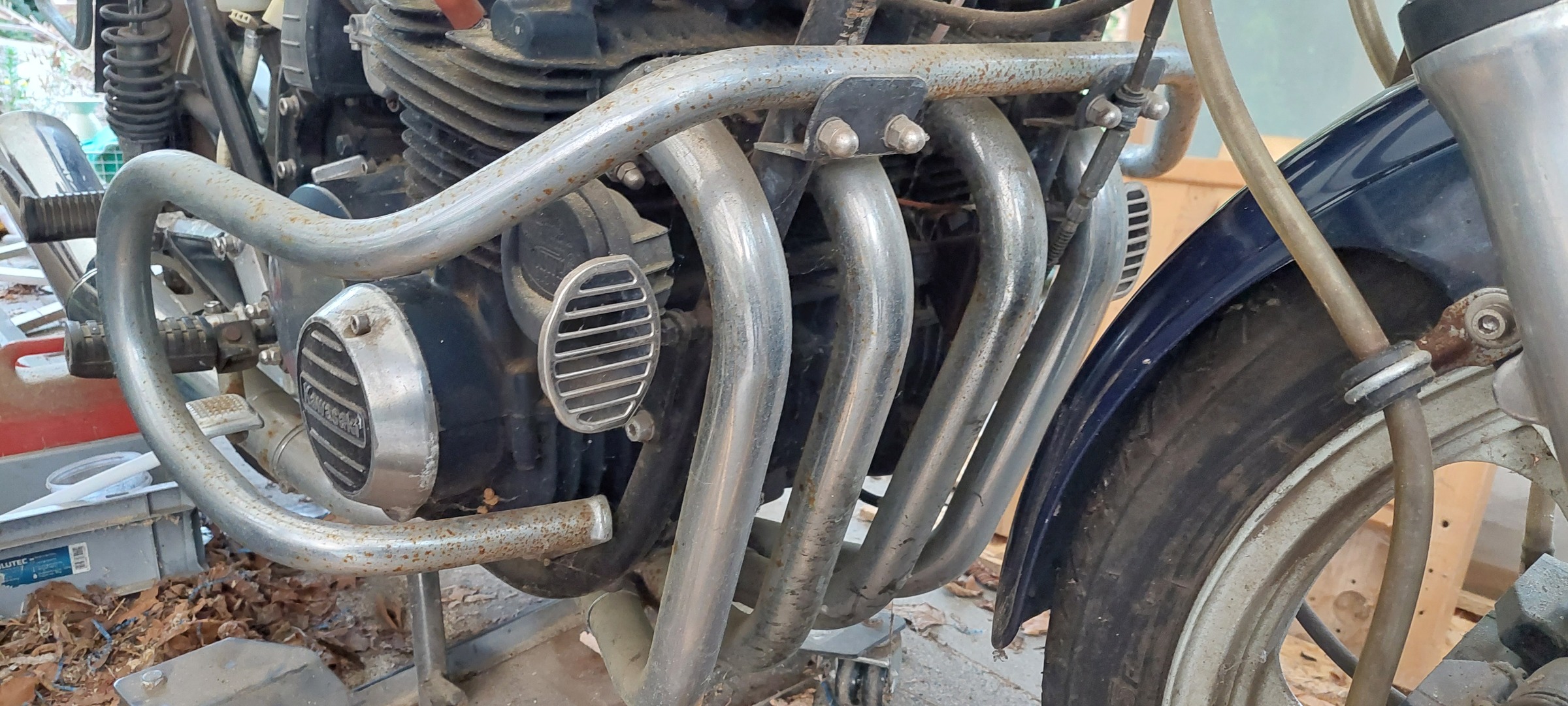

Looks like you found yourself a nice project. That bike was someone's baby, based on all the nice accessories installed.
You might want to check out my signature for some helpful links...

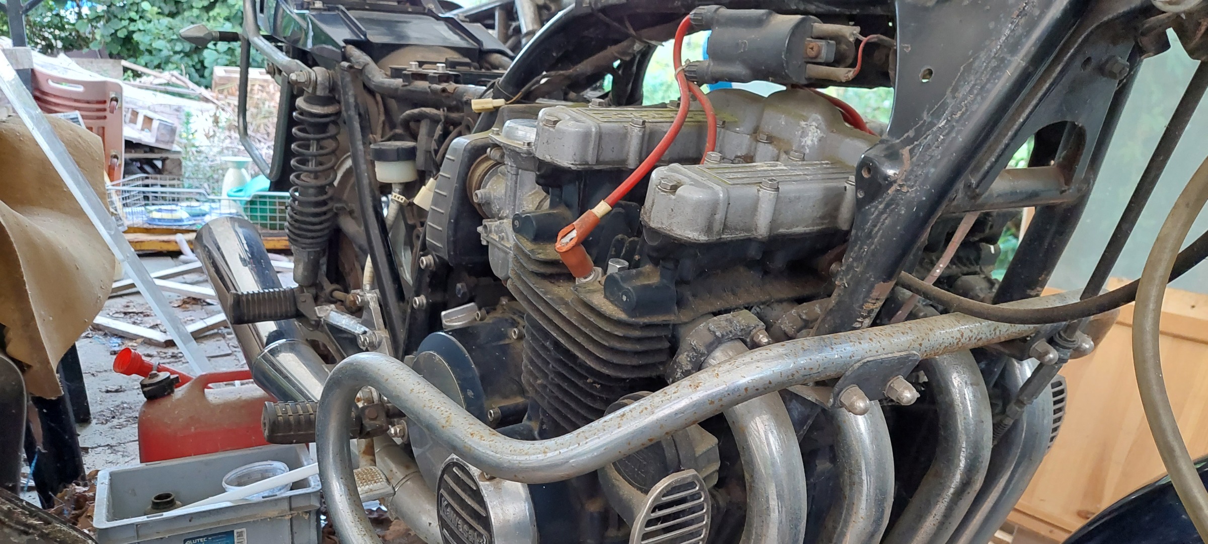

Yeah I know the family it came from they are all complete petrol heads. My friends father rebuilt the engine so hopefully no mechanical issues and the wiring is stock except the led lights.
He even painted the engine block when it was rebuilt. He was a professional engineer and mechanic for volvo so he was very capable.
hopefully all i really need is cosmetic work but who knows what is going to happen.

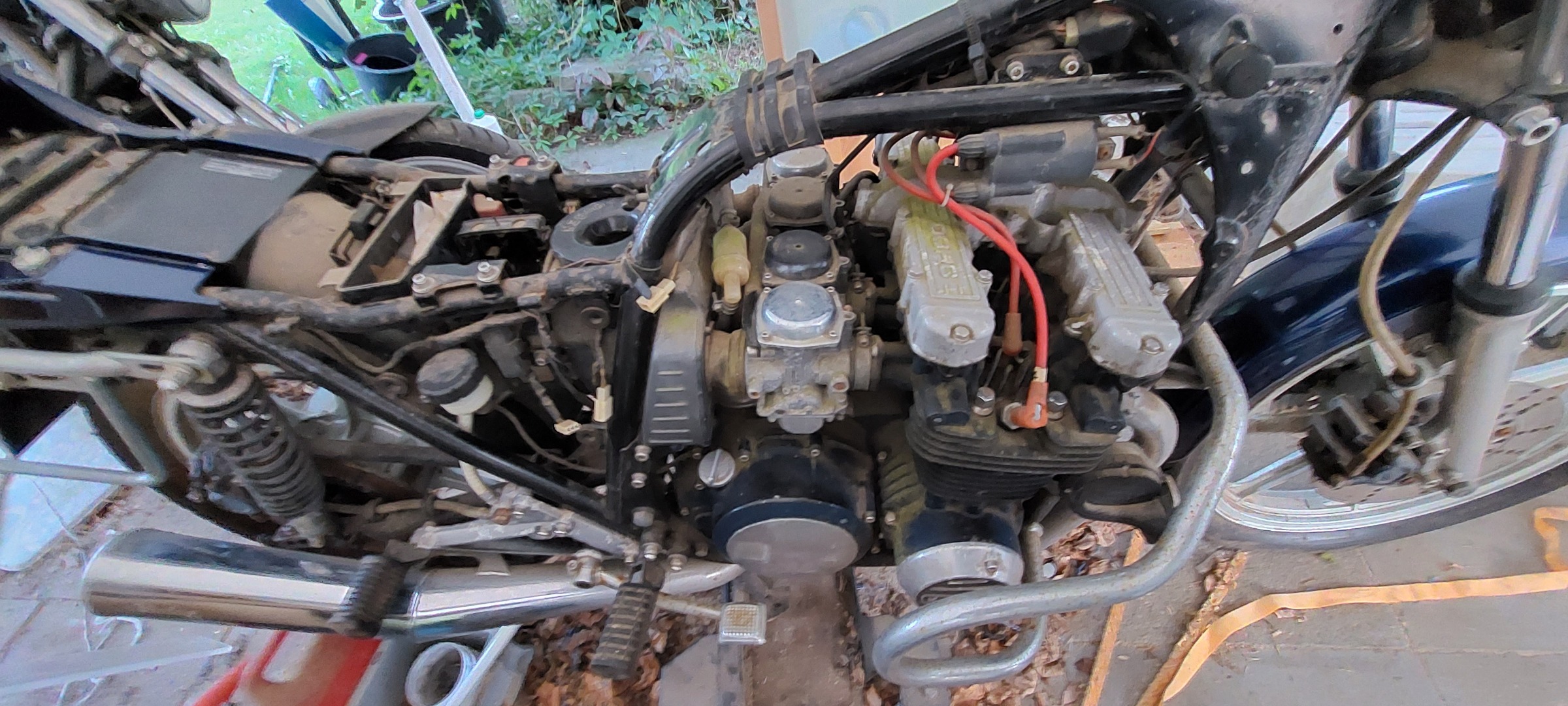

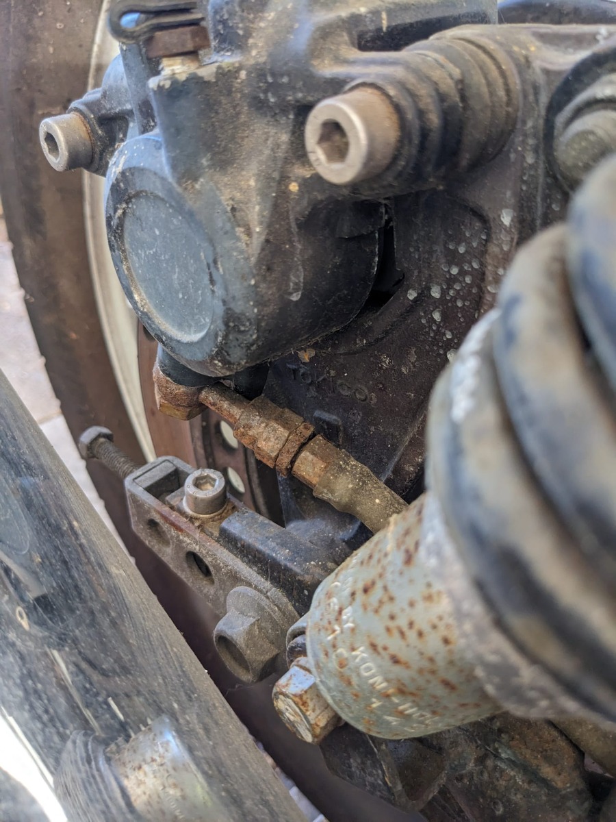

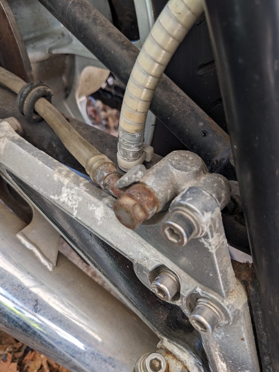

Personally, I'm a carb guy, so I go straight at those. I have O-ring kits, if you can't find what you need in the local market. Replace the rubber carb boots. Adjust the valves. Clean out the tank. Replace fuel line. Break down the brake calipers and master, looking for corrosion, and replacing parts as needed. Where to start? Everything!

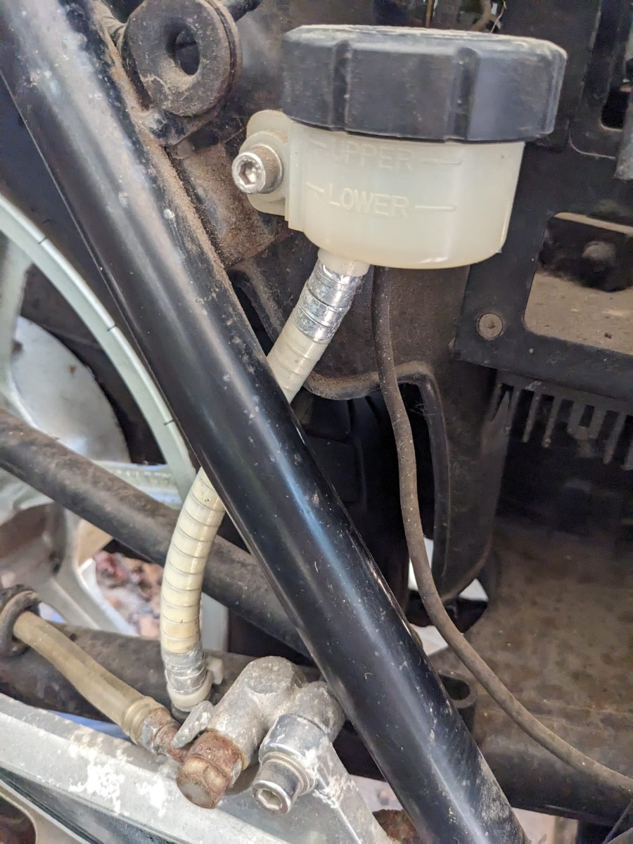

Our preference on a project like this is - before we make it go, we make very sure it will stop. Brakes are very high-priority.

Get it running then work on the safety and maintenance items (brakes, tires, chain and sprockets, lights) then ride it while you do the cosmetics.
