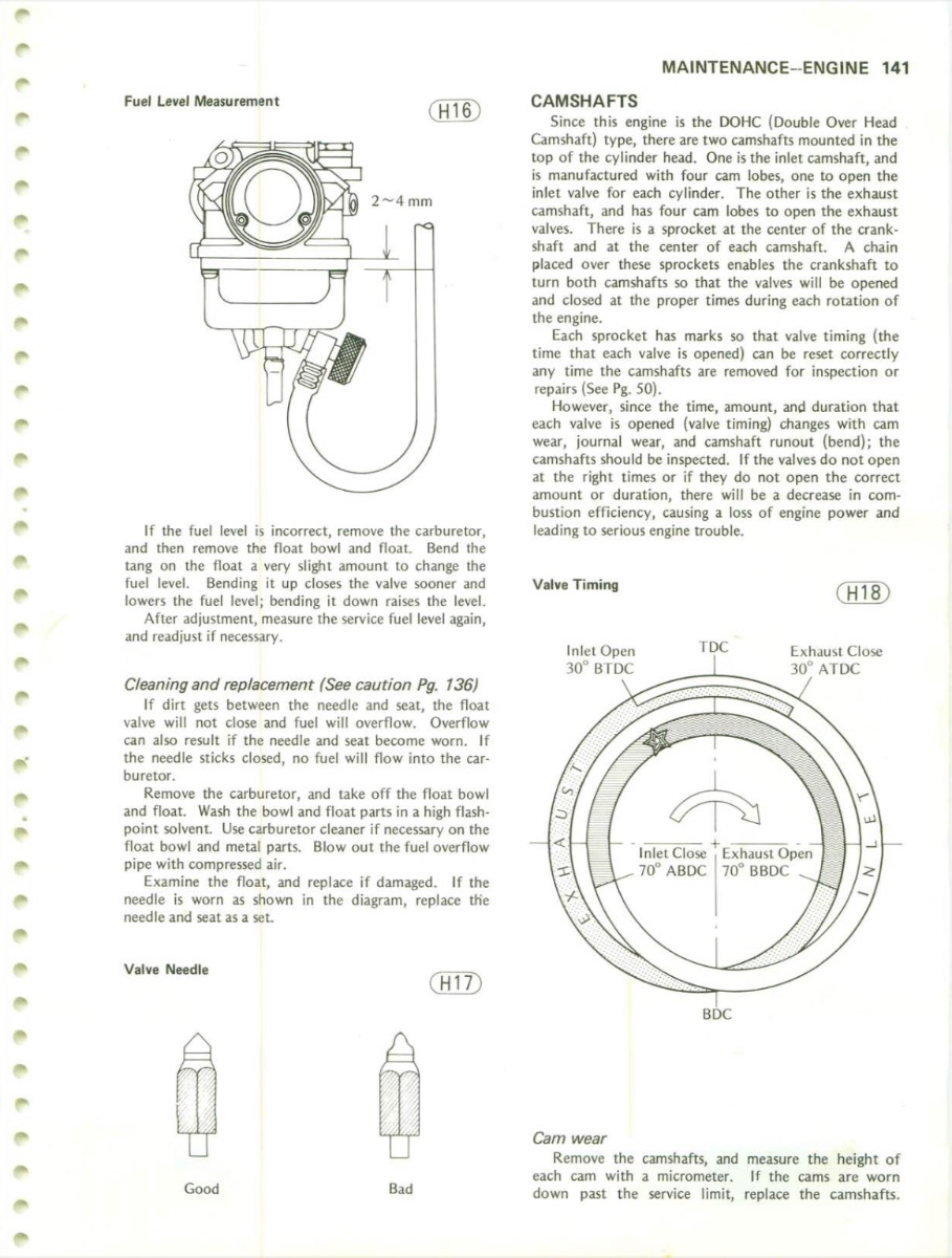

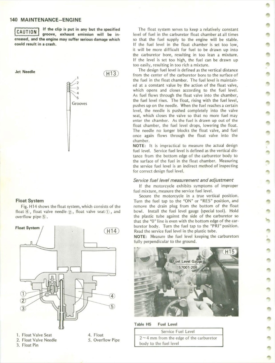

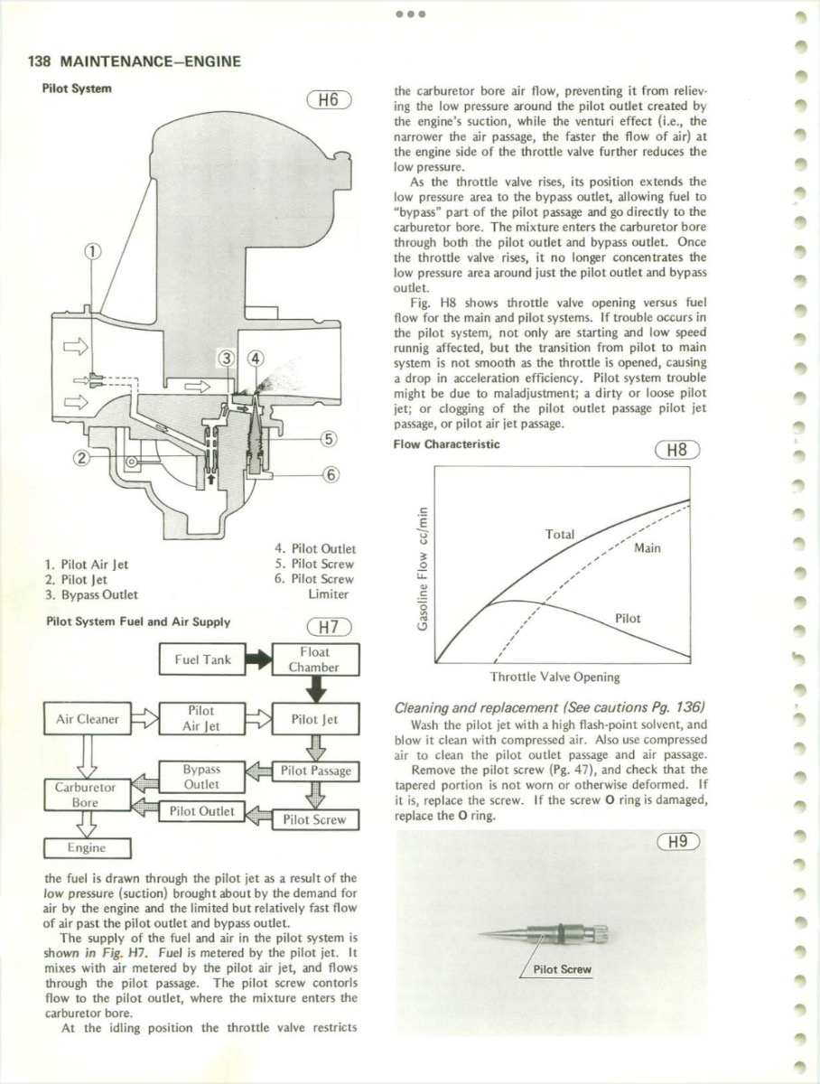

Re: New member - Montana
22 Oct 2023 09:35Agree with everything so far. No body has mentioned float levels. That will cause the lean condition. Float level needs to be set and verified. I agree with Wookie, buy new carb holder boots. It’s a sound investment that will serve you well for years. Again as mentioned the fuel type pilot adjusters very susceptible to breaking the tips off and sticking in the passage. I’d pull them out and post pictures so we can see if they are intact.It’s always worked for me, any cracks surely will suck in and alter the engine note, also to buy a new set of rubbers before pinpointing that they are even necessary seems wasteful to me.
See photo bottom right
Here is the procedure for setting float levels.
Lots more needs to be checked off the list also. One critical before moving on is coil primary voltage.

I have not messed with the float level so ill have to get the tool to check that. As far as the pilot screws i know are good and can adjust them as when i cleaned the carbs the tips are all nice and pointed, i talked to the previous owner and found out the carb to head boots were replaced when he first got it so fairly new and not original but doesnt mean they cant be bad but havent been able to double check. But now onto the real issue is that i wont be able to really do to much for a bit because it winters coming early up here and just got a nice blanket of snow and ice. i dont have a garage and my shed is full but i was able to ride it about 3 blocks down to my sister's and her fiance's house and put in their garage. I can work on it there when its a bit warmer out or when i get a heater just because its not a heated garage. I will continue to research more on the bike and gather parts so hopefully when we see the warmth again without the white stuff i can have it basically ready to ride.
