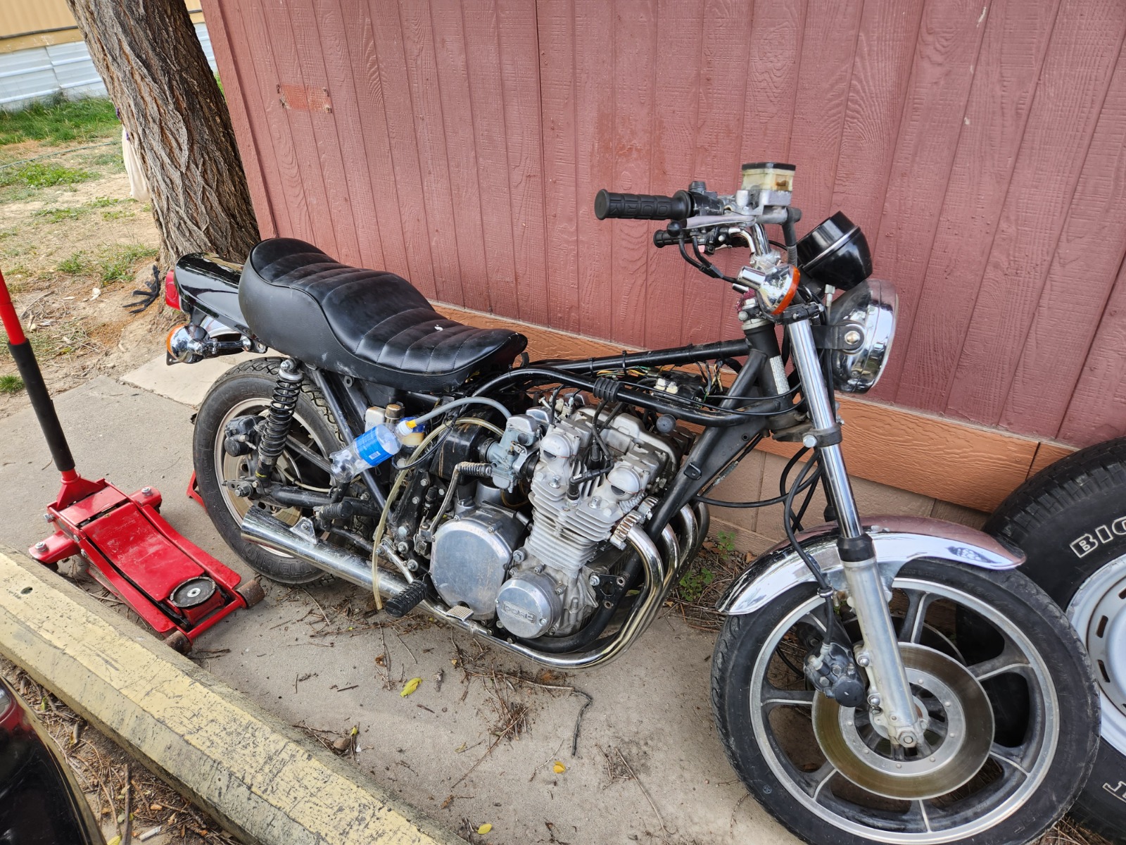

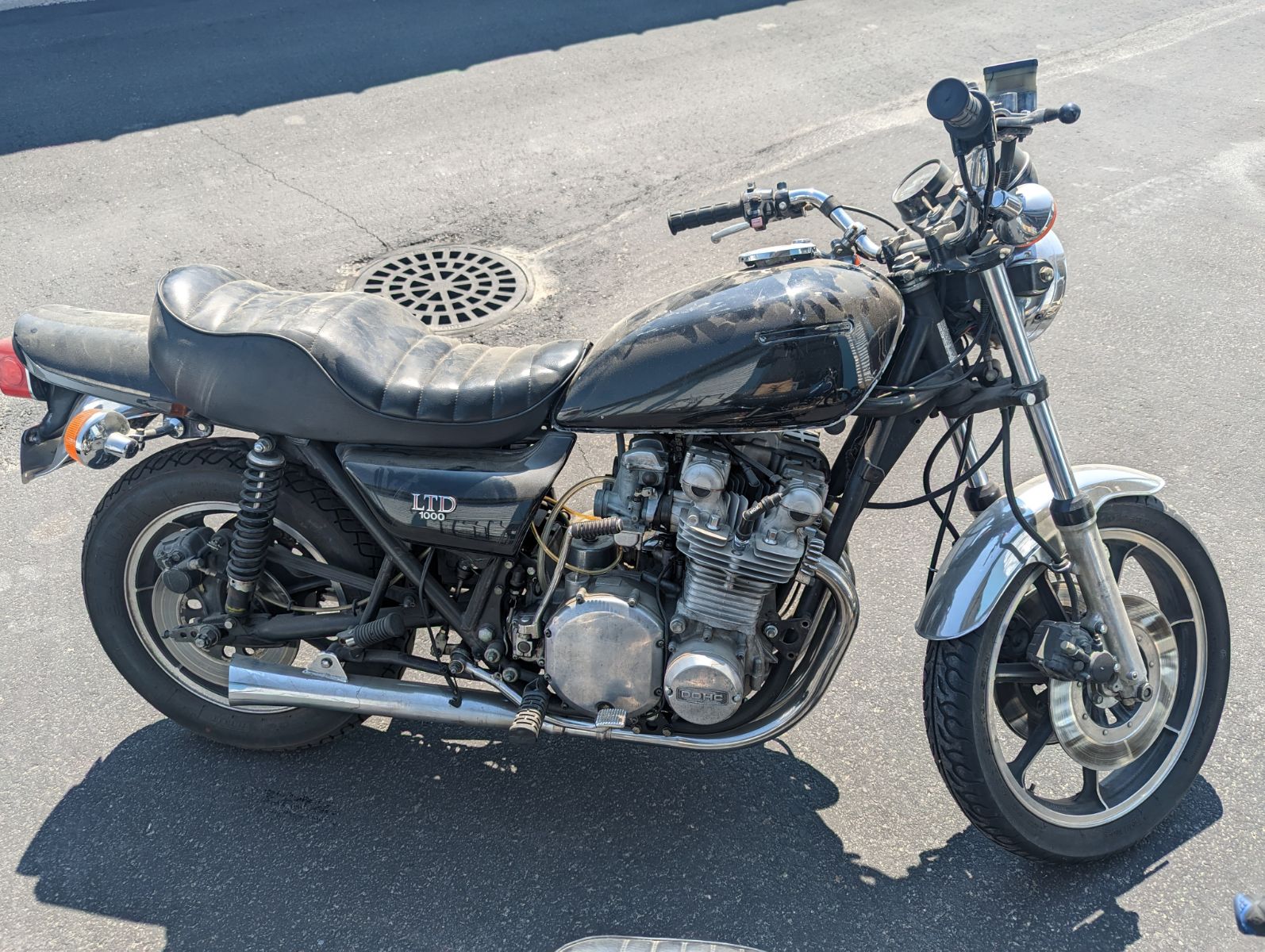

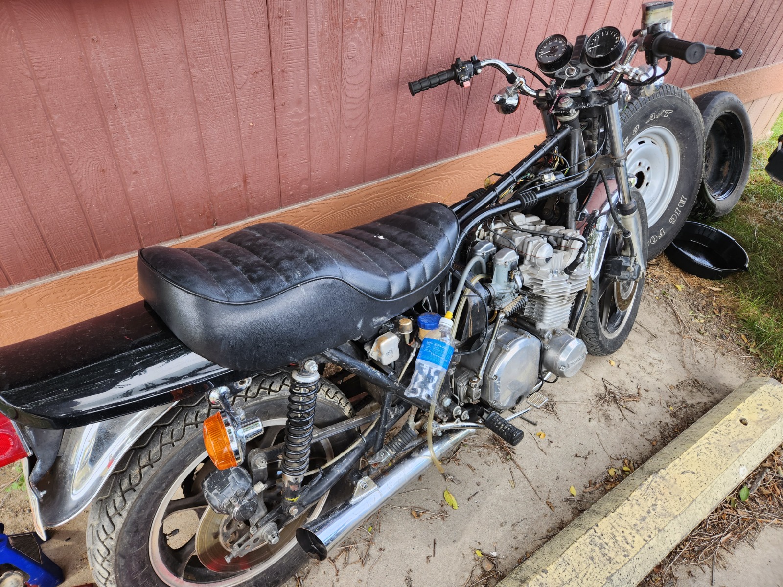

Hi new to Kzs and new to street bike in general.
Recently made a purchase (what i feel is a steal) from a coworker for a 1978 Kz1000 LTD, along with a 71 honda cl100. The KZ he never really did much with besides finished putting together from what a PO had torn down and then just drove around town till putting in storage for a few years. Fastforward to now i was able to fire it up on full choke but the moment choke is off it dies like it starving for fuel. Been cleaning the carbs and trying to eliminate issues as i can seeing how the cold season is upon us up here and wont be able to get it out much. But will continue to work on it and clean it as much as my wife and wallet will allow.

Hi if the bike has stood a long time the petrol has probably gummed up in the carbs blocking the jets. It would fire on the starter choke jet but as soon as you release the choke norhing being drawn up from the main or pilot jets. An easy fix with a rhin wire and some carb cleaner once they are removed from the bike that is. I found it much easier to warm the intake rubbers first with a hair dryer, makes them flexible and less likely to split when jiggling carbs free. Hopefully you will sort it

Frustrating. Are the carb sliders set to correct idle gap? With them off the bike slide a bit of wire about .7 of a mill under the slide between it and the base. You should be able to see light shining through as you hold them up. Another thing you could look at are the air mixture screws they should all be at least one turn out from the stop. Make a note of where each one was prior to adjustment, so you can put it back if needed. Are the idle jets blocked? Again just blow through them with a tube. From the pic the airbox is removed, try it in place if you have it may increase the vacuum needed to draw the petrol up the jets. Let me know how you get on.
