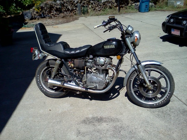

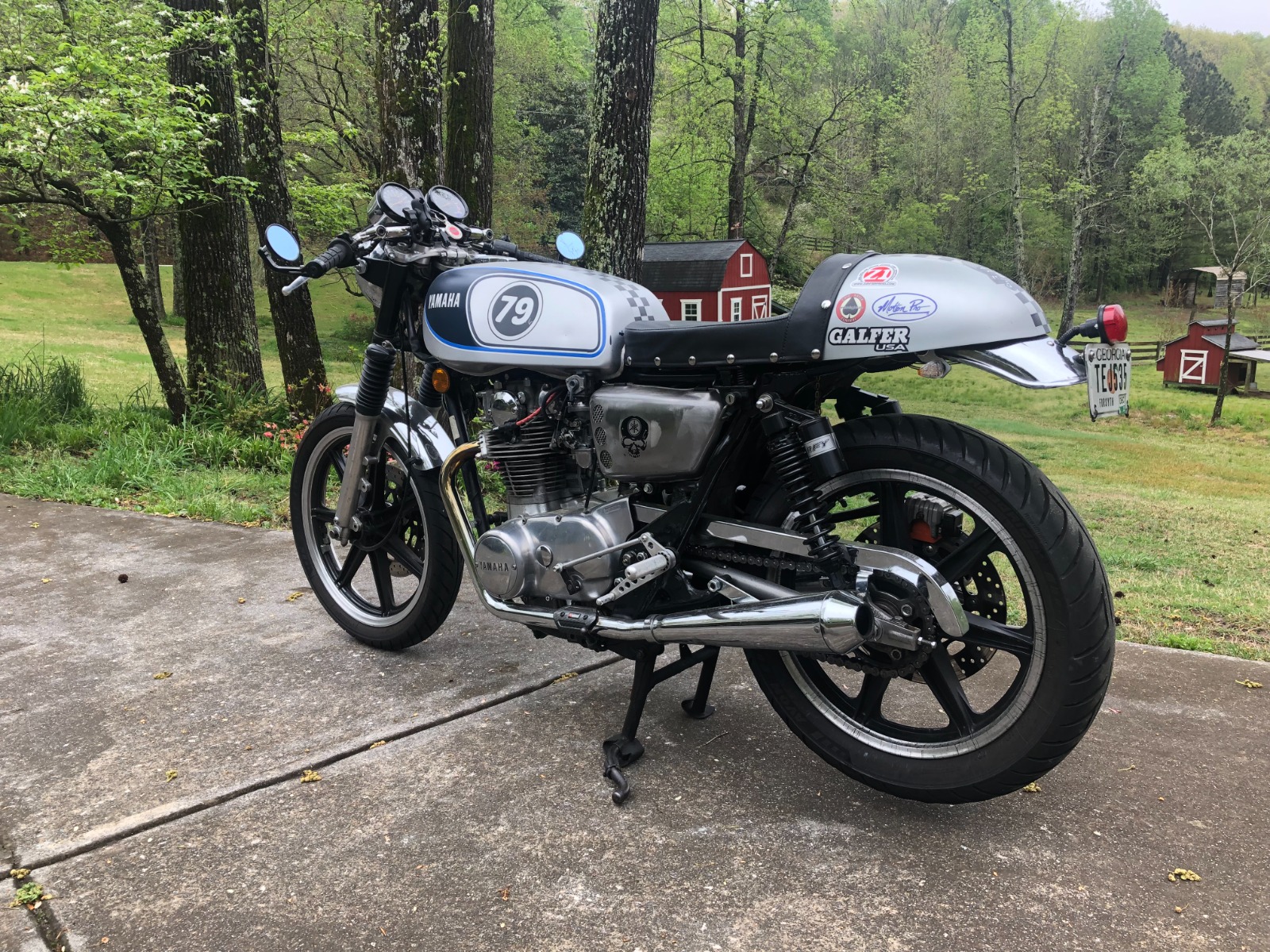

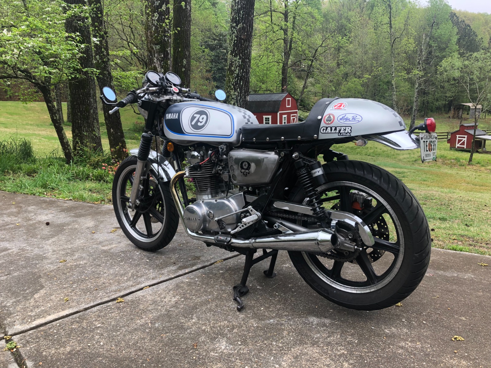

Re: New to these bikes
26 Sep 2022 12:23LOL. I have. Before and after pics of my XS650 cafe'. It didn't take the amount of work yours has but I started with a Special which means small rear tire, short shocks, long forks and a small tank. Fortunately, the XS650 standard frames and special frames are very close.Thanks for that but it's more about having a "what's the worst that can happen" approach (not with safety related items) I have never worked with plastic before but I figured that if I mess it up I can get another piece without breaking the bank. I am hoping that all done I will be into it for around £4K which in the UK is about the starting price for a 70's "Z" that needs work (most of the parts I am using are used from other bikes) and I bought the bike originally for £1100 as the later bikes are not yet desirable. Be brave and have a go
26 Sep 2022 12:58That is a sweet ride, "proper classic cafe racer" not a hacked up subframe and a brown seat. You sir also have skillsLOL. I have. Before and after pics of my XS650 cafe'. It didn't take the amount of work yours has but I started with a Special which means small rear tire, short shocks, long forks and a small tank. Fortunately, the XS650 standard frames and special frames are very close.Thanks for that but it's more about having a "what's the worst that can happen" approach (not with safety related items) I have never worked with plastic before but I figured that if I mess it up I can get another piece without breaking the bank. I am hoping that all done I will be into it for around £4K which in the UK is about the starting price for a 70's "Z" that needs work (most of the parts I am using are used from other bikes) and I bought the bike originally for £1100 as the later bikes are not yet desirable. Be brave and have a go
