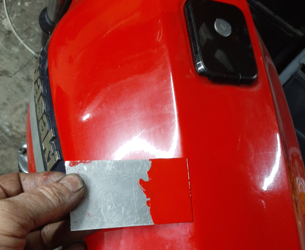

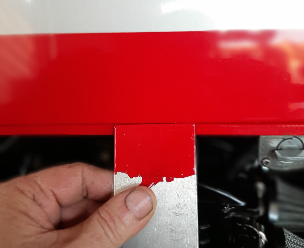

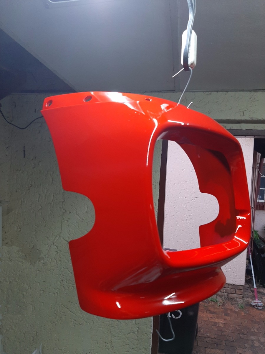

I had to re-spray the bikini fairing... could not find a color-code for "Firecracker Red"
The best match I found was: Volkswagen MONZA red. (2K)
To my un-trained eye, it is a pretty good match, given the 40 years of exposure to the elements!

Got told Ford cardinal red is a v good match
Kawasaki code is  601 : firecracker red
Can confirm. Cardinal Red was readily available in spray cans from Dupli-Color five years or so ago, which was nice, but it looks like that color has been discontinued.

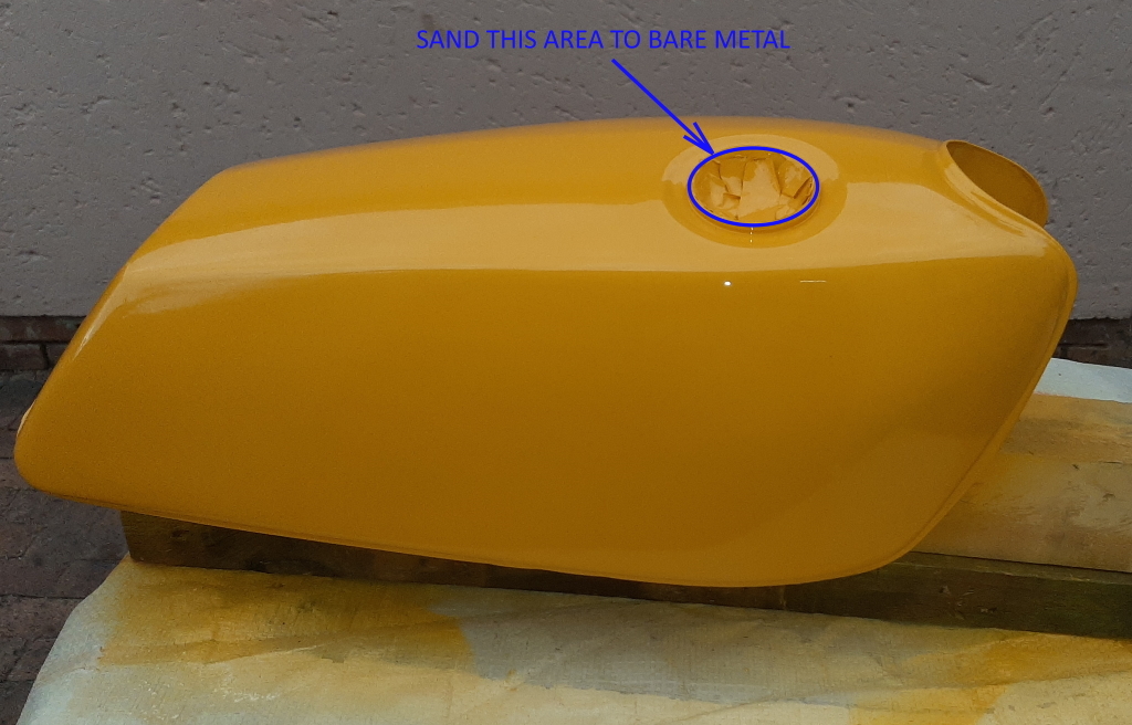

To be sure... gas tank paint must be gas-proof, or at least a coat of clear "gas proof" paint.
Also, remember to "feather" (down to bare metal)  the area at the gas filler opening, particularly where the cap seal contacts the tank opening.
What I mean by "feather" is to sand down the paint so that there is no perceivable "edge", as would be the case if the gas filler hole masking was simply removed.
The reason for this is to prevent gas from "creeping" under the paint edge, where the painted surface ends and the "inside" of the tank begins.
I have seen beautiful paint jobs ruined by what looks like "mole" tunnels from the gas cap area.
