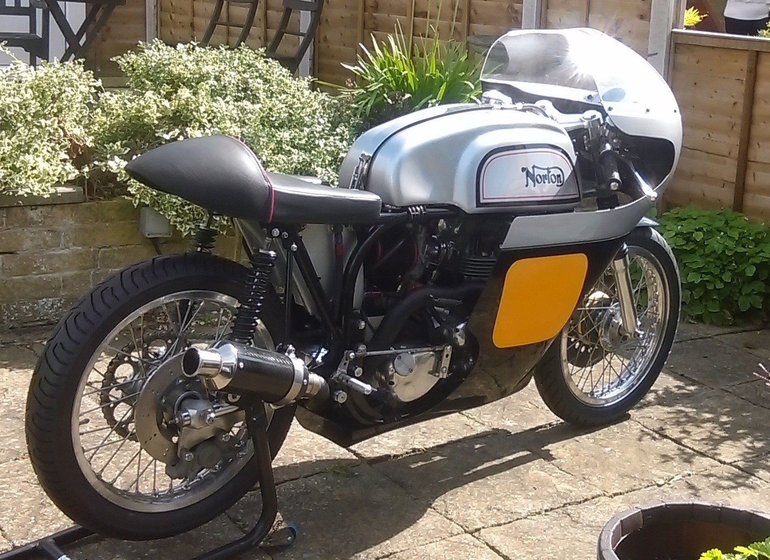

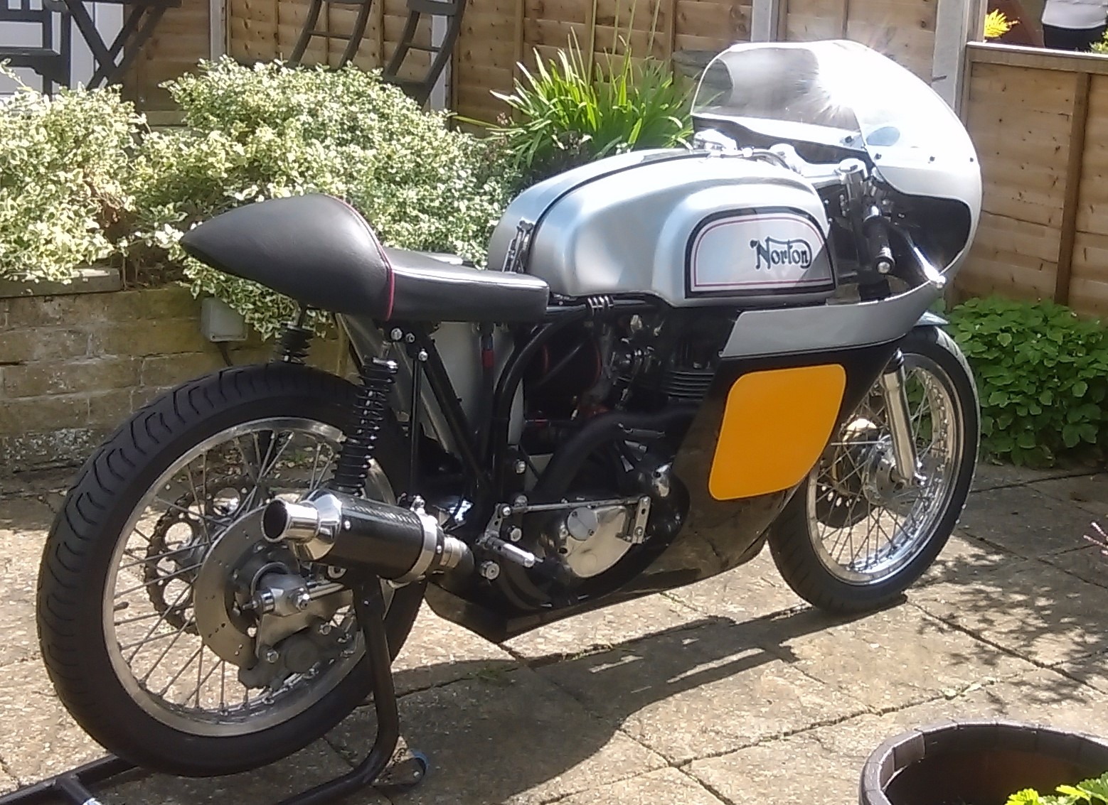

No we use any old Plastic for the Prototypes then a Firm in the South of England 3D Print in PA12 at a very good Price and the Service and Quality is far better than on any Home Hobby Printer then the Machines they are using are Very Expensive but they print off multiple items in one go.
I find them Excellent to Deal with and I help a friend of Mine who Races a 1959 Norton 500 Domiracer and the Bellmouths are 3D Printed along with a few other Parts in PA12 as they are Lighter than the Original these where produced by them also.
This 500cc Norton Produces 59bhp at the Rear Wheel on the Dyno and holds the Lap Record for Aintree it is the Fastest 500 Pushrod Twin around there.

Ian Next time click the insert all tab to finish installing the picture
Nice Bike

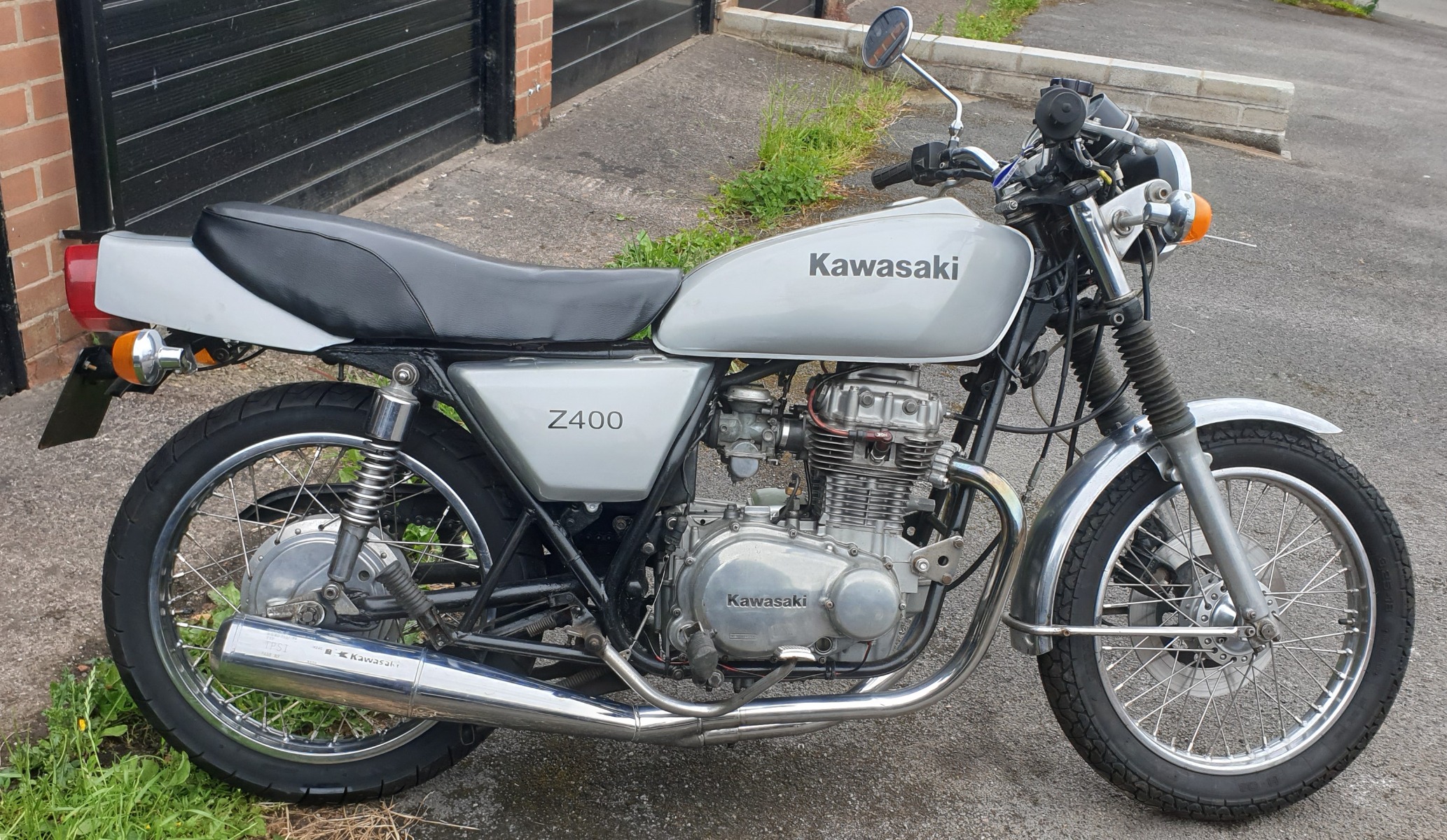

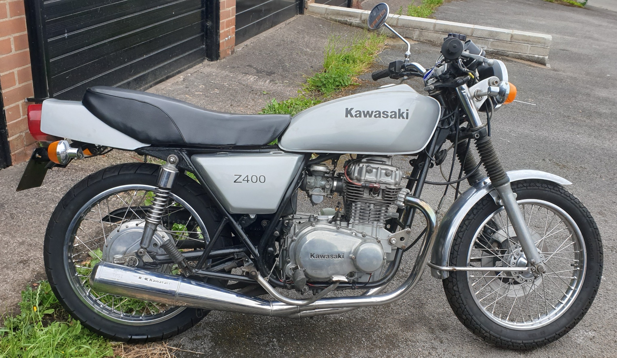

Thank you Dave I will attempt now to ensure it works for me if it has here is the Same Bike at the IOM Manx GP with D.S Aboard last race there in 2000 the bottom Photo is Bala Bridge on the TT Course and I had Better put the Photo of the Latest Z400 that the complete motor has been rebuilt from new old Stock parts .
Thanks Ian.
