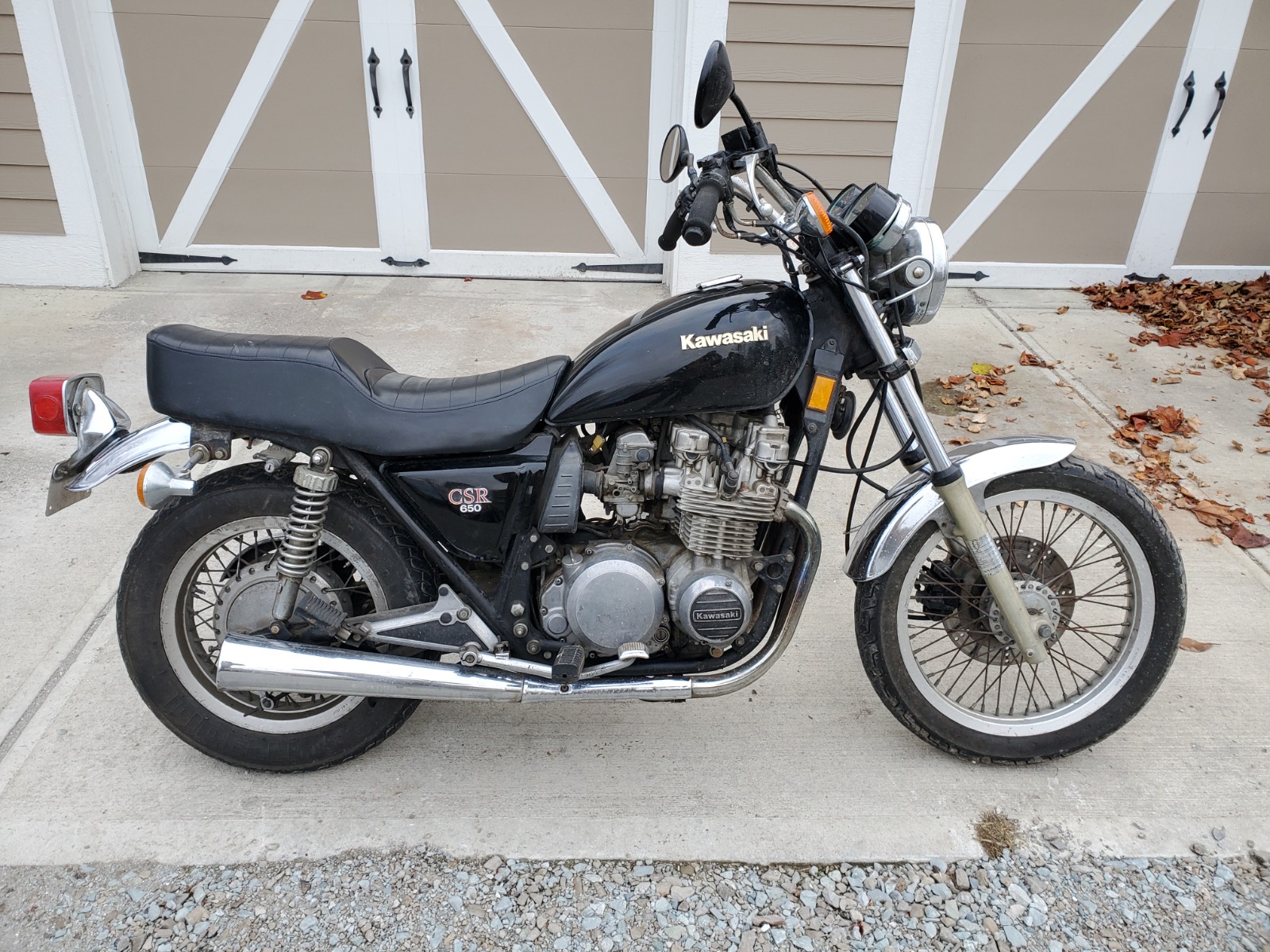

Hi, new member here. Live in Indy. Just bought my first roadbike, an 81 650 CSR. (Personally I think it's the ugliest bike made, but it's mine...) Been a dirt bike rider since childhood, but have been borrowing my brother's 1000 LTD. This 650 belonged to a buddy who bought it new and sold to me. It's in great shape and I plan to customize it a bit. Glad to be here to learn as much as I can about this bike and what others have done similarly.

Howdy. You won't get any argument from me as to whether or not the csr is the ugliest 650. I have one. ha ha.
But the KZ650-CSR has a HyVo cam chain & higher redline than the earlier 650s. 3-phase charging system & electronic ignition. same as the KZ750-4s, in some cases identical. Same frame as the 750H Ltd, so you can swap stuff, such as the swing arm & rear brake. The 750E frame is similar, so some of that can be used >> I installed the muffler system. direct fit. The small csr fuel tank can be a drag, but you might be able to go with the 750E triple tree then install the E tank or possibly a GPz (the csr upper triple will bang against the E tank). The stepped seat on the csr helps to keep your butt planted when you give it some extra throttle. For a flatter seat I have a hunch that the E fits.
1981 KZ650-CSR w KZ550-Ltd wheels. 750E mufflers. 1000J mirrors. ZX10 rotor bolts. ha ha.
1st pic has BMW med tall street bars. 2nd pic w Emgo Euro bars, K&G luggage rack.

I don't think they're ugly just they tried to catch a share of the cruiser market. Like one of our members said, "chrome won't get you home"
