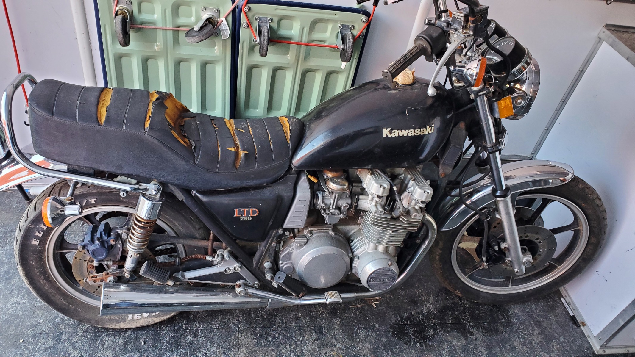

New member of this forum! I bought a couple months ago a 1982 KZ750 LTD. I have been gathering as much info as possible on the web and, particularly, on this forum and thought it was time to join and introduce myself.
I'm in Ontario, Canada and, yes, it's winter and can't ride.
This is not my first bike and not my first rebuild. I rebuilt a 1979 CB400T a coupl years ago and turned it into a Cafe with the help of their forum and I know how important the bike community is. I intent to do the same with this bike, Cafe or vintage look, I haven't decided yet!
For the bike: Paid $450 CAN for it and has 17000km, but the speedometer is missing, so not holding my breath on it. But for the general condition of the bike, I don't think it has many km's. Sadly, it was probably sitting in a humid environment for a while. I unseized it easily with oil through the spark plug holes and a ratchet on the crank a few days later. It looks like it has compression, but will do a complete top end rebuild (that will be my first time), honing the cylinders, new gaskets, new rings, lap the valves and new valve seals. The exhaust it garbage (humidity did the job). It has lots of holes everywhere, so I bought a good used condition MAC 4into1 with a Vance and Hines muffler off ebay. I know most of you guys swear by Kerker, sorry! Really excited about that, my first 4 in-line with a 4into1 exhaust! I have gathered as much info about KZ as possible as I know nothing about Kawasaki bikes. I sourced all the parts I will need for the Cafe/vintage rebuild. But sadly, I will only start on it next Fall.

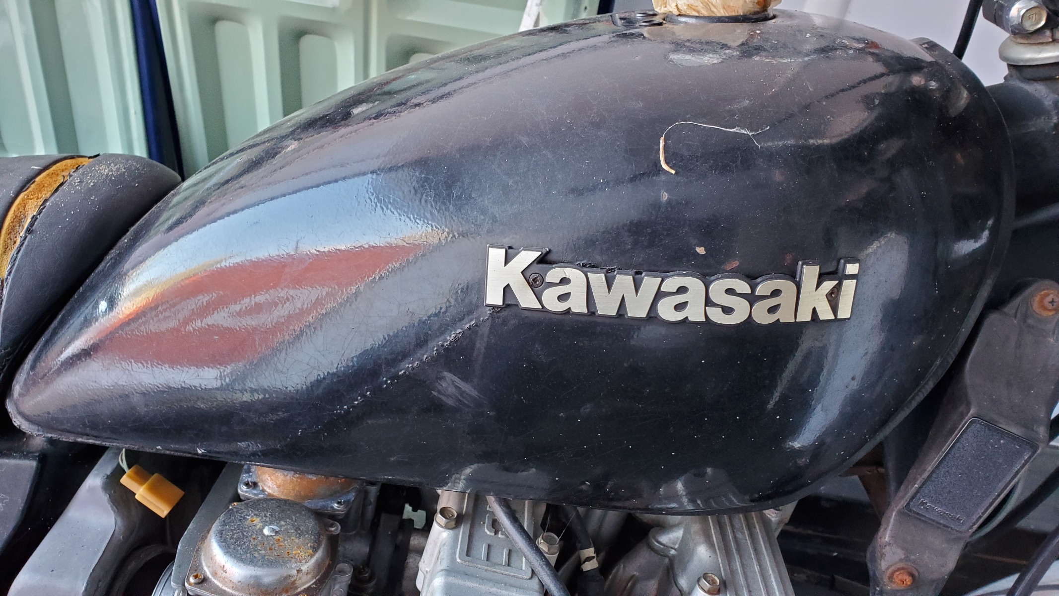

If someone can tell me what is the line on the side of the tank. It has it on both sides at the same place, nothing underneath the tank though, and I can't not see why.
Thank you for your support, expertise and for welcoming me

Here are the pictures. I downloaded a PDF manual and can't wait to get my hands on it. I love working on old bikes.

Looks like those "lines" are decals painted over. That would make it a CSR?

Never thought of that!
I will strip the tank off this summer and see what it is.

Bike looks pretty good actually apart from the obvious seat and tank. Like Steve said the ines are probably from a decal and paint job. However, I think the CSR 750 was twin and LTD is correct.

From the muffler stay, frame grip, side cover & seat, the motorcycle appears to be a 750H Ltd chain drive. As for decals being painted over, the 83 750 Ltd Shaft had tank graphics like that, so maybe somebody swapped fuel tanks. The 750K Twin Ltd-Belt also had graphics like that, but the rear mount is completely different & the Twin didn't have the low fuel switch (your tank has the tell tale pigtail from the switch).

It is definitely a LTD. Tank could have been swapped for sure. I can see it was dropped on the left side from scratches on the side cover and clutch lever. The tank has the low level switch underneath it and has the right bracket to attach it to the frame. If you look closely, you can see the line is along the emblem as well, I don’t think a decal would go there. Will have to strip it and see.
