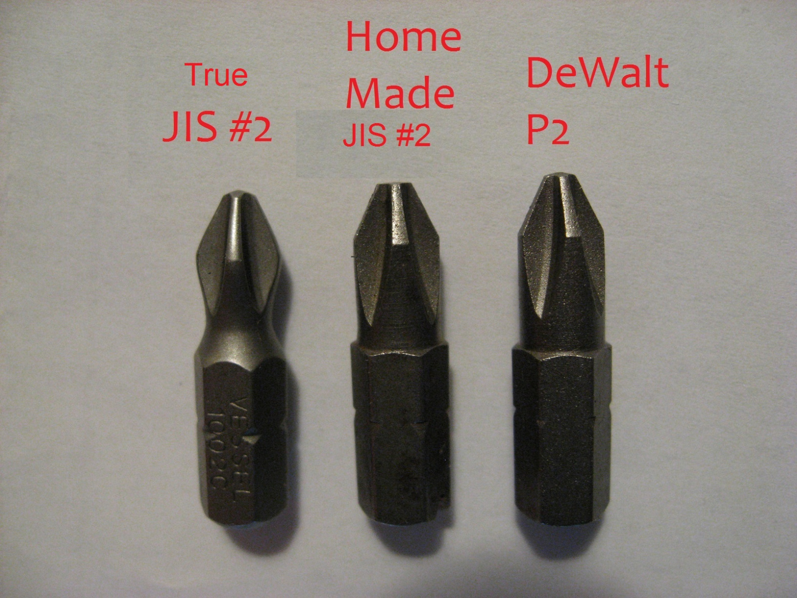

Welcome aboard! You stated " I replaced all those old Phillips, soft head screws that were nearly worn out with the hex head stainless. Looks better and MUCH easier to open the case now."
The reason those screws were messed up is that they are NOT Phillips. They are Japanese Industrial Standard (JIS). Using a Phillips screwdriver on them will wreck the screw heads because the Phillips driver will not seat properly in the JIS screw heads. Use a JIS driver on them and they will last forever with zero damage. One can very easily modify a Phillips screwdriver to make it a JIS shaped driver. Most folks do not know this; I found out the hard way too. Ed
JIS screwdriver bit
JIS screwdriver bit

Thank you very much for this information. In fact, I did mess them up one bolt so bad I almost did not get it off this year to swap with the hex bolt.
And, on this forum, in the last two days, I did run across the JIS reference and began to realize my long time mistake.
I assume that the screwdriver set that came with the toolkit is JIS? I will use those, always, going forward on any screw on the bike.
I have the complete toolkit that came with the bike so if those are JIS I should be OK. Is there a source for JIS bits so I can use a torque wrench?
Thanks for the detailed explanation and the great drawing. Invaluable information. Thanks for taking the time to post it. Yes, I was ignorant of the issue.

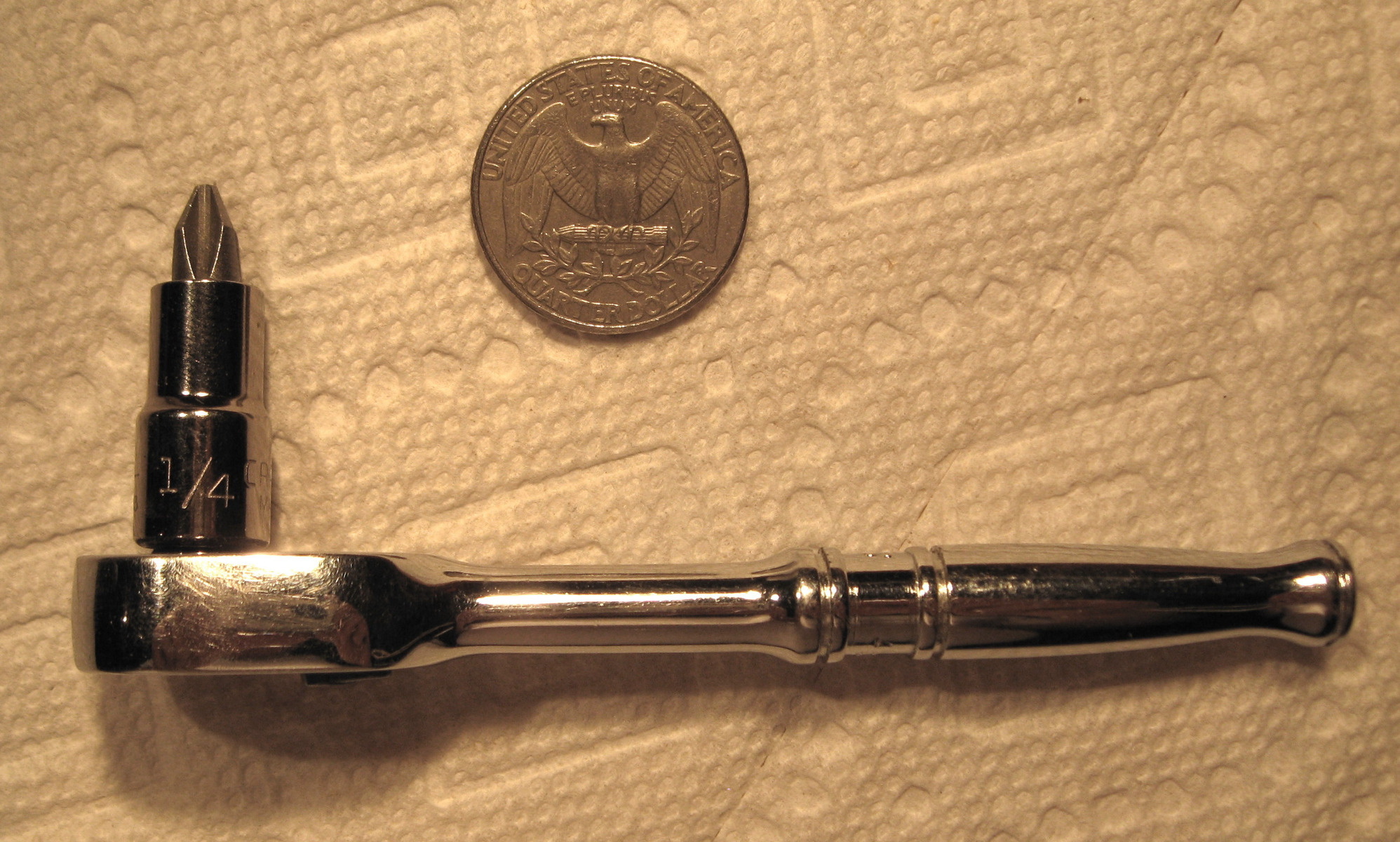

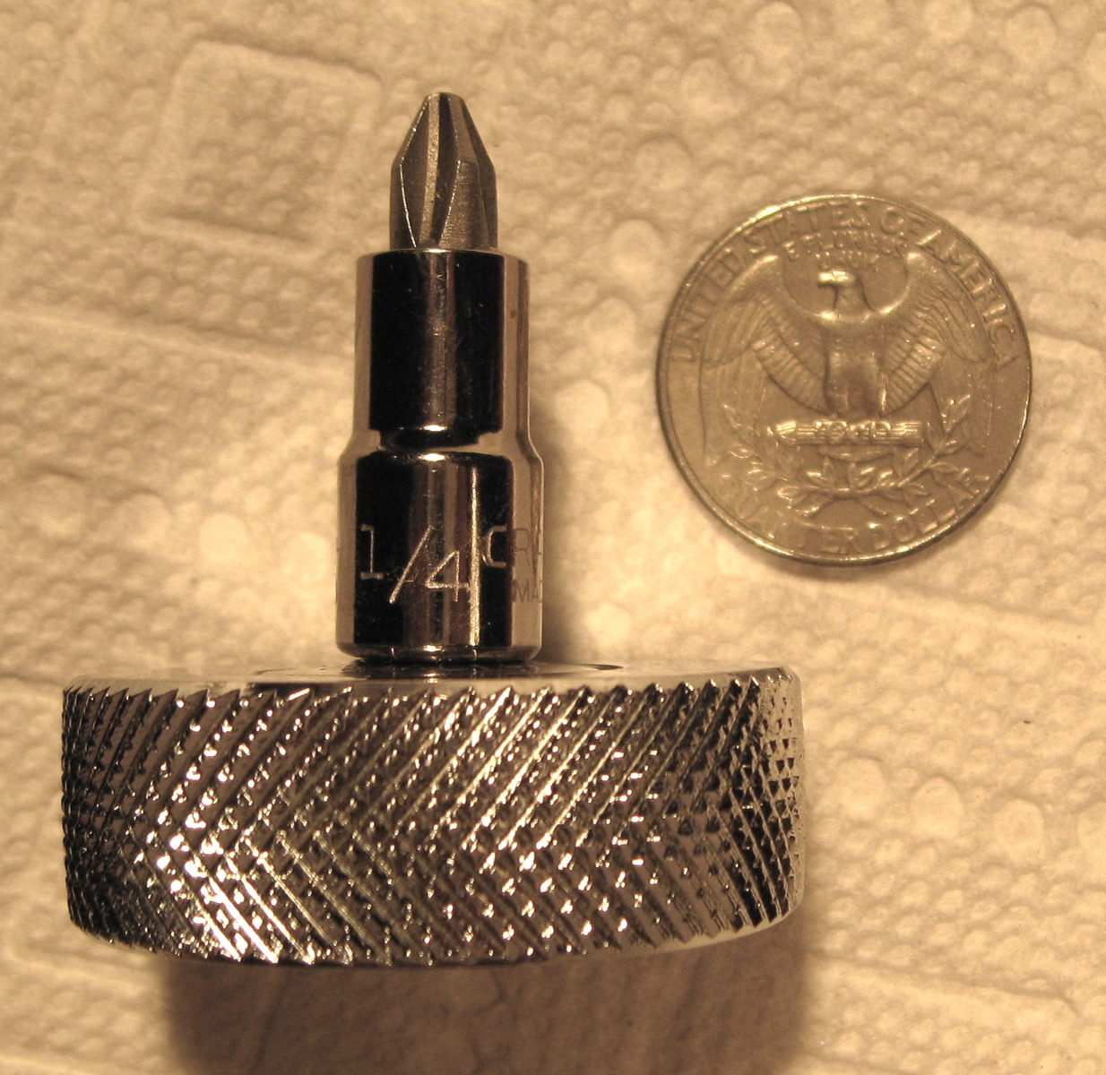

Vessel and some other tool manufacturers make JIS screwdrivers; they can be found online. However, rather than buying them you may want to modify a few Phillips screwdriver tips to the JIS profile. That's what I did before I found places that sold JIS drivers, and frankly my home made drivers work as well or even better than a few of the JIS drivers I bought. It's really just the tip of the driver than is different. The image below show the true #2 JIS vs the homemade #2 JIS vs the DeWalt P2 Phillips. The homemade #2 JIS was done by starting with the DeWalt #2 Phillips driver. I just carefully ground off the tip of the Phillips driver while very often testing it in a Kawasaki screw to see how well it fit. After doing that with a #2 Phillips I did the same with a #3 Phillips and a #1 Phillips. The key is to take your time and check the fit often. The homemade bits actually fit the Kawasaki screws a little better than the official JIS drivers, and making them cost a lot less than buying the JIS drivers. The last 2 pictures show what I use to hold the screwdriver tip when using them. Ed

Regarding your post of how to make a JIS driver bit, I plan to attempt what you describe with my old impact driver set in the next two weeks. Excellent information and procedure, and, also, excellent photographs. Thank you for taking the time to post all of the JIS information. I have owned the bike since 1992, for 28 years, and, never knew this. Too bad. I would have rather had the original screws but the stainless hex screws I just put in are very nice, and, give a good look to the case on the right side. I did not do the left side yet with them. I may not. I did save the old screws, but, all of them are partly buggered from changing the oil filter multiple times over the years.
Thanks again.

Do yourself a favor and get some genuine Vessel JIS screwdrivers. Quality tools are always a worthwhile investment.
