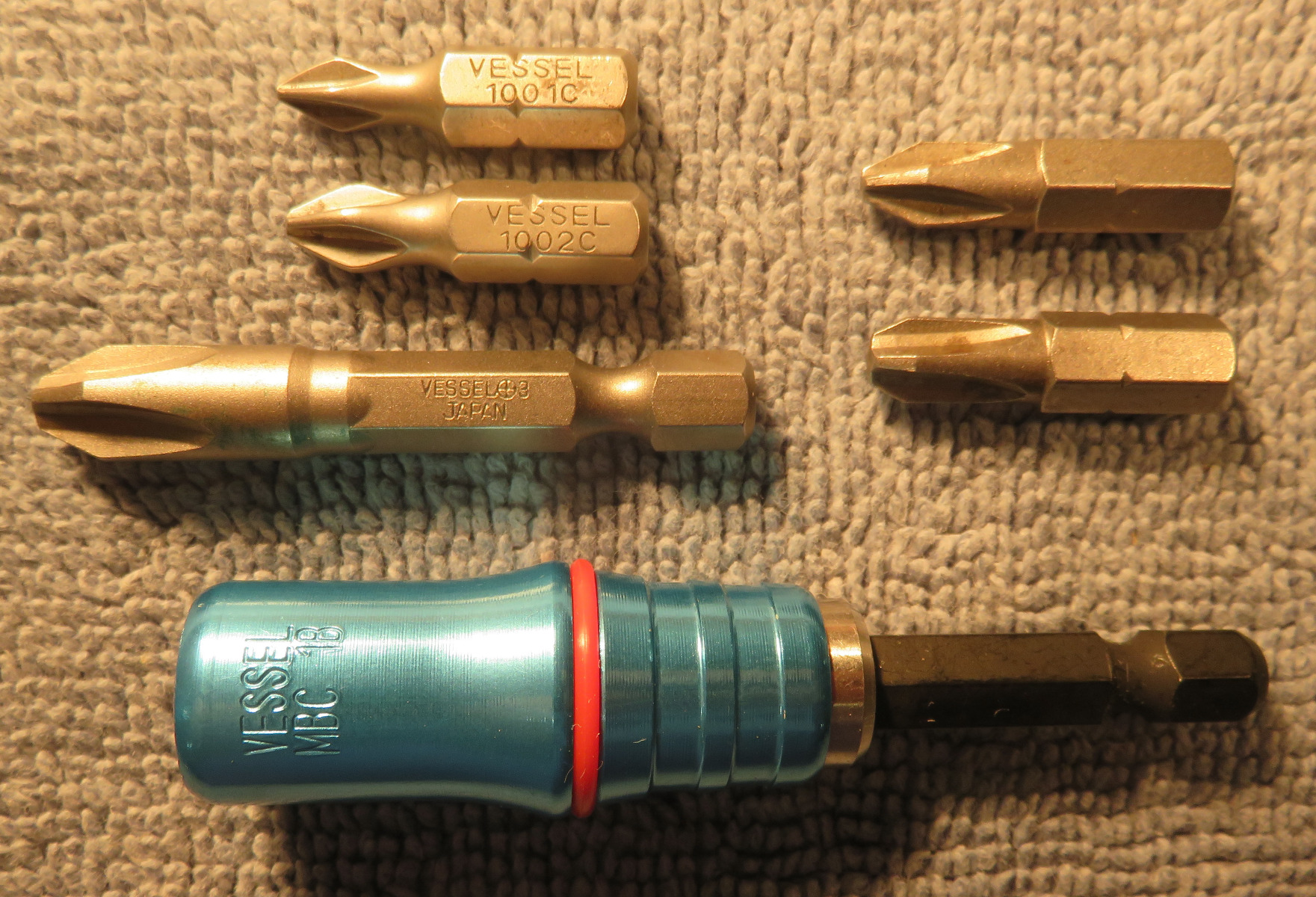

Vessel makes very good tools and their screwdriver JIS screwdriver bits are very likely the best one can buy. I bought a set, but I actually found that my home made bits fit the Kawasaki screws a little better. Of course, I took my time making the home made bits from regular Phillips bits. The first image below shows a comparison; the tips of the Vessel and home made bits look and are very similar. The second image below shows a home made bit in Kawasaki screw. It fits so well it actually will stay in place without being hand held. I found I cannot do that with the Vessel bits, although they also are a very good fit; in fact they are a far superior fit than any standard Phillips bits. I suspect the key to making home made bits that fit the screws really well is taking plenty of time to check the fit as one modifies the Phillips bits. If one cannot take the time to do so Vessel bits are the thing to buy. Ed

Many thanks for the pictures of the Vessel bits compared to your home built bits. I can see yours are sharper and not rounded at the apex, no doubt allowing more torque application without potential for rounding.
I will take a look at vessel, and, since I find myself at the moment with a bit of time, I will see about building one from a Phillips bit.

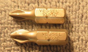

I looked at the VESSEL website, and I believe they stopped selling JIS screwdrivers. Notice they no longer mention JIS on their website (at least my search didn't find any mention). Also, the model numbers of screwdriver tips look like they have been discontinued. Below are a couple of the JIS tips I bought from them long ago. I do not see the same tips being offered today. Ed
