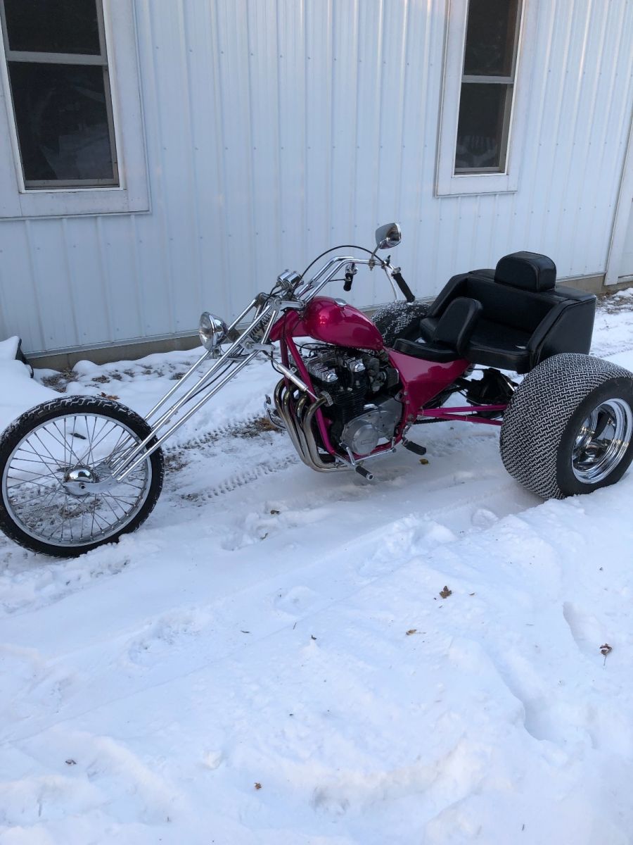

Hello all, I am new to kaws, and lots of good info here . Got a 1974 z900 with a 1000 top end and unknown internals.Also its a trike with a servi-car rear(51),and a girder front.I am sure I will ask and learn a lot here.

Welcome fellow Michigander. Unusual KZ but looks well built. I bet it draws a lot of attention.

Dual rear brakes and an articulating blade out front? Great looking ride man!

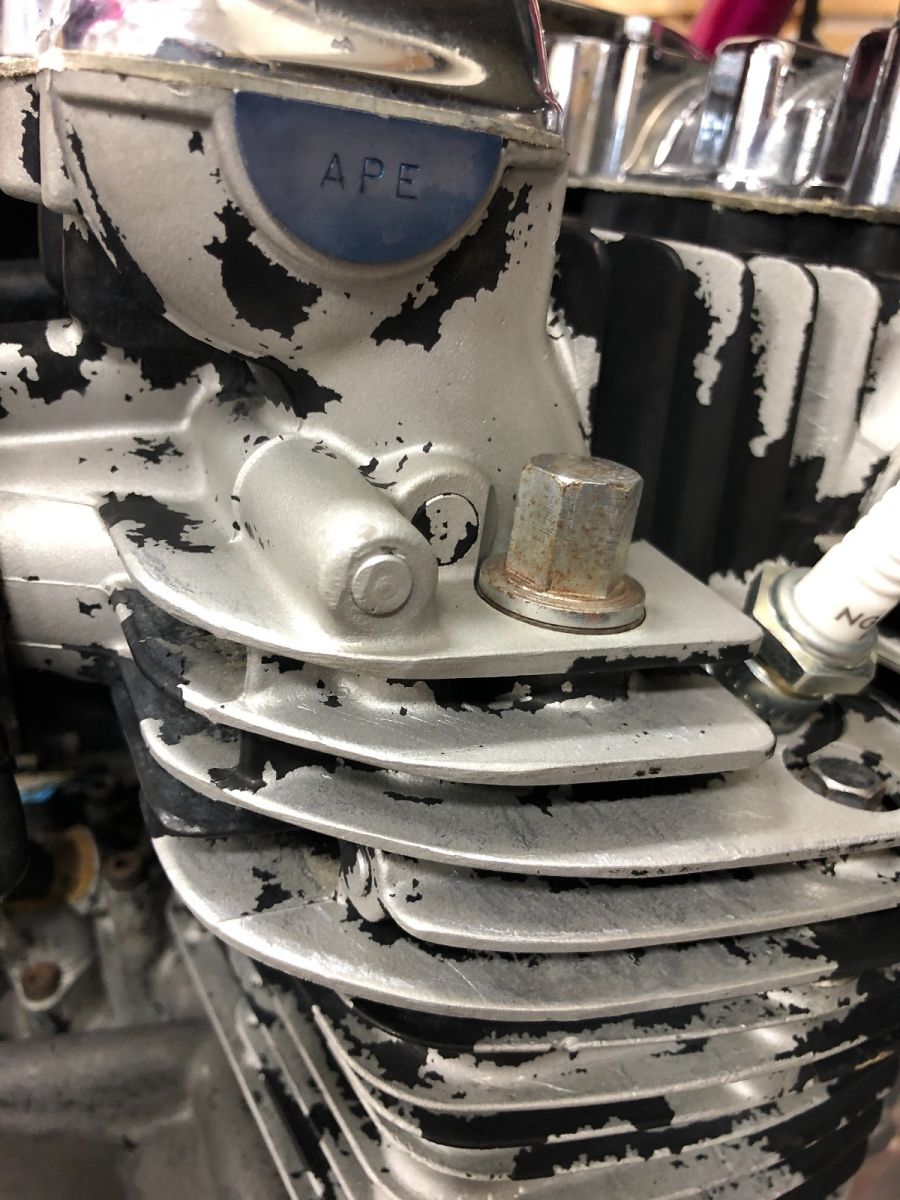

After a good power wash, ( still some paint left, this is mid process)the cases are old gray. The top end is clean. Im doing a full tear down and don't know if I'm going to polish the cases or do a chrome powder coat.Jugs up will be clean cast, then polished covers. I got a baldor and I use it ! I really bought this thing for a winter project, and now I am constantly thinking about whats getting done tonight!

Welcome aboard! I see APE cam end plugs. They make some really fun stuff for these old engines, I wonder if there is more inside?

Back in the day I knew guys that painted the motors so they didn't have to clean them and usually it was done with the motor still in the bike.
After all these years it turns out that the paint was a good protector of the actual finish and comes off easy.
If your going to repaint you could use a media blaster to ruff it up but if you are going to keep it bare aluminum I would stay away from anything that moves or changes the original finish, aircraft paint remover works well for this.
