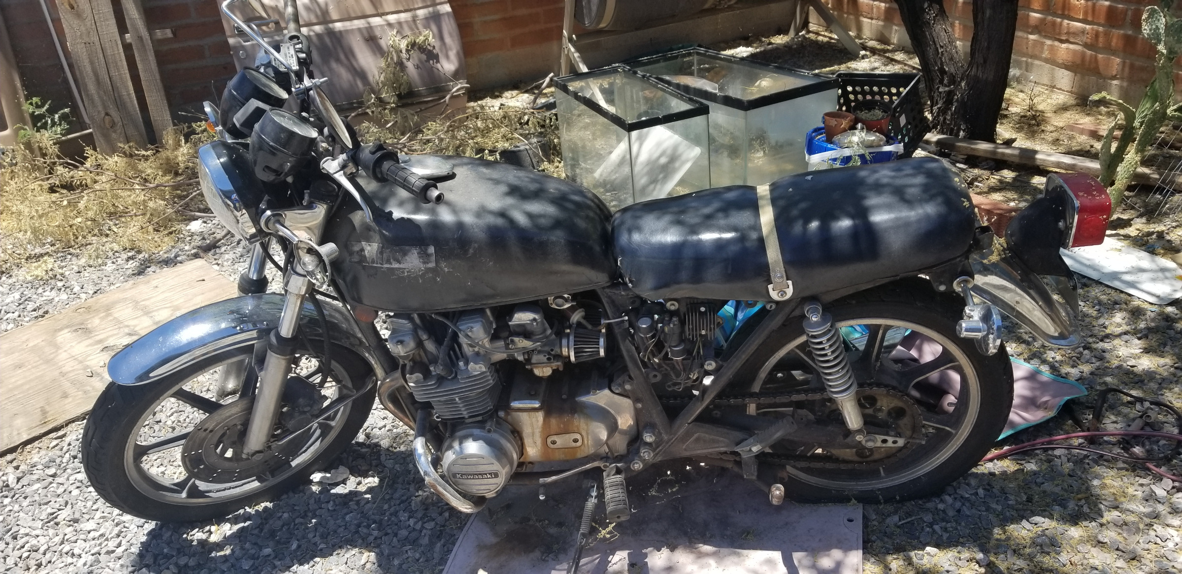

Howdy folks,
I've been searching for a motorcycle for a while now. I don't have an enormous budget but I stopped today at the local used tool store and saw a old bike under a pile of stuff in their back yard. I asked about it, and one of the guys had bought it as a parts bike for his other KZ650 that was his daily ride. He is asking 600 for both of them, as he got a harley and no longer rides the KZ.
It sounds like a pretty good deal to me. He said that the one he was riding had developed some backfiring issues but would still run (leaky carbs perhaps??).
I am posting here to see if there are common pitfalls to avoid with this particular bike; I am pretty mechanically inclined, have worked on carbs before and rebuilt them, but never on a motorcycle. I should mention that I am a machinist and may be able to make some parts that need replacing. The bike looks decent, will need at least a new rear tire.
I would appreciate any thoughts or advice before I either: Get a great deal, or get a money pit (lol)

The 650 is a solid as any of the KZ line, and there are several enthusiastic owners here.
Some things to look for are rust inside the fuel tank, does the engine turn over, is there oil dribbling down the forks, does the bike roll ok, check the frame around the battery box for rust, check the frame crossmember where the lower run of the chain goes over it to see if a too loose chain has been cutting into it.
If you are planning a full restoration on that one, be prepared to spend a good bit of money. If you are just looking to clean it up cosmetically and insure that it runs good, it might be a good deal.

One issue on the 650 that is harder to fix than on the 900/1000 is the starter clutch. That is for the electric-start. It requires removing the oil pan to work on, which is a bit tough while the engine is still in the bike.

Do you have a garage or good work shed? Tools? ..... $600 for 2 KZ650s sounds pretty cheap. But depending upon how industrious you are, getting one of them road worthy could take another $500 or more especially if it needs tires. I'm assuming the "daily ride" has been sitting & will need work. Battery, oil, filters, lubricants, thread lockers, etc etc etc plus tools can add up pretty quick. If I had to do it over again, I would've sold my 650 & gotten a ZRX or something.

22 Jun 2019 12:56loudhvx wrote: One issue on the 650 that is harder to fix than on the 900/1000 is the starter clutch. That is for the electric-start. It requires removing the oil pan to work on, which is a bit tough while the engine is still in the bike.
I've removed / reinstalled an engine from a 2002 GSX-R1000 for a friend of mine, and basically assembled his whole second bike from a frame and two wheels and tubs full of parts, so I may be able to pull the engine if it needs it. Could I just use the kick start until then?

As far as starter clutches go, one from a 2000-2005 ZR 600 or 700 is a bolt in. Put 6 speed in a KZ650 in the search and a thread has very good info on it. I put one in my '82 750 GPz engine while it's in the frame.

Yes, the kickstart will still work fine regardless of the starter clutch.
