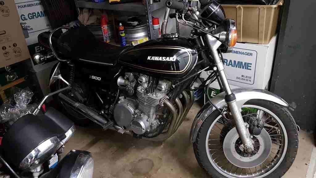

Hello, new Z rider here . but a longtime enthusiast .
Just bought the Z900 in the picture to revive.
The core is solid, but she's been neglected for a while, so needs a thorough going through. First step is to free the brakes , next will inspect/ clean the carbs , change the fluids and get her running. At first I thought I'd have a lot of work with rusty parts but it seems I'm just in time and all she needs is a good cleanup.

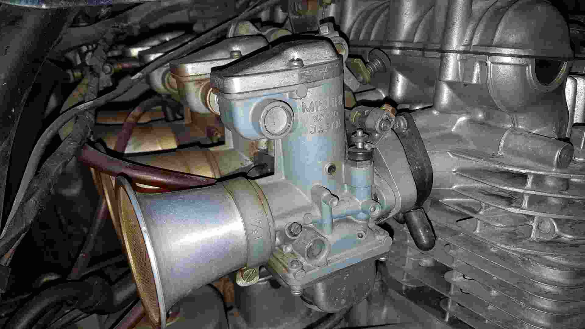

Sadly the airbox is missing and all she has for filtration is the gauze over the bell mouths.
Can anyone help with ID'ing the carbs? Are these the standard 26 mm ? Thanks in advance.

Howdy. I don't know what carburetors they are, but I think maybe VM28s. ??? .... my identification cue is how the rock'em sock'em robot chins jut out over the intake ports.

Ah OK thank you. I was confused because of the large single nut on the underside.

Early Z1 VM 28 carbs. They're worth money. The KZ 900's came with VM 26's. May be able to sell the 28's and buy 26's with profit left over. The 28's are hard to keep in tune but otherwise are good carbs. Your choice. You can get a aftermarket airbox for a Z1 that will work well and a reasonable price. The first thing I would do is check the valve clearances.

I think I'll keep them. I also have a Z1B frame that I might use them for.
