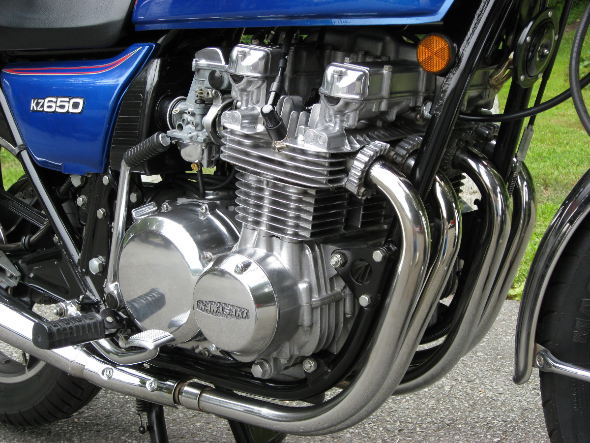

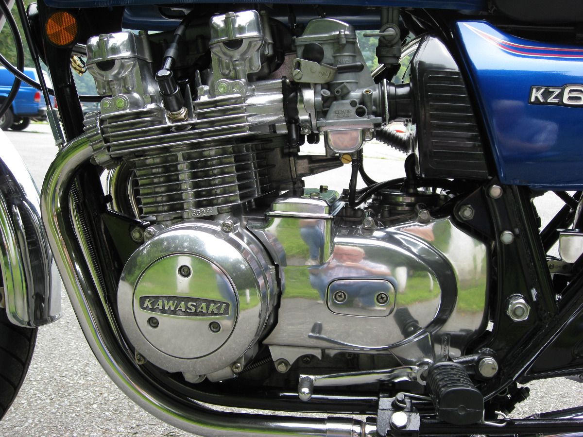

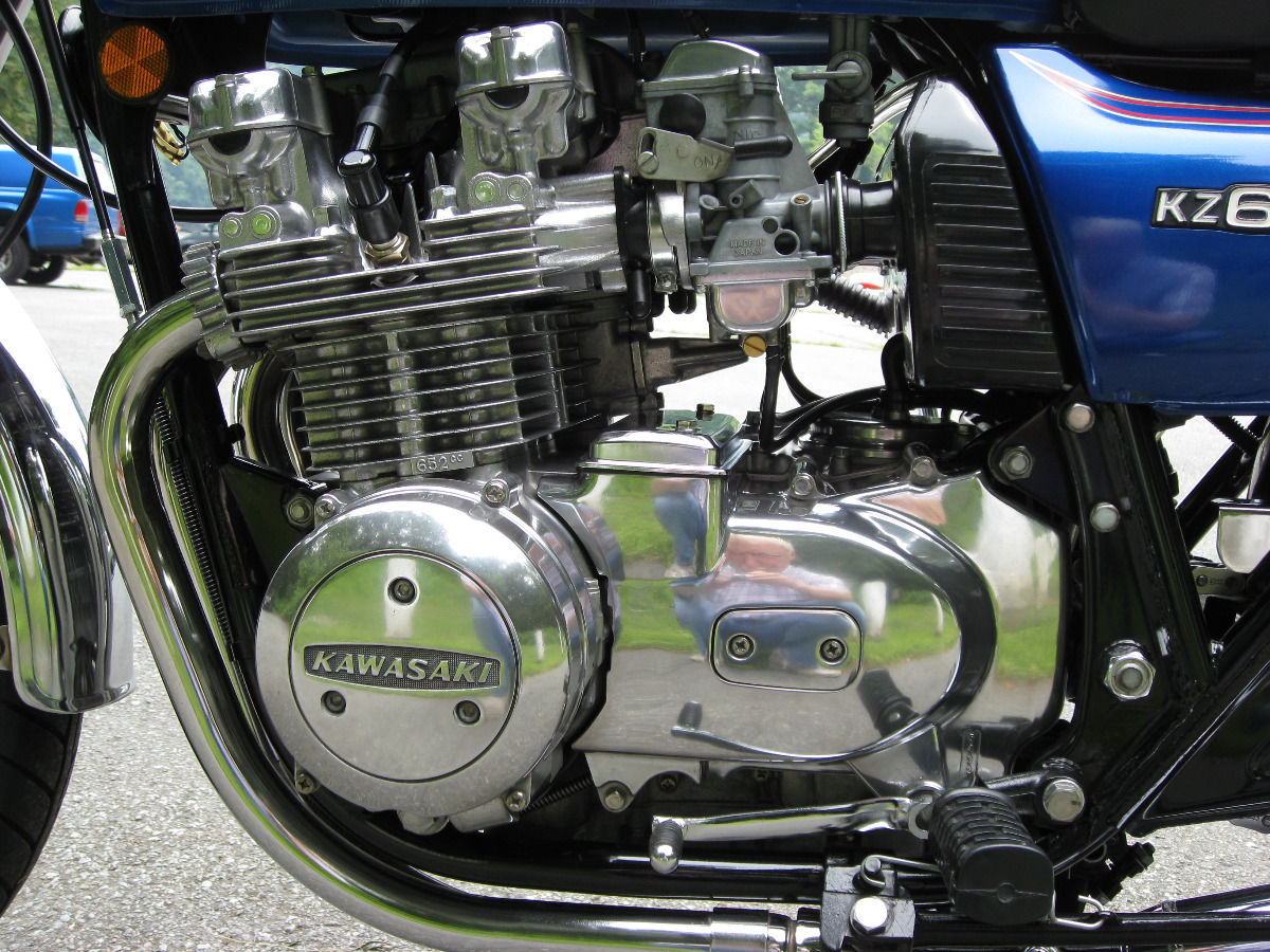

I'm not intending to remove the heads or block as the bike runs quite nicely. The work I will be doing on the engine is to clean up and polish such parts as the cases and smaller parts.

BruceKoukalaka wrote: I'm not intending to remove the heads or block as the bike runs quite nicely. The work I will be doing on the engine is to clean up and polish such parts as the cases and smaller parts.
So why would you pull the engine, just to clean and polish it? Yikes! Trust me, you can clean and polish the engine without removing it or removing anything connected to it. Ed
