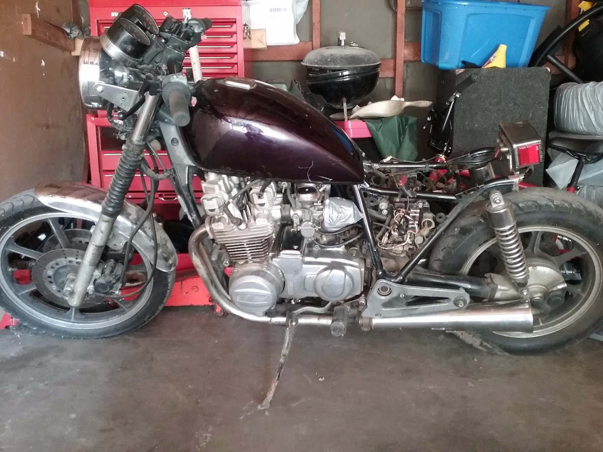

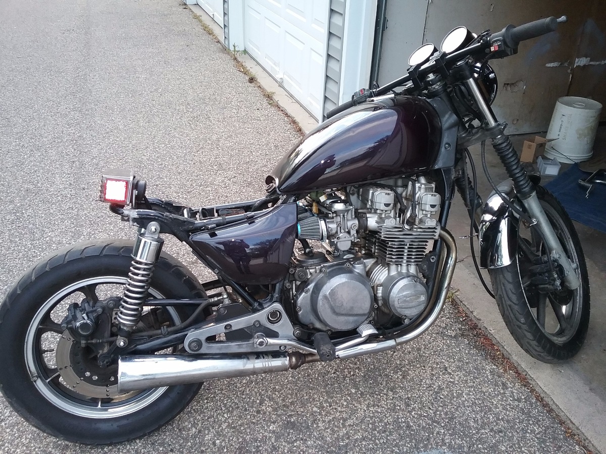

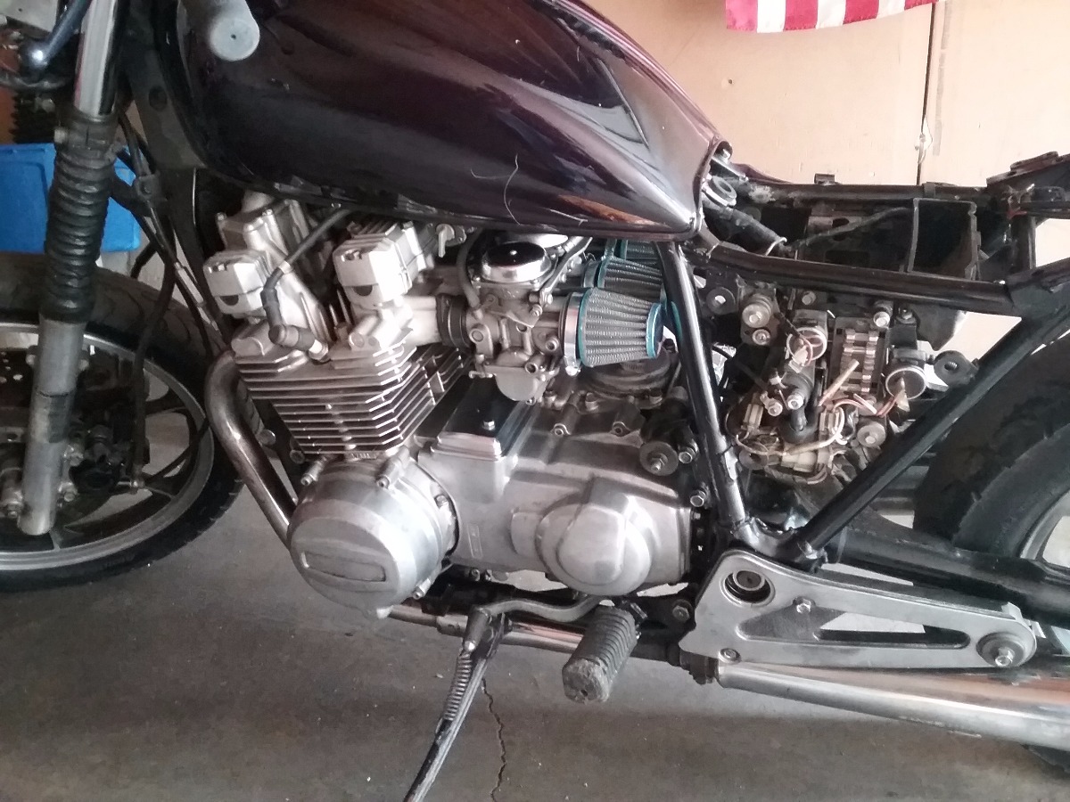

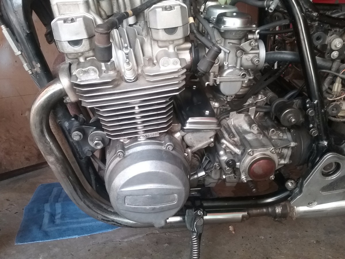

I've been lurking on here for a couple weeks, and I was kinda impressed with the layout and information on the kz's. So I decided to join up. Thank you mods for keeping this site rolling.
Anyhow, my name is Josh I just got an 83 kz750 ltd shaft (f1) for 200 with a clean title. P.O. got it from a guy who was going to Bob it. Said it needed a gasket due to oil leaking. He said it was the lower case. Well, I found leaks at the shifter shaft seal and the secondary shaft seal. Also said it cranks but doesn't have spark. I found an ignitor in the bucket of parts, hooked it up. It needed a battery, so I bought one. 33 bucks on sale. Fixed some wiring, charged the battery and, low and behold, spark. Ok. It needed a seat, found one last night, ordered it up.
Now I tried to fire it up but it was a no go. So as of now I'm waiting for a pilot jet that I found was stripped in the carb. Keihin of course. Found one tonight, ordered it up. Atleast I only had to drill the one out, somehow thankfully I didn't mess up the threads. I took the other ones out just to make sure they wouldn't strip. They are good to go ( after I clean the green crud from them)
And that brings us to this moment. Where I decided to join this wonderful site. I bought the bike as a project of course, and I was weary at first but with the forum here, and search functions I've learned quite a bit about these bikes. So thank you.
Adding a couple pics out of the 50 or so I have so far.

Thanks fellas. I would try the starting fluid/fuel trick but I have the carbs sitting on the table. I started cleaning the one and got to the point where I need to figure out a way to get the carb bracket screws to come out. Plus I've been reading the forums learning about these carbs. Quite different from the mikunis I learned on. Found out I have to drill out plugs to get to the idle adjustment.
Anyway, I'm still reading through the oh so many pages of info. Feeling like Johnny5.
Oh, and to answer a quick question, the pilot Jets are clogged, green crud all over, ran thin wire through most holes.but the issue I need to deal with is to get the carbs separated to replaces the o-rings on those two fuel overflow t's in between said carbs. (JB weld is the very last resort) But since this is the new member thread I will cease on the shop talk.
By the way, I live in burnsville.

Just a quick update---- IT'S ALIVE!!! Took it around the parking lot a couple times before I replaced the shifter seal and the secondary shaft seal. Also took out the emissions junk.
But now I'm waiting to see if the leaks are fixed. Either way. Last post about the bike in this forum. Didn't want to start another thread. (Sorry mods)
