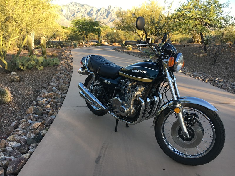

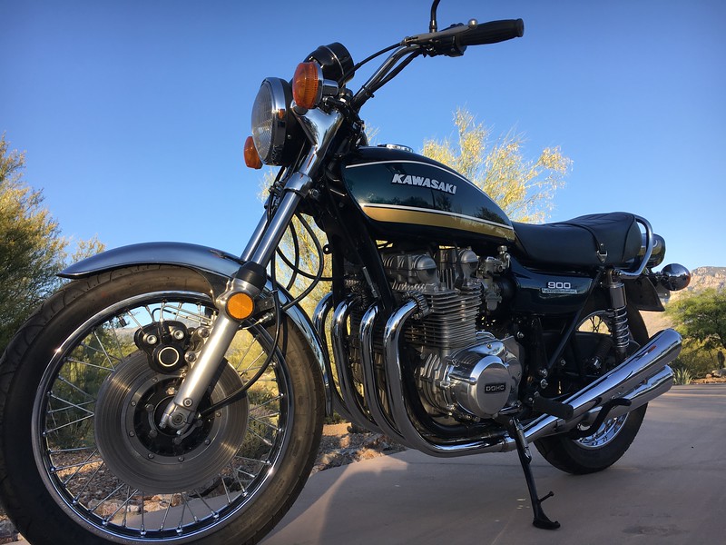

Hi Tim,
There are date codes on most major components. A knowledgeable buyer will be looking at those. If it's in good condition, complete, original & unmolested, original paint with little/no sun fade, owners manual in GC,, complete original tool kit, and any other period items like the Kawasaki-branded polishing cloth, $12K isn't unreasonable in most markets.
If above describes the bike, we'd just give it a good detailing and leave it in unrestored original condition, especially if it's going to be a rider.
If you decide to sell it, please post it here first. Too many Z-bikes are being shipped overseas. Makes things difficult & expensive for U.S. hobbyists.
Good luck!
Good Ridin'
slmjim & Z1BEBE
EDIT: We realize the above description is quite specific. However, considering a one-owner bike its not unrealistic.
