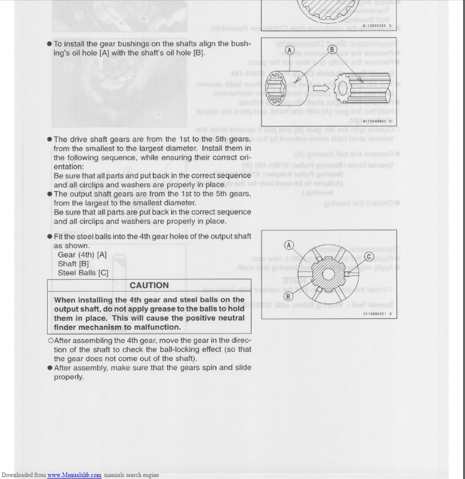

(not able to switch through gears when tje bike is not running). I've hear from another kawa rider on youtube Ron Schmidt that this is normal behaviour for a Kawasaki KZ 550 ? This is me:

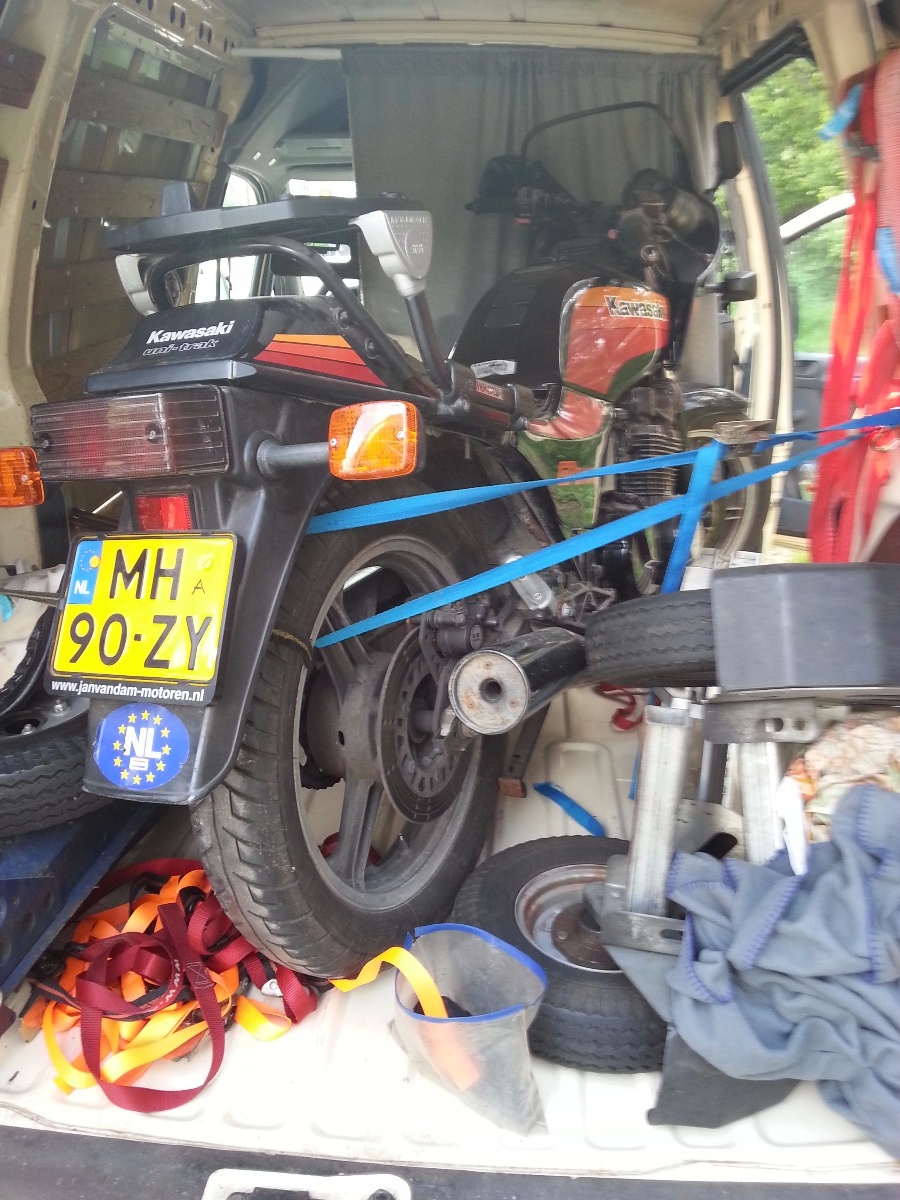

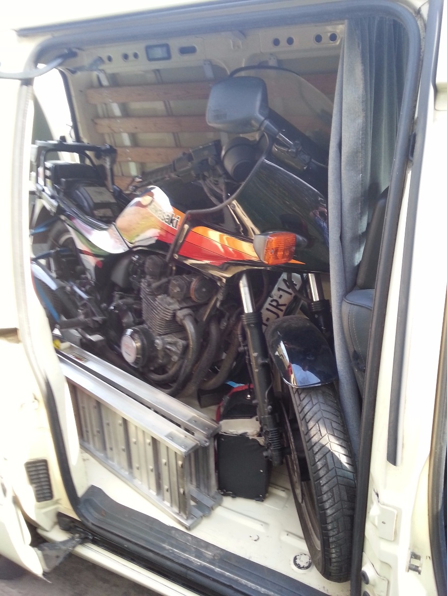

I no longer have this beemer, but this is my Kawa (picked it up in my van):
GPZ550 (ZX 550) 1984

Hello and welcome Rob
Yes this is normal. If the output shaft is not in motion or rotating you can“t get normally not into the higher gears (2nd and up).
There are 3 steel ball in the gear box that block the gear shaft.Only if shaft is rotating the balls will by centrifugal force let you shift.
