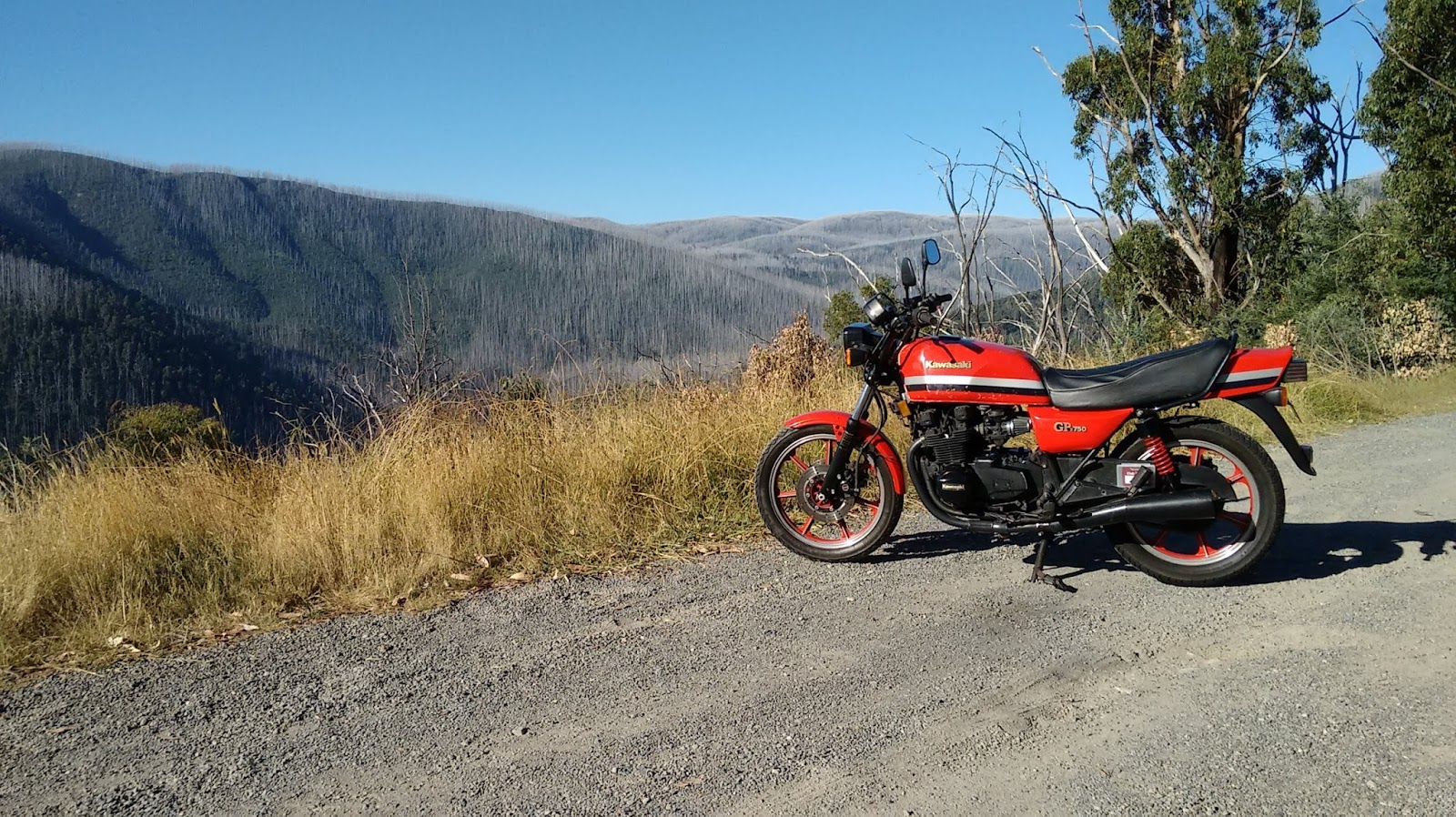

Recent pics.... and some dramas ...
- Rode to PI with the wife for lunch and it decided to die halfway. Spent 30 minutes in hot weather to find out the main fuse holder/electrical stuff is corroded. I might redo the whole electricals
- The engine had always been rattly so I took out the camchain tensioner. Whoever did it missed putting a washer on the stop-bolt, enough to jam the mechanism, a.k.a. it had been running with no camchain tension! Now all is good
- Installed some new niceties such as hand grip warmer, GPS holder, USB power. I hope to take to to the Alpines this autumn.
- Carb balance is out of whack so I am waiting for carb sync tool from ebay
Let the good times roll...

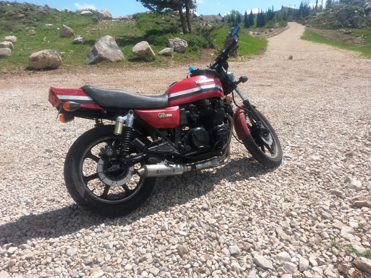

I lowered the headlight, instrument cluster and handle bars too. I thought about a bullet fairing but I'm going to fab a streetfighter-ish cowling instead.

21 Mar 2017 18:27Your rear tyre looks nice and fat
gpzninja.blogspot.com.au
- GPzMOD750
- Posts: 1365
- Thanks: 148
Re: New GPz750 R1 owner
21 Mar 2017 20:08HeavenlyMachines wrote:
Your rear tyre looks nice and fat... what size is it?
It's only one size wider than stock 130/90-17 IIRC. I unintentionally replaced it just after these pics with the stock size IDK if that contributed to me laying it down a month later or not...
