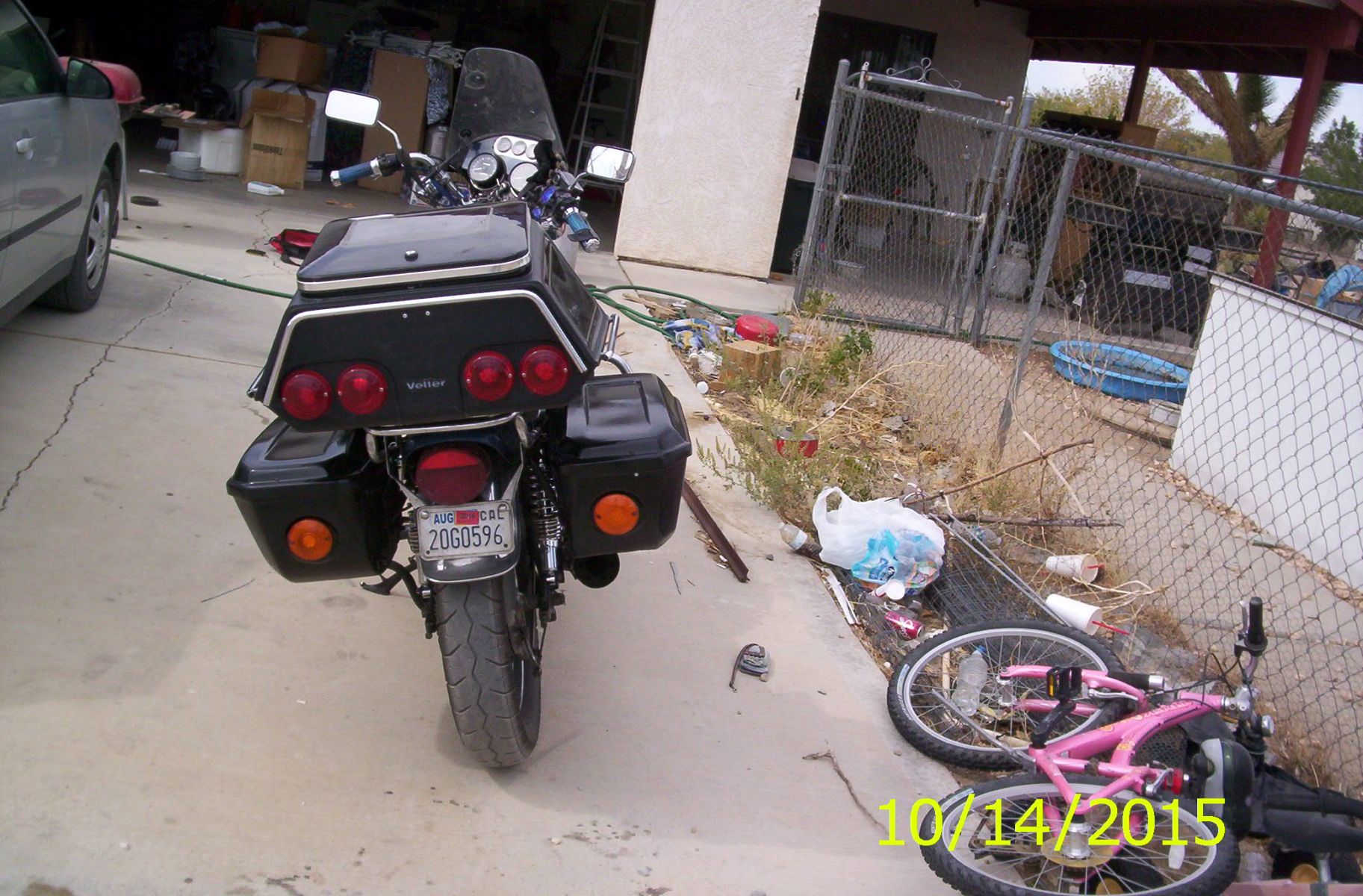

Mine was a 900 when I bought it new in 75. Took it out to 1015 in 78. Been adding to it ever since. Never regreted it.
