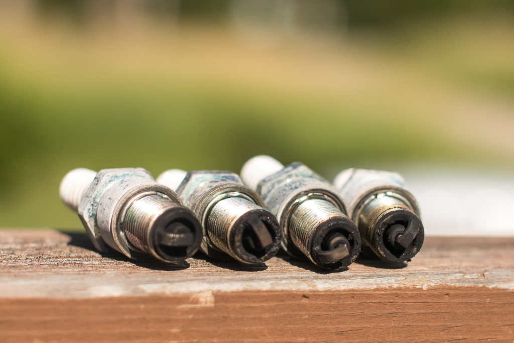

I cleaned off the stuck gravel on the front and underneath the engine, and now it won't turn over. Pretty sure some electrics got wet but haven't a clue which ones. I thought I was being really careful and all, and now the battery's weak and I'm charging it up. I'm gunna wait and see if it dries out and try again tomorrow. If anybody has any helpful tips though I'd appreciate it.

Check and clean all the plug in connections.

27 Jun 2015 15:42 - 27 Jun 2015 16:20swest wrote: Check and clean all the plug in connections.
"Ding! ding! ding! ding! ding!!! We have a winner!!!"
After carefully listening it trying to turn over, it sounded like only one cylinder was firing. Picked up a set of plugs and changed them out, found the old ones looked pretty bad. Crossed my fingers and it started right up. THANK YOU!!

Looks like it needs to be blown out. The plugs are loaded up from not being run like it should.

27 Jun 2015 18:07swest wrote: Looks like it needs to be blown out. The plugs are loaded up from not being run like it should.
I'm glad you misunderstood me. I meant all your connections.
Please explain what you mean that needs to be blown out, like fully disassembled and cleaned out?

No, these bikes are made to run. If I do too much city riding, it starts to run crappy. I have to get on the FWY and "Blow it out." The on ramp is a good place to do it. I love it when I see a few cars and semis cruising at 65/70, I grab a hand full, overtake them, pick my lane and lazily put it in 5th. Pisses some off. So what. :whistle:
