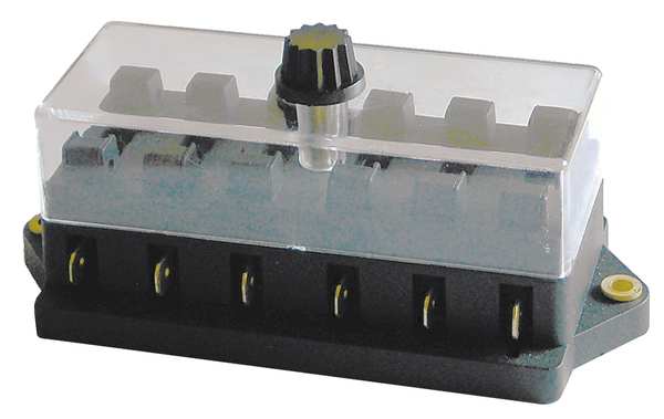

13 Jul 2015 22:32 - 13 Jul 2015 22:37SmokyOwl wrote: Well I'm pretty sure I've found the problem. Fuse was out. Previous owner took out the rear taillight assembly and it was replaced. Fairly certain when this happened the fuse was blown, and the same thing happened to him as happened to me this morning: They don't make the fuse anymore. I searched 2 auto parts stores, 2 bike parts stores, ace hardware, and radio shack, and nothing. For the time being I put a 10 amp fuse in that's longer than required (proper amperage fuse though), and no problems so far. I did find a proper sized spare in the fuse cover, but I don't want to risk putting it in just to have it blow again as it's my only spare. Checked out the wiring in the rear and didn't find any damage, but we'll see what happens with the fuse I put in.
It was REALLY frustrating going through the multi-packs of fuses with 1, 3, 5, 7, 15, 20, & 30 fuses. If anybody knows where to get the proper sized fuse, please let me know.
Harbor Freight sells the glass buss fusses for cheap. The problem is they suck and are not easy to find, especially on the road. Do yourself a favor and update to a blade style fuse panel. You can buy the one shown at some auto parts stores for under$20. If you want to spend a pit more, there are some other options on this site: www.cycleterminal.com/fuse-box-kits.html
Once you do that you can do this to the old fuse panel
