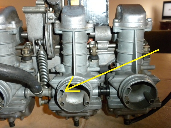

Welcome aboard! "78 ZR650SR" Typo? 1978 KZ650-SR which is officially the KZ650-D1 or KZ650-D1A depending on which carbs are on it. If it has the carbs with the orifice in the 10:00 position as shown by the arrow in the image below, it has VM22SS carbs and is a KZ650-D1A. If the carbs do not have that orifice it has VM24SS carbs and it is a KZ650-D1. This is important to know if you get into tuning the carbs. Also, here's a link that should be helpful when working on a KZ. Ed

650 ed...thanks for the welcome and the advice. Yes, sorry, it was a typo. Dyslexic fingers! lol KZ 650SR is correct. There is some confusion on my part about that too. The data decal on the neck simply ID's it as a KZ650D. It was mfg 10/78 but according to the serial number brackets I have seen, its actually a 79 D2! So I am not sure what maintenance manual to use...its very confusing.
I just looked at the carbs...there are only two "orifices"...one at 3 o'clock and one at 9 o'clock. I think its safe to assume these are not VM22SS's. I didnt see anything else on the carbs except for Mikuni Kogyo

Since your bike was build in 10/78 it is a 1979 KZ650-D2. It will have VM24SS carbs, the 22mm carbs were only used in 1978 and only on some bikes. The model years start sometime around August or so very similar to car models. That's good to know since you will want to get a D2 manual. One easy way to tell that your bike is not a 1977 or 1978 is to look at the rider's footpeg mounts. The 1977 and 1978 mounts are fastened to the frame with 1 bolt each. The 1979 and later have 2 bolts holding each of the rider's footpeg mounts to the frame. Regarding captcha; I've never run into that here. Are you coming into the site from a PC using Internet Explorer or Firefox? Ed
