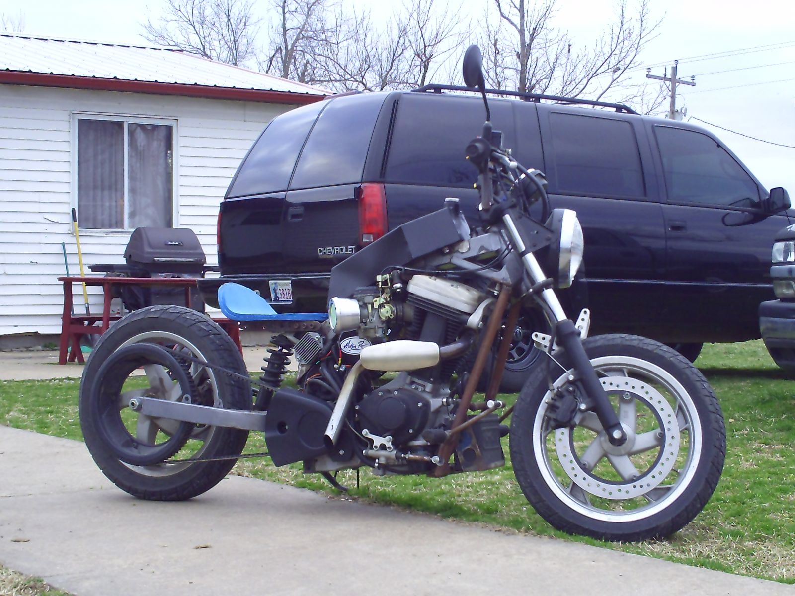

This is how she is sitting right now. (if the upload works)

It's a shame someone cut off your frame. That might have come in handy for installing the rear suspension and seat. Ed

with what you have there a direct acting shock,(kinda like the buell blast i have/am currently molesting)would be a real simple solution to your build.
easy,clean....
the shocks from any mono shock bike that doesn't use linkage(,just has the shock mounted between the arm and the frame),should work tho.
it seems like there is a yamaha 600 street bike that has a direct acting shock that some folks have used.
i am not sure exactly which model tho sorry.

Awesome thanks, I was tryig to figure out if I was gonna need to linkage or not. I was hoping not so I can use the stock swingarm. Gonna dig into that asap!
