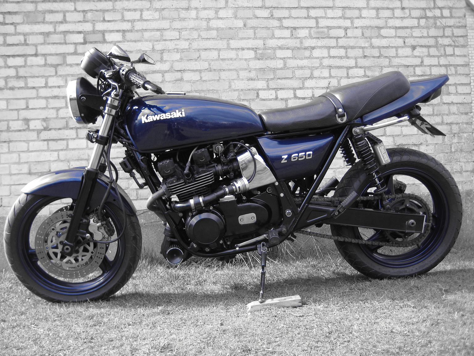

05 Mar 2011 22:50
forums.kz650.info/gallery/1378_12_05_09_3_13_00.JPG
this is what i want it to look like.

Nice find. I also just picked up an 82 CSR. I plan to BoB mine like this
It should be an easy transformation. Just a little cutting and welding on the frame, cut the seat pan down and reupholster and a set of flatter non-pullback bars. Reattach the backlight with some angle iron and make a plate holder. A set of mini led turnsignals and a neat little jumping spyder is born. Yours might be too nice to do this to. I also love a nice stocker too. Whatever you decide good luck.
