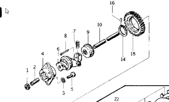

I would suspect the throw-out assembly (behind the left side cover) is the problem. It was on my 750 twin. If the cable is good and properly adjusted, that is the next likely cause.
This part:

Does it look like the one above or is it the ball and ramp style? It's called the EZ pull. It works great but if misadjusted you will hear a pop and no clutch. It has to be just right. Grease it well too.

It looks like the one above. Part number 6 in the diagram is metal and was slightly rusted. I did what I could to clean both part 4 and 6 with brake cleaner and a tooth brush and greased them up really well. When testing the action with just those two pieces out it felt as though it was catching right at the beginning of the twist

Describe the process you used to adjust the helix (part #2). And make sure you grease the crap out of 4 and 6 before assembly. Marine grease is a great option for parts like this.
You should be loosening up the lock nut, and then tightening #2 until you feel resistance, and then backing off about 1/8 turn or so before tightening down the lock nut. Before making this adjustment you should turn in the cable adjusters first of course.

The worm gear is hard to get right on mine. You start it at the farthest groove you can, then twist it in. It could also be clutch plates sticking if it won't fully disengage.

Swest, I bet that's it. I totally forgot about that part, I bet I was off on where I started that gear. I'm out of town for the weekend so I'll try changing the position on that to see if it helps.
