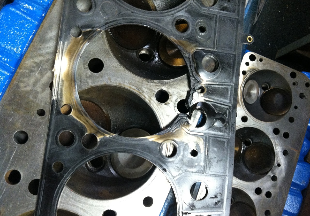

Then there is the one peice Cometic versus two piece factory gasket debate...
Cometic! 4 layer stainless steel gasket for the Hemi 354! Melted down after 1st 1/8 mile pass, actually burnished the stainless steel into the cast iron Hemi block. Did not O-ring the block.
$180 for cometic gaskets
Livin in "CheektaVegas, NY
Went thru 25 of these in 40 yrs.
I SOLD OUT! THE KAW BARN IS EMPTY.
More room for The Old Girl, Harley 75 FLH Electra Glide,
Old faithful! Points ign. Bendix Orig. carb.
Starts everytime!
