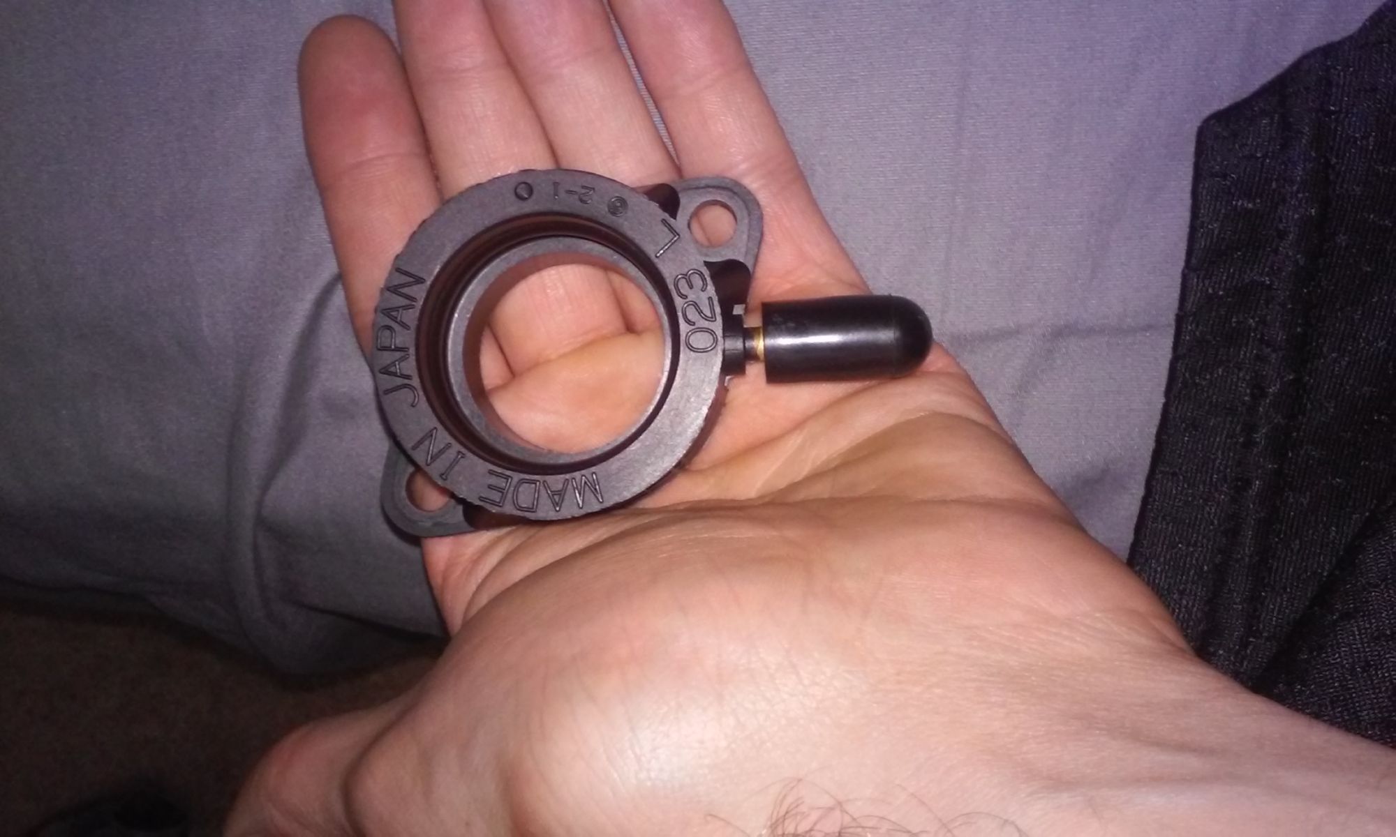

I mean these things

Those are carb holders, & if you have 26 mm carbs, many 1000s also had 26 mm carbs, but the spacing of the bolt holes are different, you can only use ones from a KZ 650 or a KZ 750, I believe

Well when putting the kz1000s to the ones on the bike they look pretty similar as if they might fit

pete greek1 wrote: T:hose are carb holders, & if you have 26 mm carbs, many 1000s also had 26 mm carbs, but the spacing of the bolt holes are different, you can only use ones from a KZ 650 or a KZ 750, I believe
Pete
www.z1enterprises.com/ItemDetails.aspx?i...50&item=16065-1132X4
The ones in the link don't have the fitting for the vacuum hoses do I need that on the manifolds?
Pete
First of all QUIT calling them manifolds, you're making me laugh, :laugh: :laugh: ,Do your old ones have them? I don't think so, but I'll let one of the 650 guru's chime in
