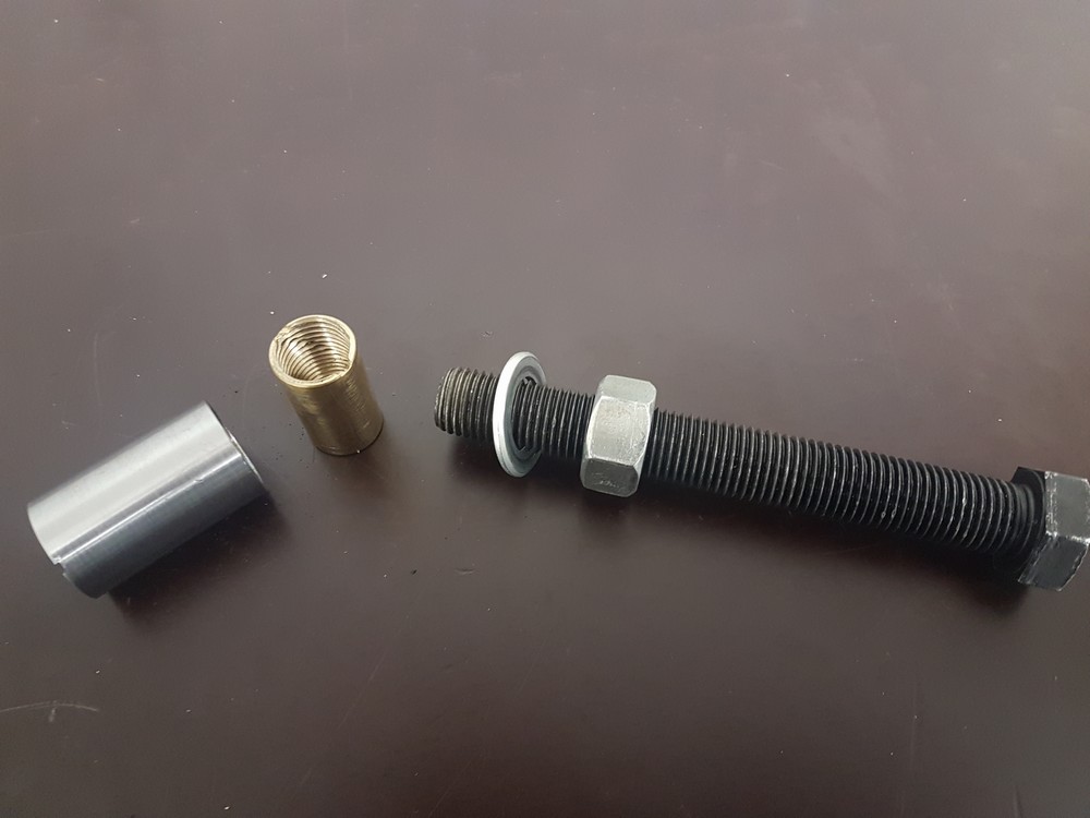

Replied by SpecialGreen on topic pulling swingarm sleeve & bushings from 77 kz400-d4
28 Mar 2020 08:27 - 28 Mar 2020 08:58
I was going to pull them and measure first :huh: . My suspicion is that the brass bushings are probably worn, but maybe not the steel sleeves. These are getting really hard to find. I don't see any z1 or allBalls kits either
I think I could just press the whole thing out from one end, if I can find a something like a socket to use as a bearing press. But it needs to be narrow enough to fit inside the brass bushing, yet have a big enough hole in the middle for a strong bolt.
