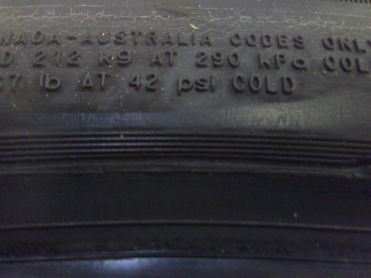

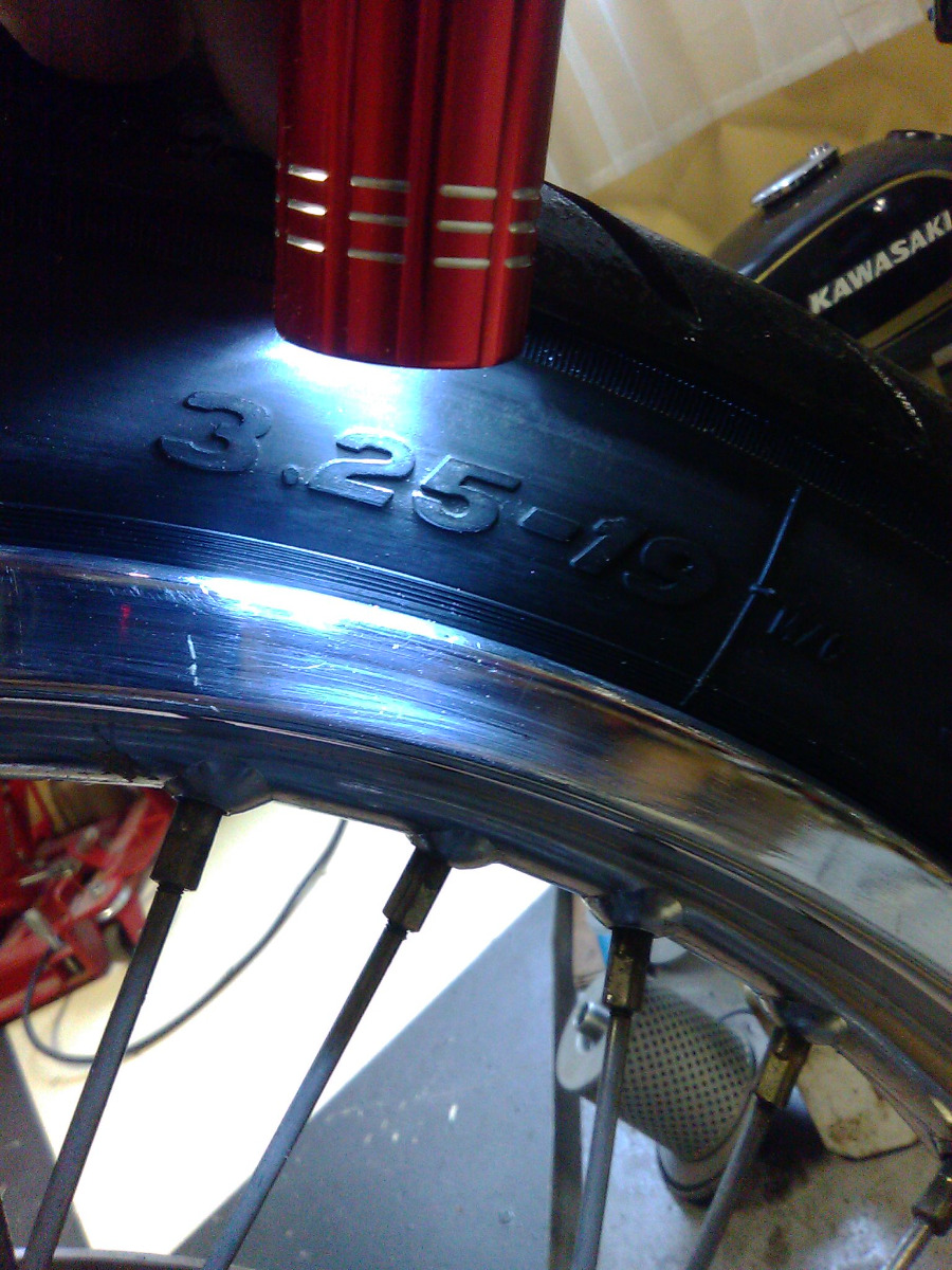

These are the lines I mentioned, they should run parallel to the rim and not fluctuate
Also look for waves in the side walls and weird deformations on the tread
