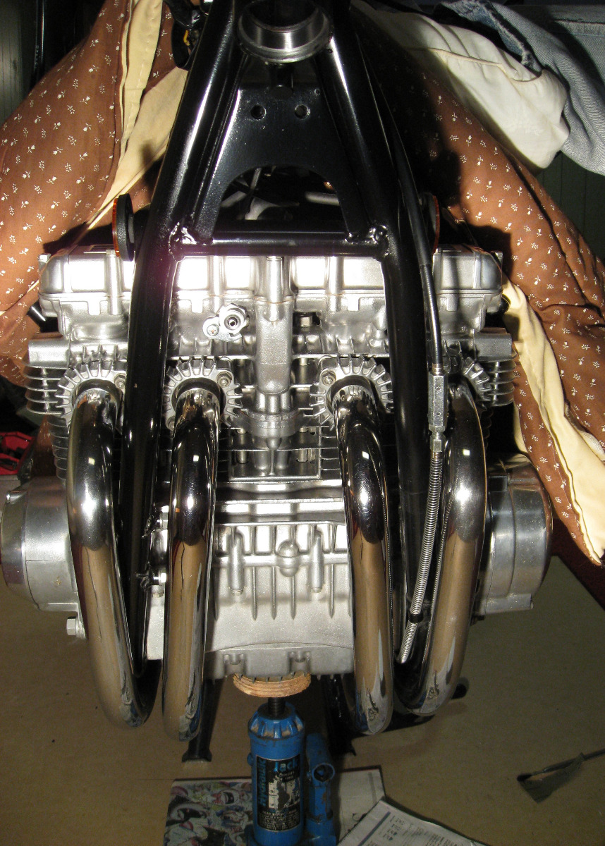

Thanks everyone. I now have a good baseline to begin the diagnosis. Anybody have any solid tips to raise the front wheel ?? I have the center stand temp. mounted for service. And own a car scissor jack, 2 auto floor jacks and the craftsman motorcycle /atv jack.
This 78 kawasaki has the OE pipes 4-2. There is a little room underneath , but I don't want to bust the cooling fins or any mishaps.
Looking for some good advice. Thank you.
Also own 4. Jack stands. !!!
- Thanks: 2830
Re: Front wheel vibration
28 Mar 2020 09:16 - 28 Mar 2020 09:17
When I removed the front forks on my KZ650 I put the bike on the centerstand and used a bottle jack under the front of the engine with a small piece of 3/4" plywood between the jack and engine to protect the fins. (see image below). The jack needed to be near the front of the engine so the front of the bike would go up and the back of the bike down. Ed
