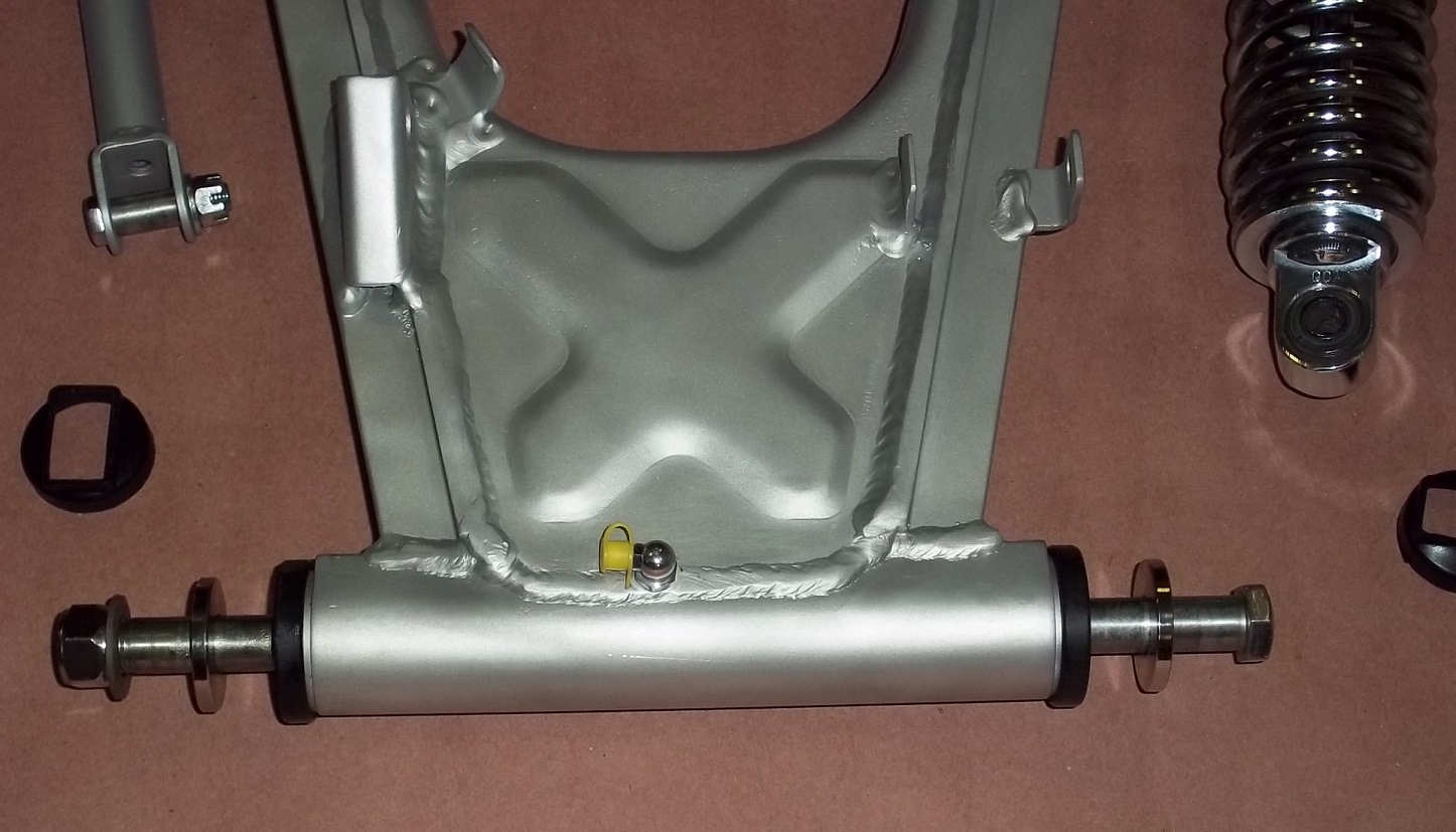

Replied by z1kzonly on topic GS1000 swingarm fits kz900/kz1000
04 Apr 2020 14:17
Notice the Zerk fitting I put in! Might hold a 1/2 tube of 6oz. grease! But it will never seize or wear out!.
04 Apr 2020 14:12 - 04 Apr 2020 14:14
I never realized that there was a steel swingarm?? I love the Aluminum ones! I have restored at least 5 in the past 10-12 years.
And yes, you will need a spacer of around .160" - .180".
I just seen this one on ebay? Are you the seller? Or did you buy It??
Here is an old picture of one of my restorations.
