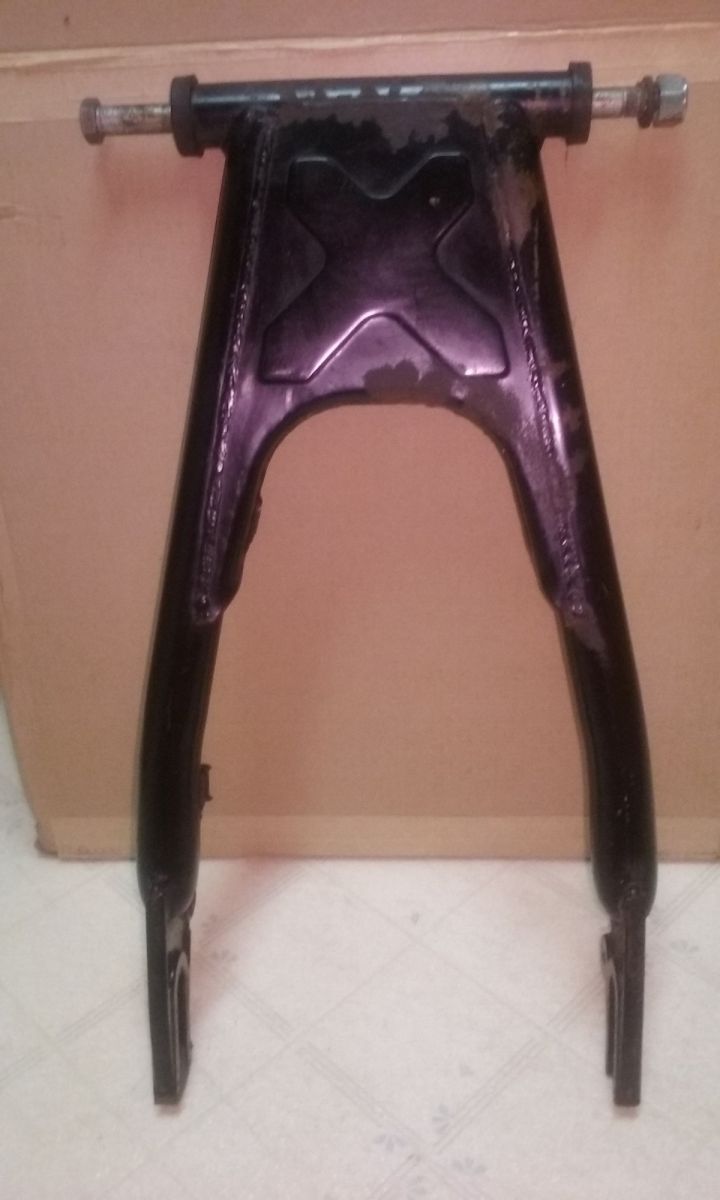

GS 1000 swingarm for your kz the Suzuki arm is both longer and wider than stock 900's nd 1000's. Good condition $50.00 + shipping from 16602

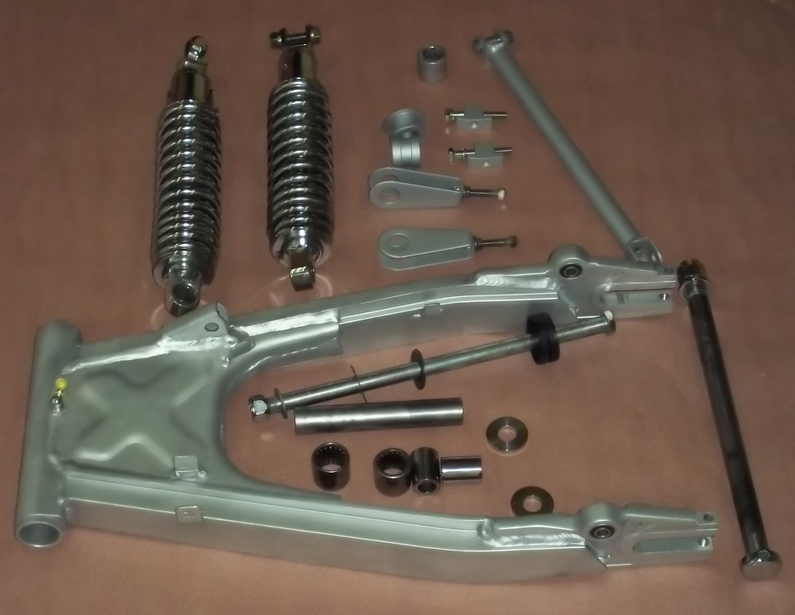

I never realized that there was a steel swingarm?? I love the Aluminum ones! I have restored at least 5 in the past 10-12 years.

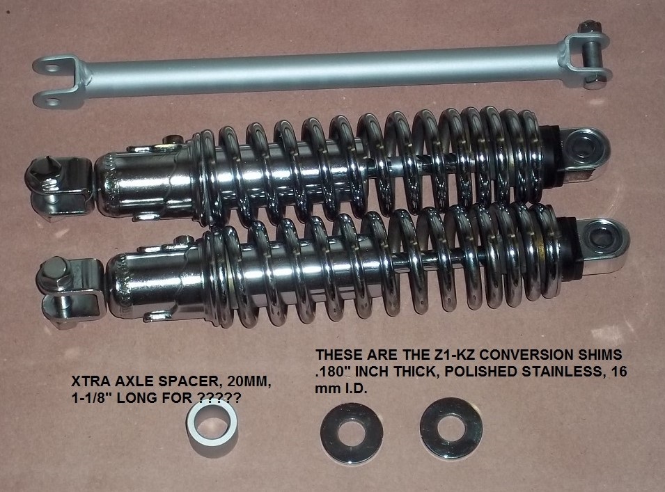

And yes, you will need a spacer of around .160" - .180".
I just seen this one on ebay? Are you the seller? Or did you buy It??

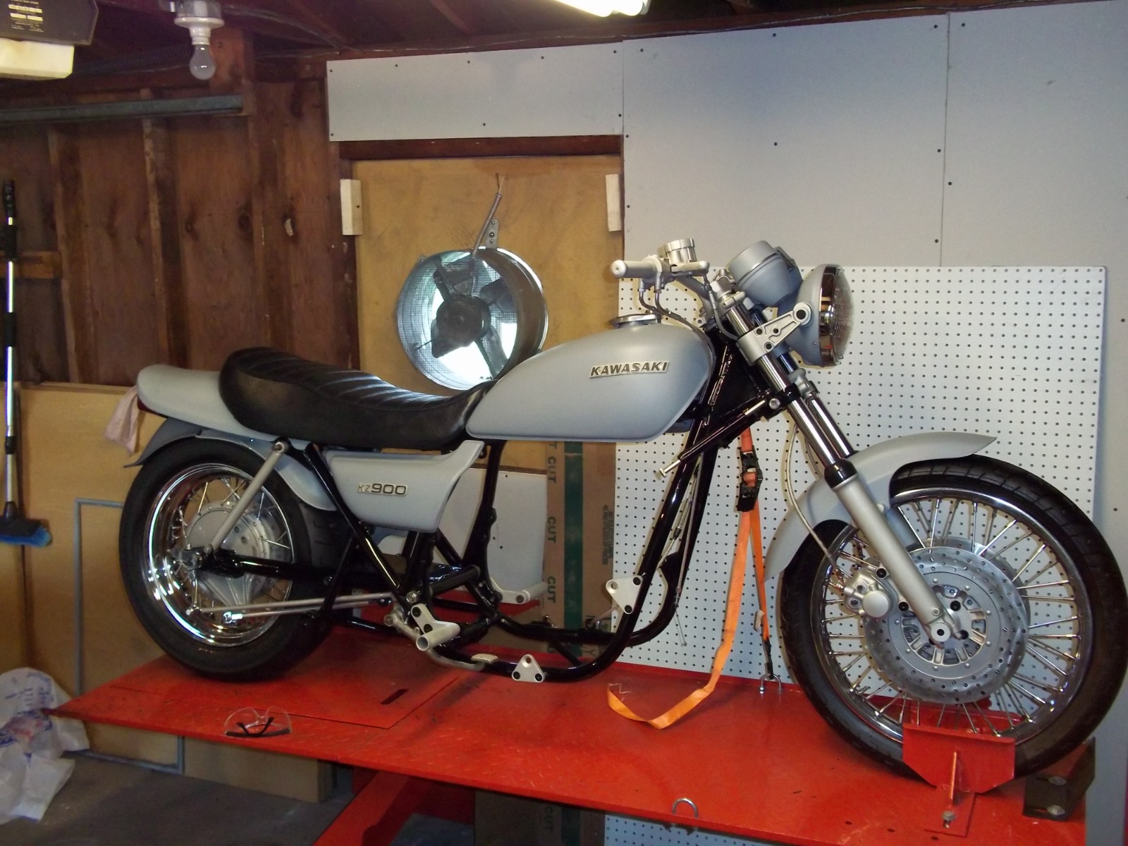

Here is an old picture of one of my restorations.

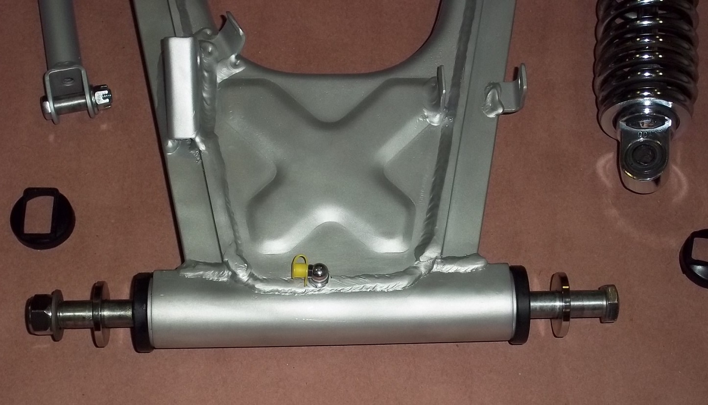

Notice the Zerk fitting I put in! Might hold a 1/2 tube of 6oz. grease! But it will never seize or wear out!.

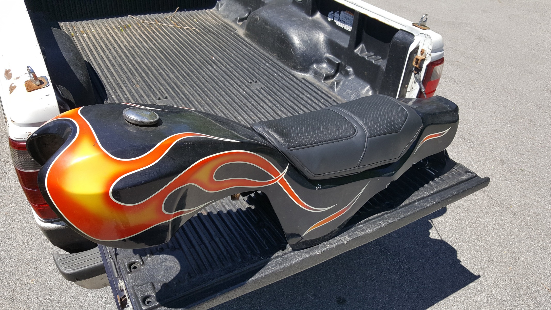

I have one that I am just putting on a Resto custom with a Tracy body hey let me send you a pic I appreciate your help brother thank you I have odds and ends of kz900 / 1000 Parts if you need any let me know I might be able to help

06 Apr 2020 14:00Cool looking, period correct paint. You should be careful and shoot some nice urethane clear coat on it.

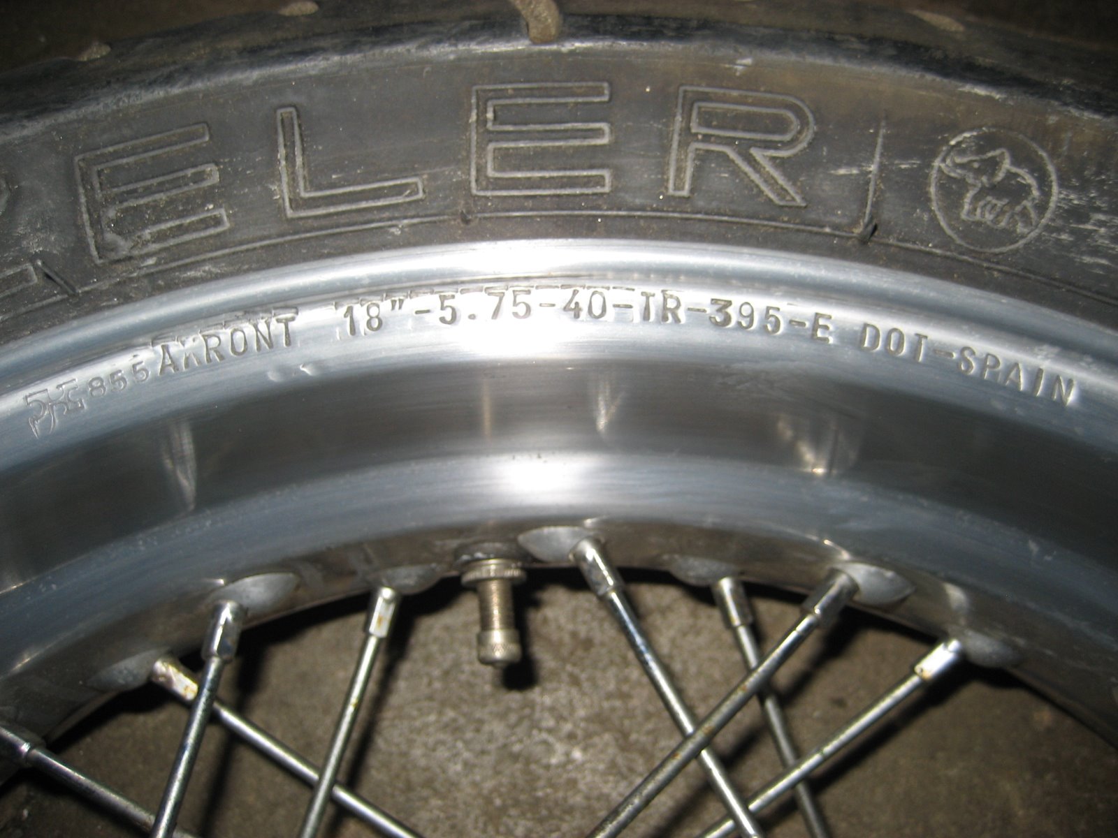

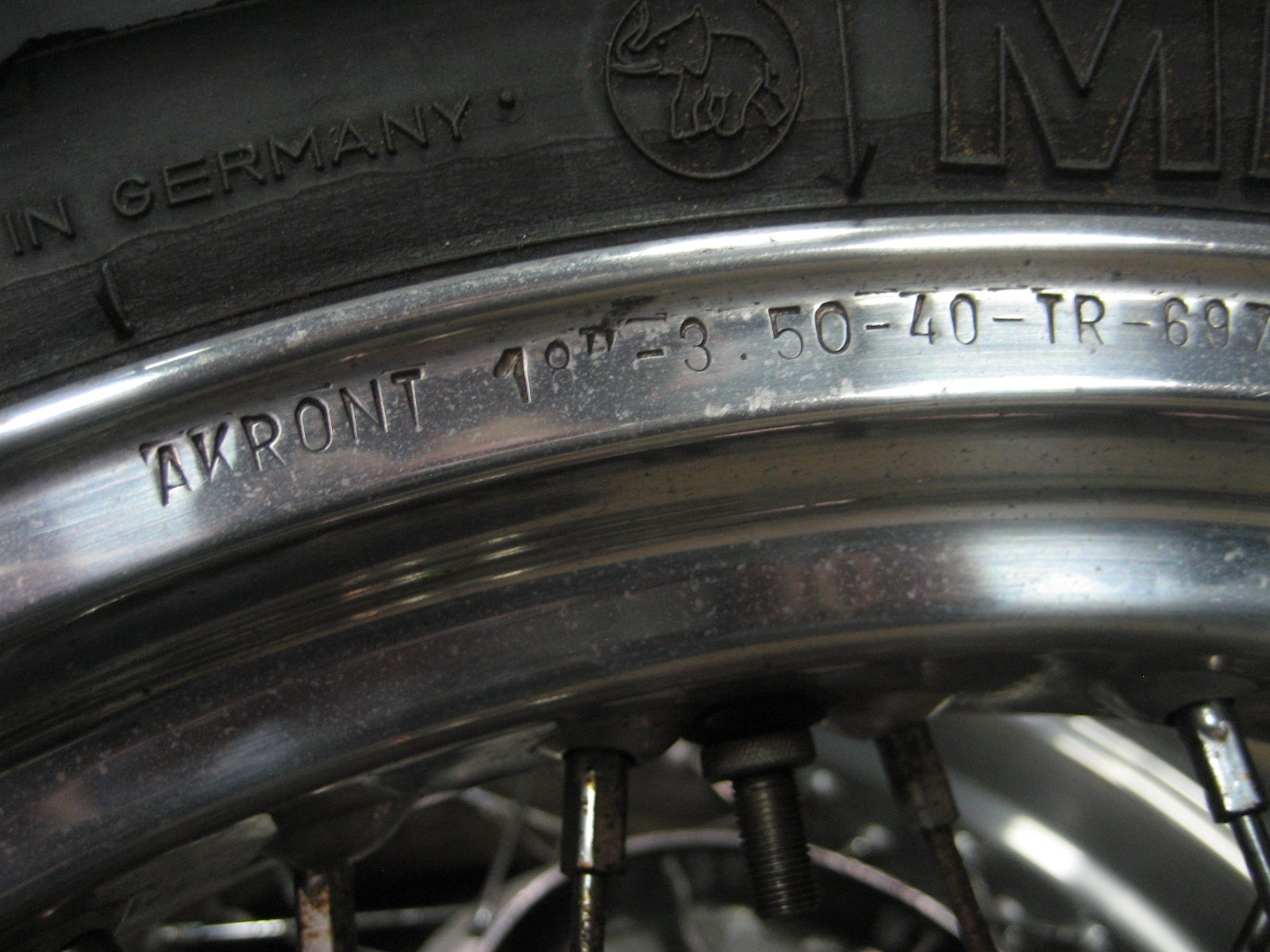

I am looking for a front Z1-H2, 6 bolt hole disc brake rim? Or an 18" aluminum Akront, Sun, Excel rim.
- Thanks: 2260
Re: GS1000 swingarm fits kz900/kz1000
Make me an offer for both wheels

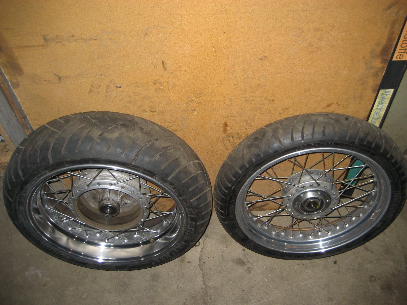

Those are BEAUTIFUL Scirocco! I would have to re-mortgage my house $$$ to buy them & ship from Germany!!!
Those wheels are on my Fantasy Dream Motorcycle! The 2 tires would be drag slicks!
