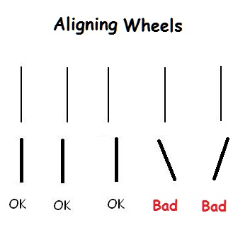

14 Sep 2012 13:13baldy110 wrote: Center the swingarm in the frame then center the tire in the swingarm.
or offset the swingarm.
Replied by baldy110 on topic GSXR Swingarm, How do I know my tire is centered??
14 Sep 2012 12:43
Replied by 531blackbanshee on topic GSXR Swingarm, How do I know my tire is centered??
14 Sep 2012 11:42 - 14 Sep 2012 11:43
use string/straightedge/laser to make sure it is centered up with the front tire.
a little offset won't be noticable,some factory bikes come offset 3/4's of an inch or more.
GSXR Swingarm, How do I know my tire is centered?? was created by mike0537
14 Sep 2012 00:56 - 14 Sep 2012 00:58
Putting a 97 GSXR 750 front and rear on my 750. How do I know that my rear tire is centered side to side? Do I just center the swingarm inside my frame (actually fits pretty snug) and assume the tire will be centered? Or is there more to it that than?
