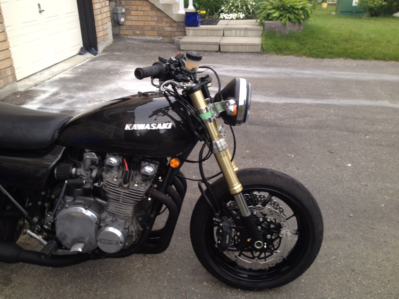

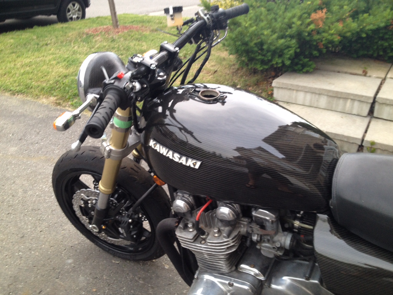

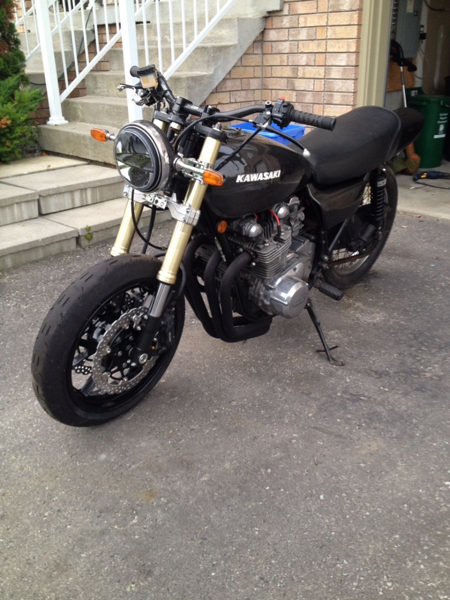

I think it's time for an update (its only been 2 years)
So the carbon fiber work is now complete, the ZX14R front end has been fitted, a LED headlight has been installed, and I have swapped out a few bits and pieces around the bike.
Things to complete: Get a custom swingarm to accomidate the ZX14 rear wheel, figure out what i'm going to do about the seat, upgrade the engine.
