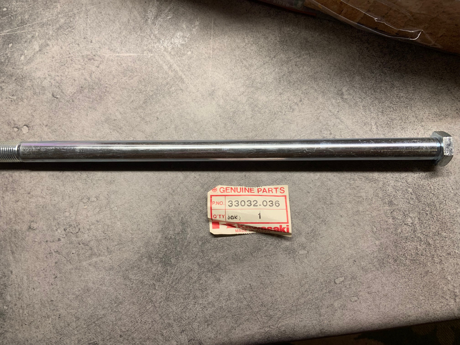

Replied by Jonas_Z1000j on topic Swing arm radial play, shaft diameter KZ1000
24 Nov 2022 11:17
Well I took Wookie advice and bought the new one, and im happy I did. It measures around 15,92 - 15,95. I installed it right away with new grease on the bearings (just 3-4 years old). What a difference! completely snug now, swingarm feels so good I want to take it to the track
but... unfortunately its snowing and will do so for at least 4 months
But this is wierd, the old one measured between the sleeves:
It looks identical, same head etc.
16 Nov 2022 12:05
Thanks, I will pull it tomorrow and take more measurements!
Is there a source for new ones, either NOS or replacements?
The bearings where basically stuck when I bought the bike, maybe that caused the severe wear.
Swing arm radial play, shaft diameter KZ1000 was created by Jonas_Z1000j
16 Nov 2022 10:59
Hi!
I have just started to assemble my KZ1000j -82 after work on the engine and a powder coat of the frame. A couple of years back, I changed the swing arm bearings and sleeves. I noticed now when I put the swing back on that it has a considerable radial play between the shaft and the sleeve. I pulled out the shaft just a bit and took a couple of measurements all between 14,3-14,5 mm. I google now that it should be 16 mm!? I read in the service manual that the service limit of the shaft is 0,7 mm.
Is 16,0 mm the correct shaft diameter?
thanks,
thanks,

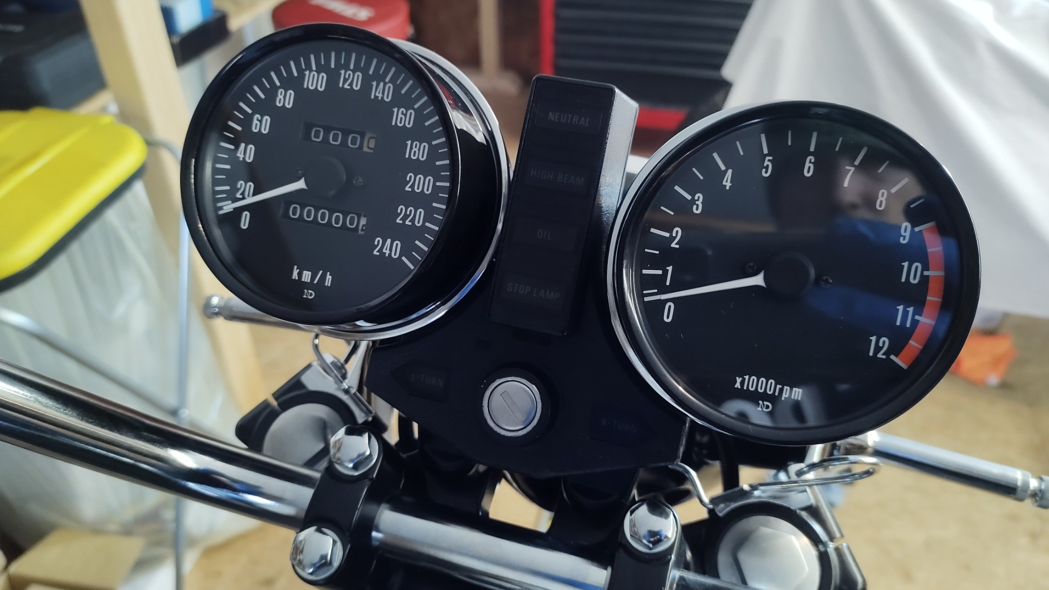

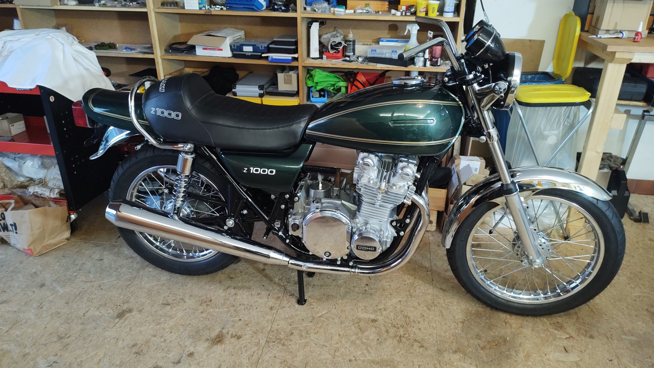

Pretty much finished the electrics on the restomod - need to get the welder out before I can get the last couple of things done. In the meantime I decided a change of focus would be good.
I got the clocks back from being serviced. Look pretty good and the damping fluid and bearings have been renewed so the needles should be pretty stable. I repaired one of the M6 threads in the block so I could bolt the head down. Got that done and got the exhaust on as well. Need new camshaft bearings so will have to wait a bit before I get the engine finished. In the meantime I guess I'll start on the wiring - it's not like that's all I've been doing for the last month...

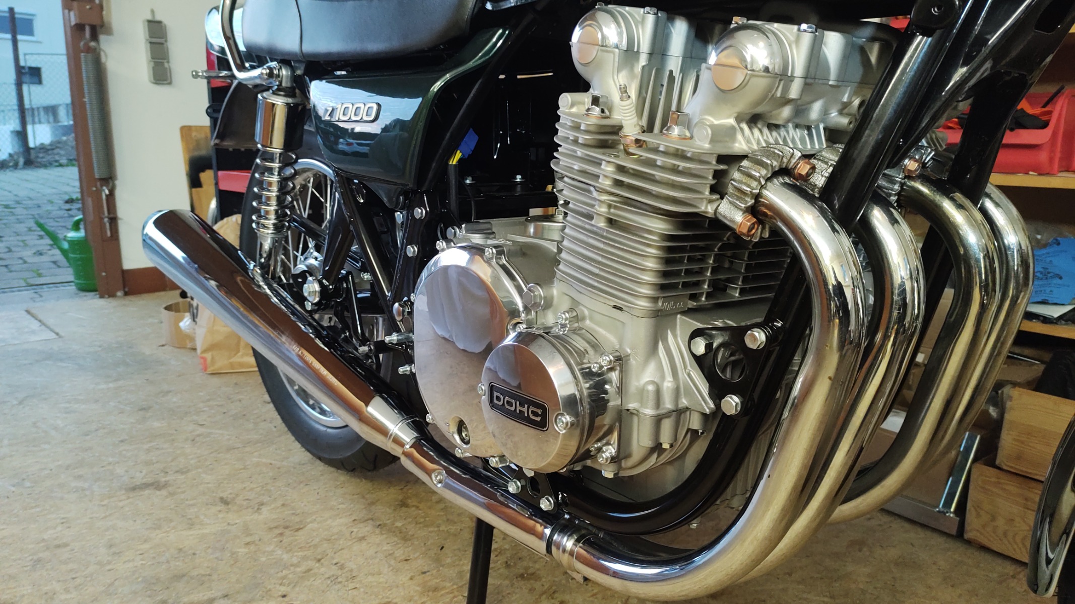

The exhaust is too close to the swingarm on the left side. I figure the hanger on the frame is probably bent (given the state of the frame when I got it). It's not too bad though, so I'll just bend the bracket for the left muffler just enough so the axle bolt clears the muffler.
