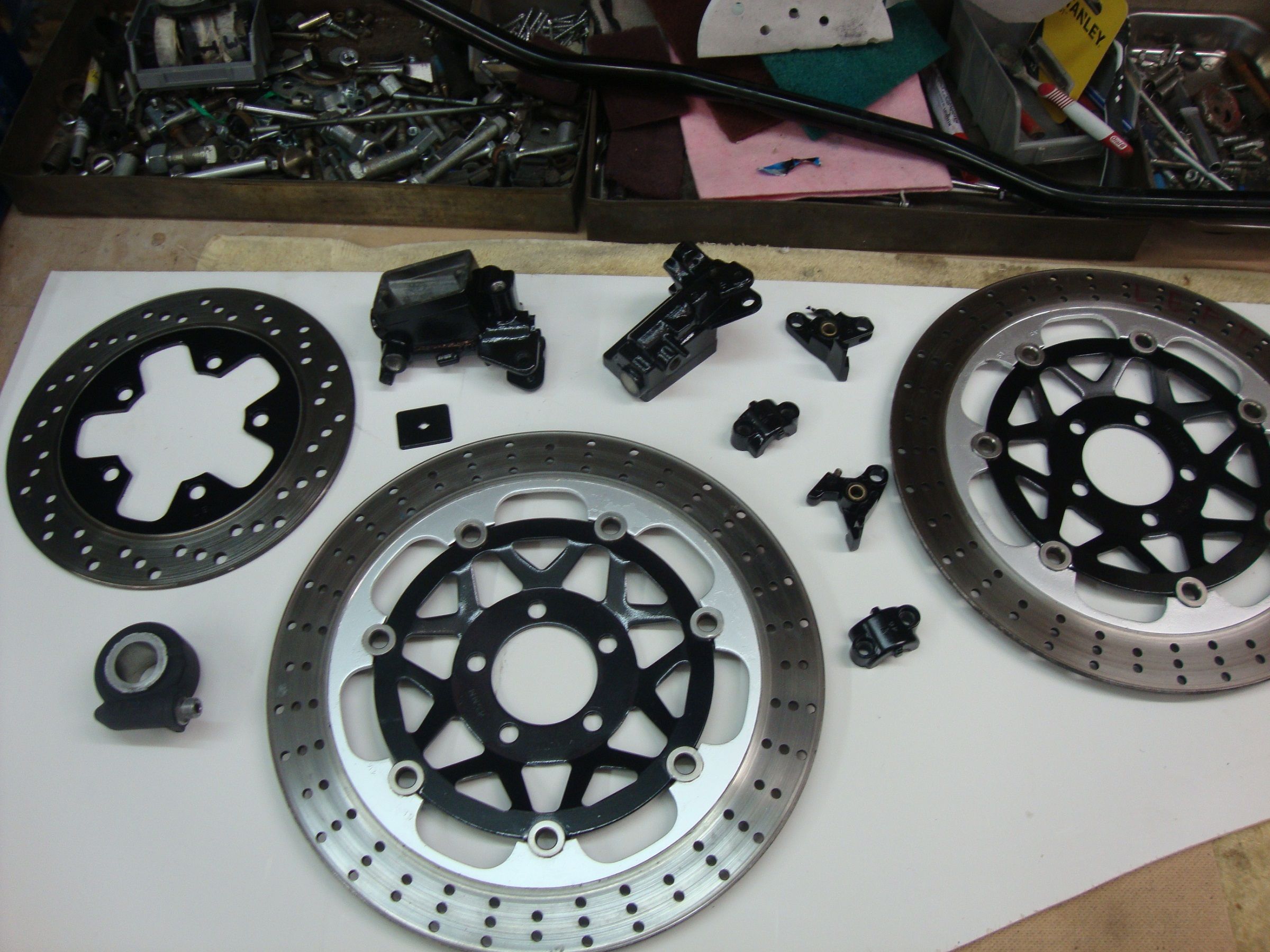

A bit more painting today,just some odds and sods. I unmasked the disks and other stuff I did last week.
The black on the disks came out pretty good,a bit thick but it hardened up well.The silver though,Im not sure about.When I wipe my finger over it,I pick up traces of the paint! Not good. It is dry and I checked the label for info and theres nothing about curing with heat.So, I dont know whats going on there. Im not going to do anymore with it as It was a real pig to mask off. Ill just have to refrain from wiping my fingers over it!!
I did a few other ( not silver) bits today.Ill check on them tomorrow.

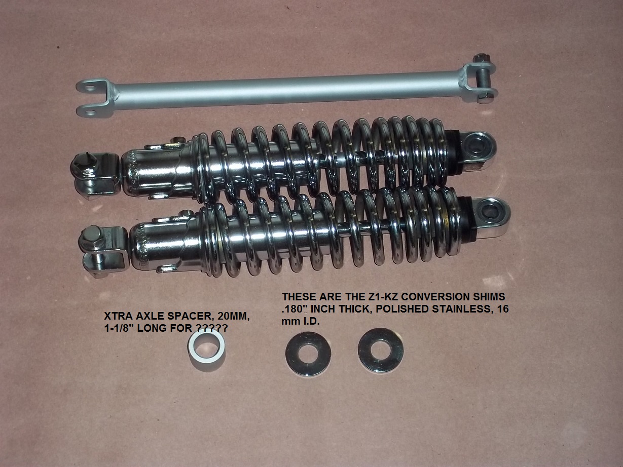

Welcome new Guy! That is the Suzuki GS 1100 early 80's 81 - 82.That is an easy, good upgrade to the Z1-KZ.
You need to shim it at the pivot at frame about .160" on each side. And find some GS 1100 shocks on ebay.
I like them, I have sold 4 or 5 after I clean them up over the years on ebay.
Here is a nice picture of the last one I did.
These are the shocks you can use. From GS1100 Suzuki
You will get a lot of info here. once you search around.
