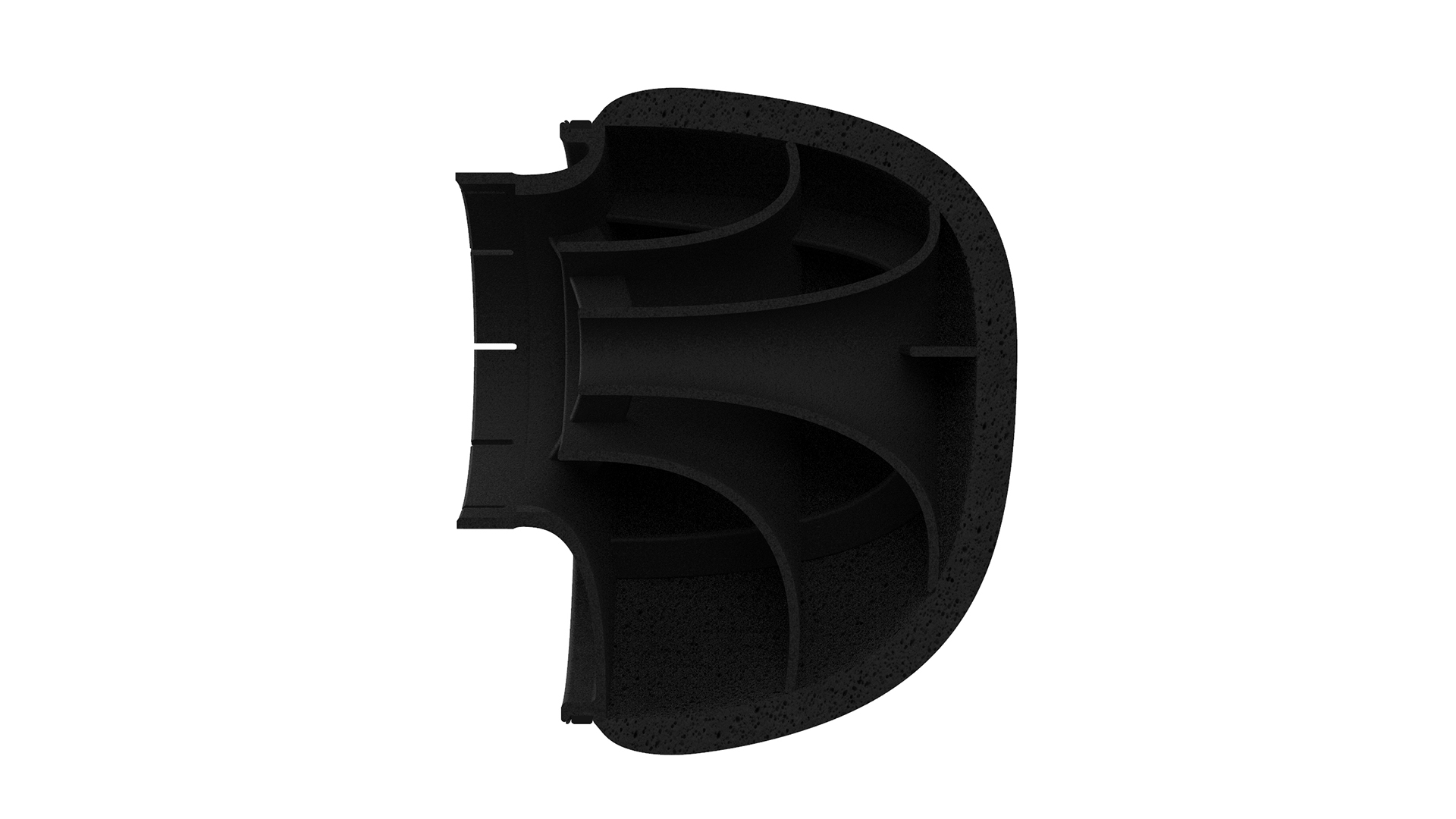

Funnily enough I am going to use A pod type set up on my 750R1 with BS34 CV's, the big difference is that the "pods I'm using have a triple velocity stack set up, most pods don't use velocity stacks. I will be using a stage 3 jet kit with these. I'm real lucky to have a friend who's extremely good at carb setups from his over 50 years of racing, in saying that, I'm still thinking about the possibility of adding side screens to stop sidewinds, If I have any trouble, By all reports I won't , just thinking ahead. Here's a look at the filters I have, If anyone is interested....
Cool design. Is there any info out there on how these perform compared to your basic K&N/APE gauze pod filters? I finally found that these are designed and manufactured by Messner Moto after searching for them online, still no contact info or where they're located.
        I have just started running a set of RPM dual pod foam(UNI??) filters on a ZRX that seem to perform a bit different than the gauze type pod filters. So far I like the performance and response compared to the APE filters on another ZRX with comparable tuning, will know more after more seat time.

Mirko Messner is the guy who makes, or has them made, you can contact him through his site, I have spoken to him a number of times, he;s also a member of the SOHC forum and has made some real nice parts for 750 Honda's, drop him a line here....  messnermoto.com/contact-us/
I haven't used mine yet, won't be long though an i expect them to work well based on their design, Mirko has been running these on his Honda for a couple of years now..
